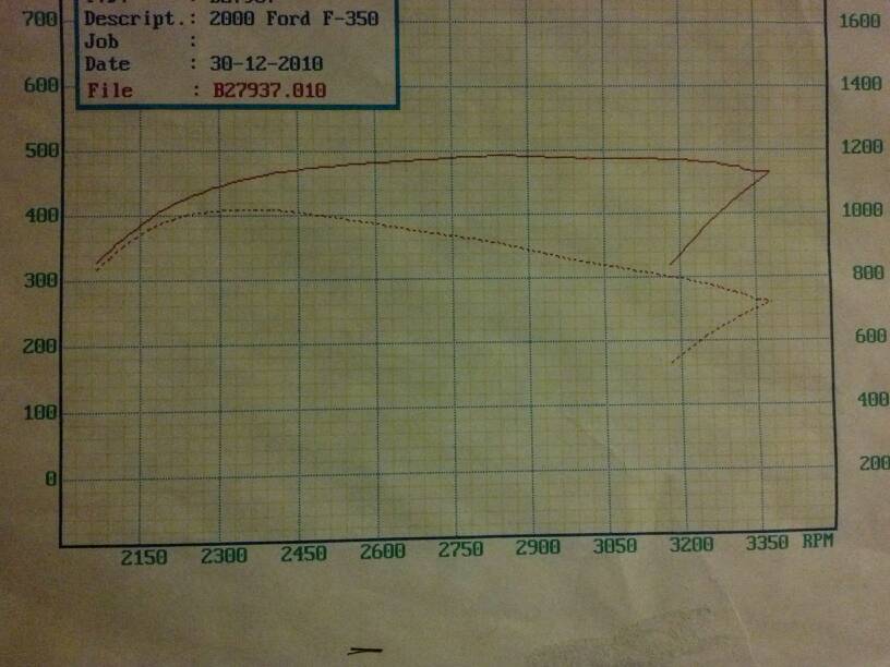

for those that need an image of the two together.... solid line is hp and dotted line is tq
live life full throttle
Thats a beautiful curve.... super flat...
