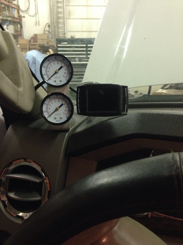

Got the gate all hooked up and did some runs. We were seeing 60 total and 40 out of the atmo. Kept turning it up till we were at 80 total and only 30 was out of the atmo. Didn't feel comfortable at 50psi out of that s360 so I dialed it back to 70 total and 40 atmo which seems very healthy. Can't tell back pressure because it is pas 72 where the factory sensor quits.
It also got some custom tunes from Matt. And boy is this this easy to drive! No smoke even on the 2.3ms tune driving normal. And wot once the converter locks there is barely a whisp of smoke with 100% at 2.3 ms. It feels very powerful.
Going to the dyno either Monday or Tuesday.
Here is fancy custom gauges lol
