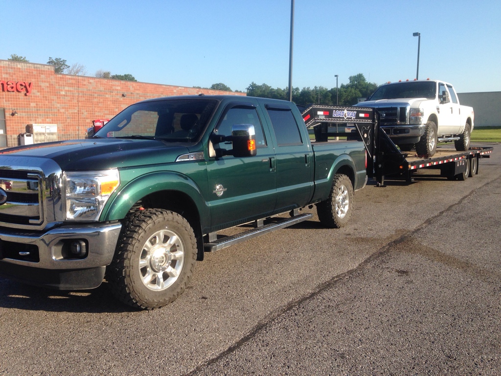

Here we go!

Well the dyno started off good. Made 660/1121 on the stock pw tune.... Then we have some issues to work out. We were 20psi low from what we are seeing on the street with the big tune. Only made 710 and smoked terrible. Guessing we have a boost leak or trans is slipping. Didn't have time to work on it so we will do some more in the near future. It will hit the rollers again next month and again in september. Hopefully have it dialed in by then. But 660/1121 on the stock pw tune makes me giggle. Lots more to come.
