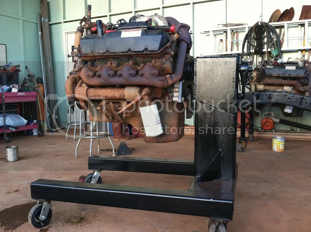

juniort444e you could buy one or build an engine stand like I did if you got the time. All materials was scrap that I had.
I'd like to see more pics of that especailly the head where it rotates. I've thought of doing the same thing. It's become more of a priority now that I have a long block sitting in the back of my truck lol.

i definitely like the use of the slack adjuster to rotate the thing haha it does work quite well... thats how my stand spun for the mack carriers i would rebuild at my old job
