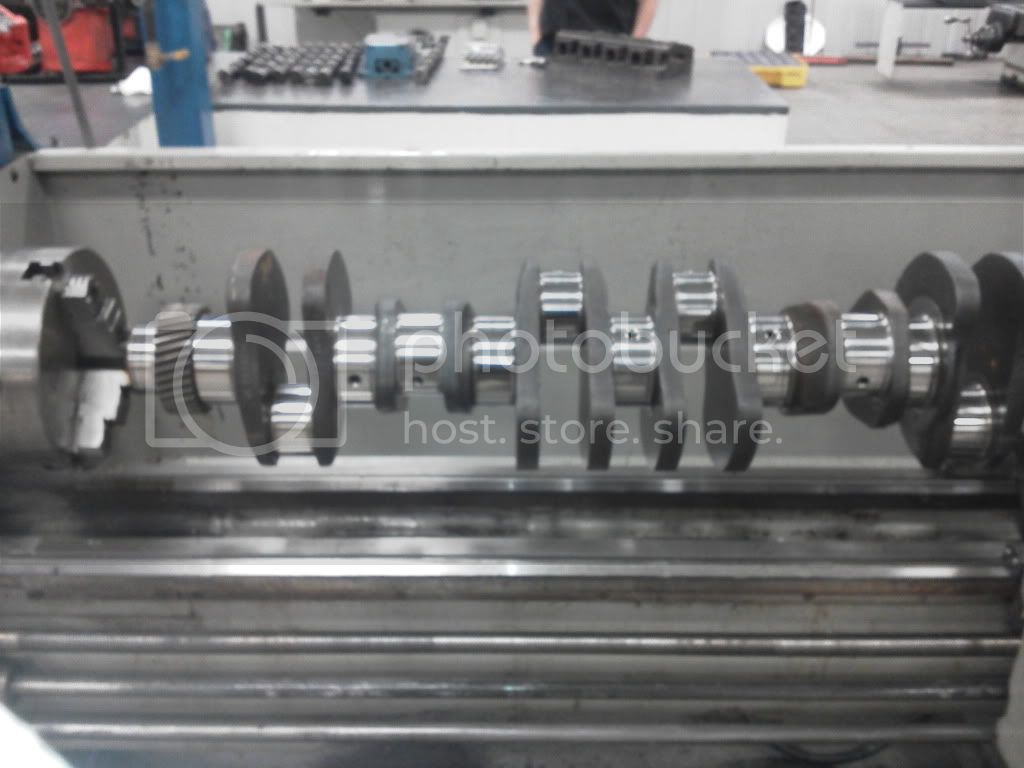

Little more progress today
I checked all the main bores today and they were all right in spec so no align honing needed. I checked the cylinder bores as well, it looks .020 may clean them up but I ran out of time to start honing today.

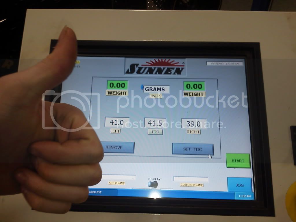

I also got the crank all polished up and then threw it on the balancer and got it perfectly balanced. I also weighed all the rods and got them balanced as well.
After polishing
Crank all balanced, dont mind my friends hand

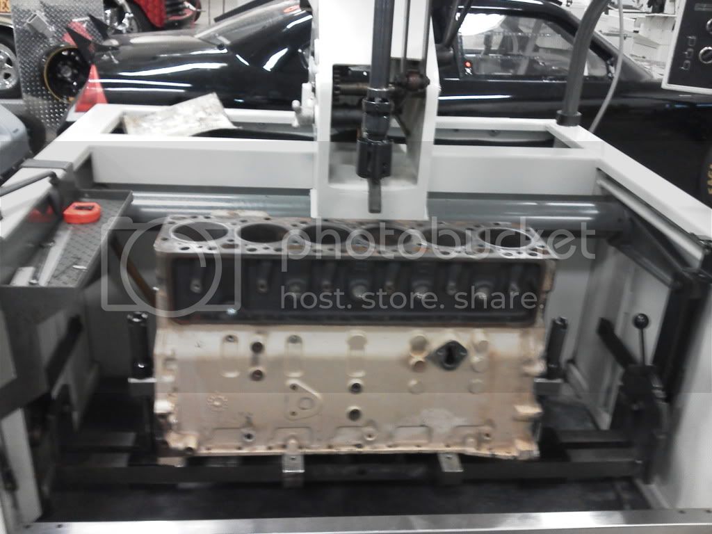

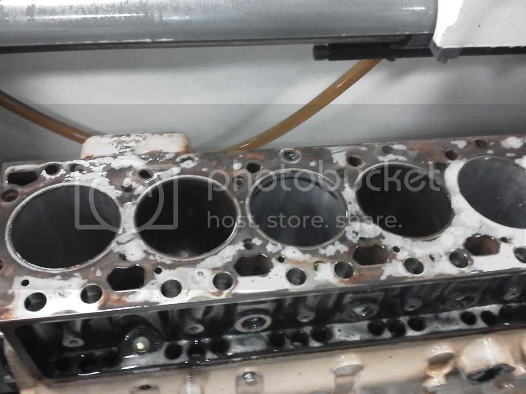

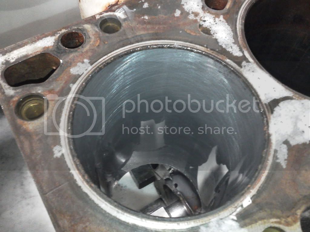

Thanks to the snow we had a delay this morning so I only got to work about two hours today, but I got started on the honing. Its definitely going .040 over.

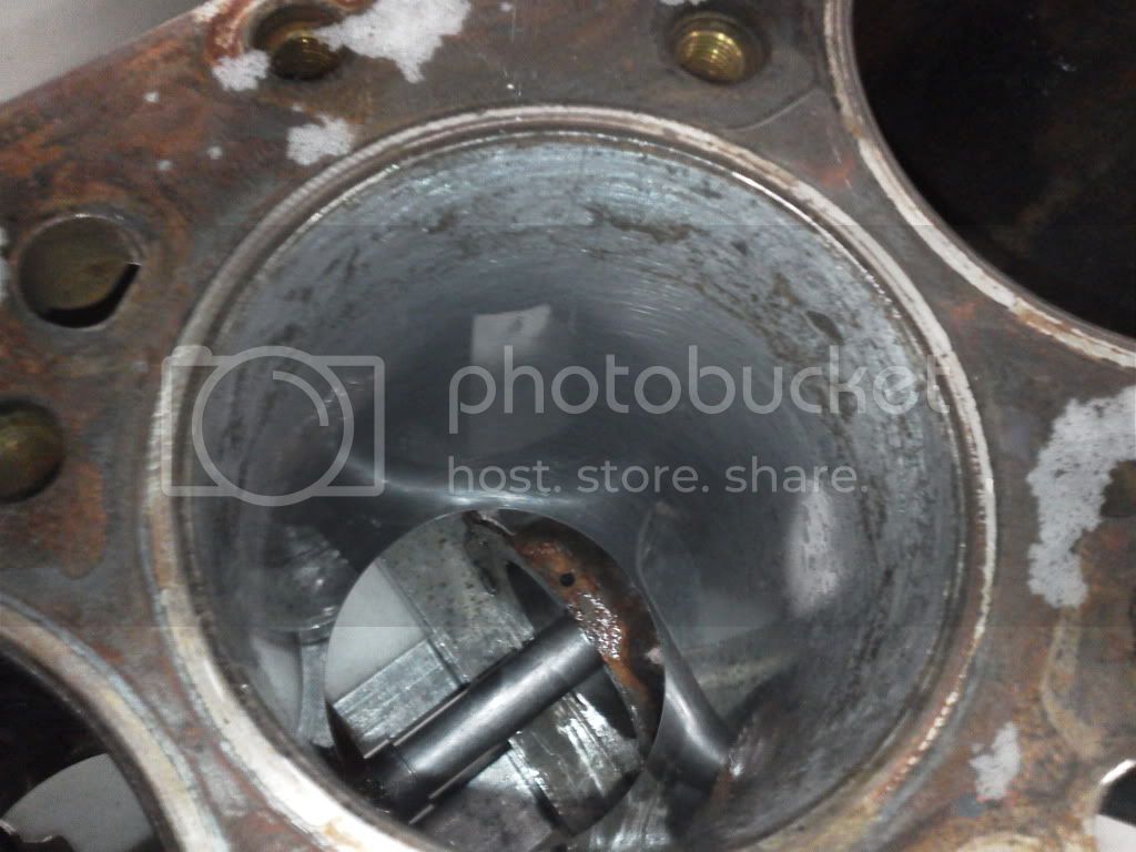

The cylinder that we had to press the piston out of after going .008 over

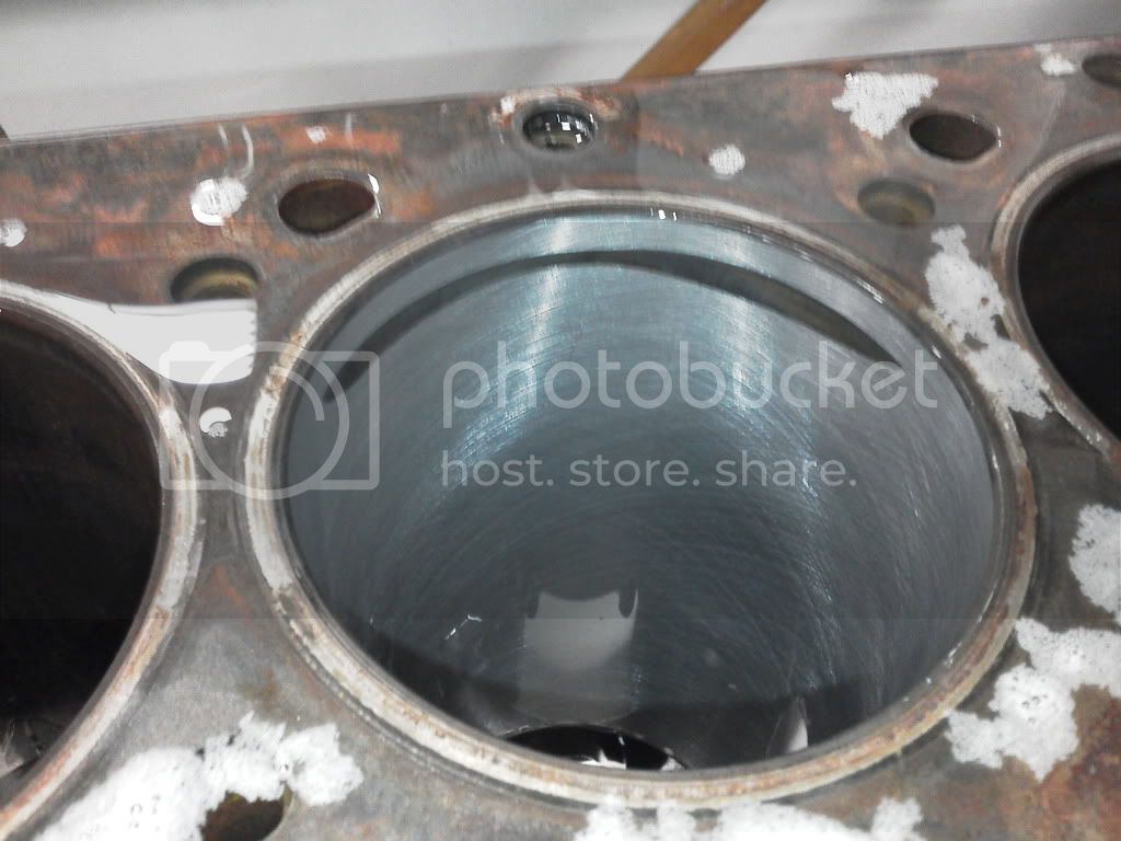

After going .020 over

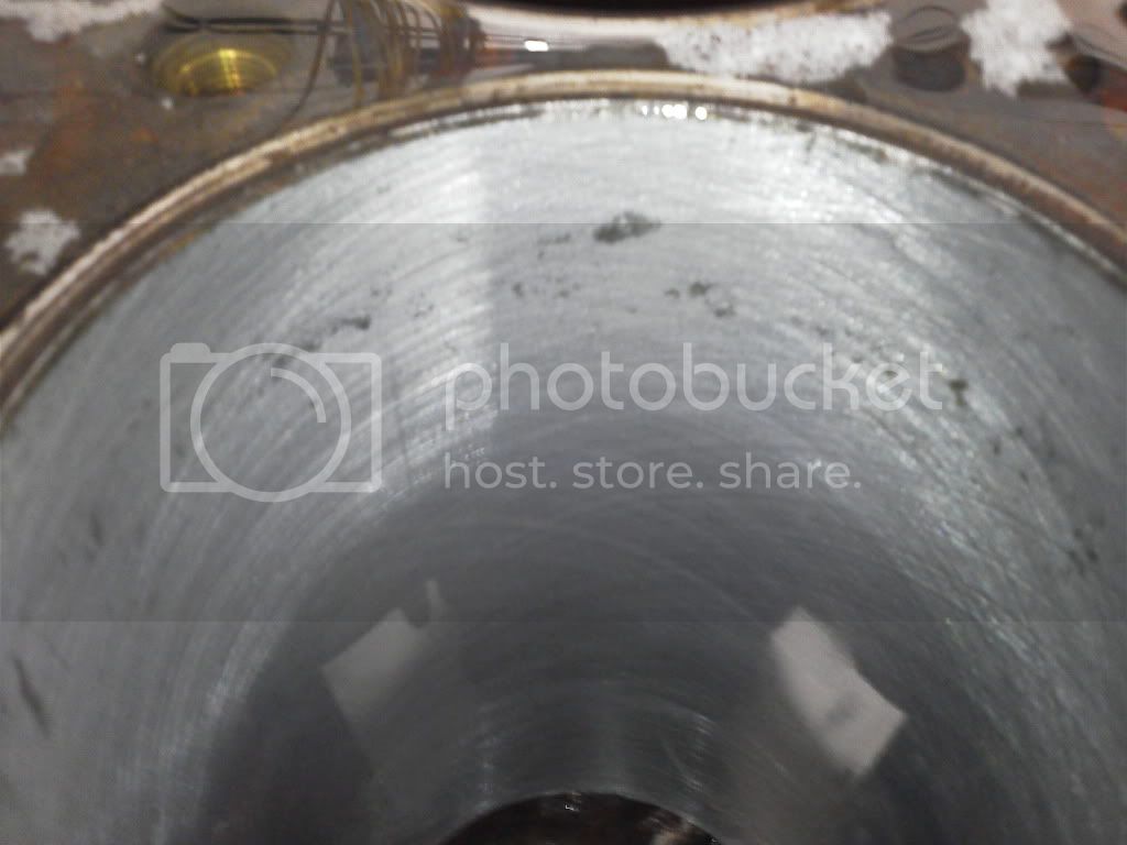

Cylinder 1 that had the other rusted piston in it after going .020
This one was unexpected. Nice big ridge in cylinder 3 still there after .020 over. Cylinder 6 cleaned up fine with .020 and still need to do 2 and 4
