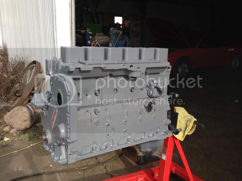

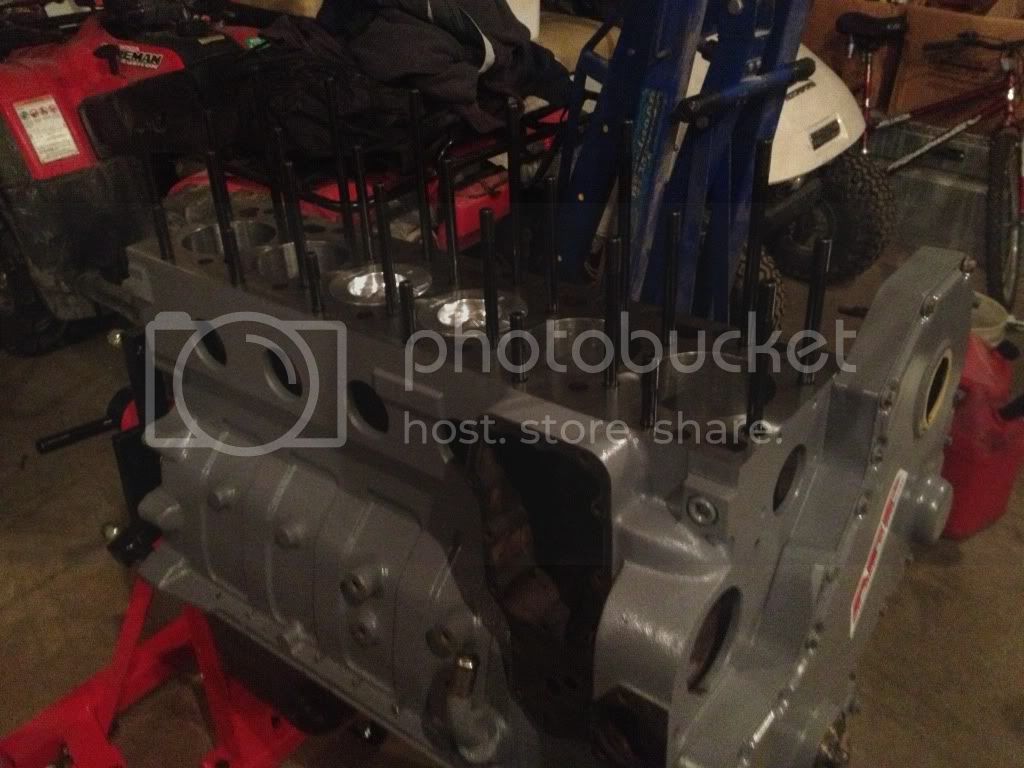

since it was a nice 60 degree day outside today I decided to work on the engine a little more, I still have to put the cam and tappets and a couple other parts on but here is where its at now.

Lookin' like an engine again. Gonna be real nice once it's running in the truck.
Thanks! yeah its finally looking like an engine that actually turns over now LOL I still have to get a p pump for it. Id like to get an already benched and flowed 913 pump to put in my 03 and throw the 190hp industrial pump off that truck on this engine. Then I have to reseal the powersterring/vacuum pump and helicoil the oil feed for the vaccum pump and throw that on. Get some injectors, probably 5x14s and get a new thrust plate for the cam and throw that in and the engine should be good to go. Im looking forward to getting it in the truck.

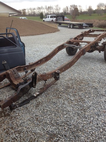

Time to get rolling on this again, I picked up a 96 F-250 regular cab frame this past weekend. Truck was a 7.3 truck. I got the axles, driveshafts, tcase, ZF-5, fuel tanks, master cylinder, wiring and all that.
For what I got it all for this will be much more cost effective and quicker than finishing the 150 frame.
Plans are to strip the frame bare and clean and POR-15. Only put the saddle tank back in, run all new brake lines and clean up wiring. 5" rear blocks and 3.5" reverse shackle kit in the front.
Dana 60 swap
Valair single disk clutch
Destroked engine mounts and adapter plate will be on the way soon.
Energy suspension body bushings
All new leaf spring bushings
All new u joints for driveshafts
Drop the engine in
Run one of fuel labs new fuel systems with a beans sump
Then drop the cab and bed on and go from there.
Hopefully this thing should be done somewhat soon!

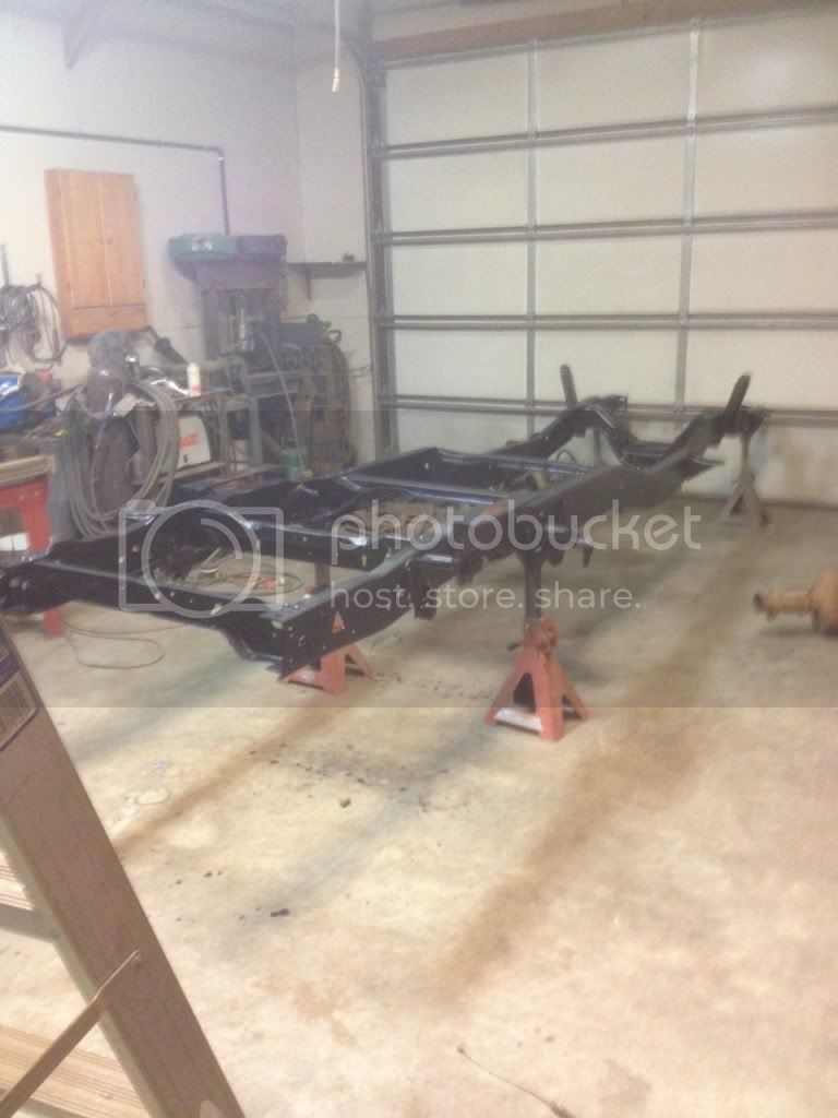

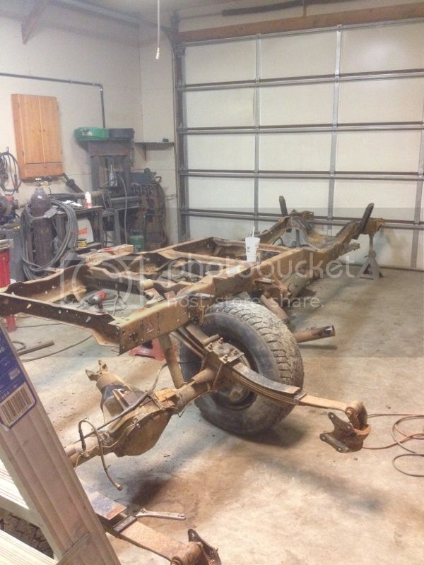

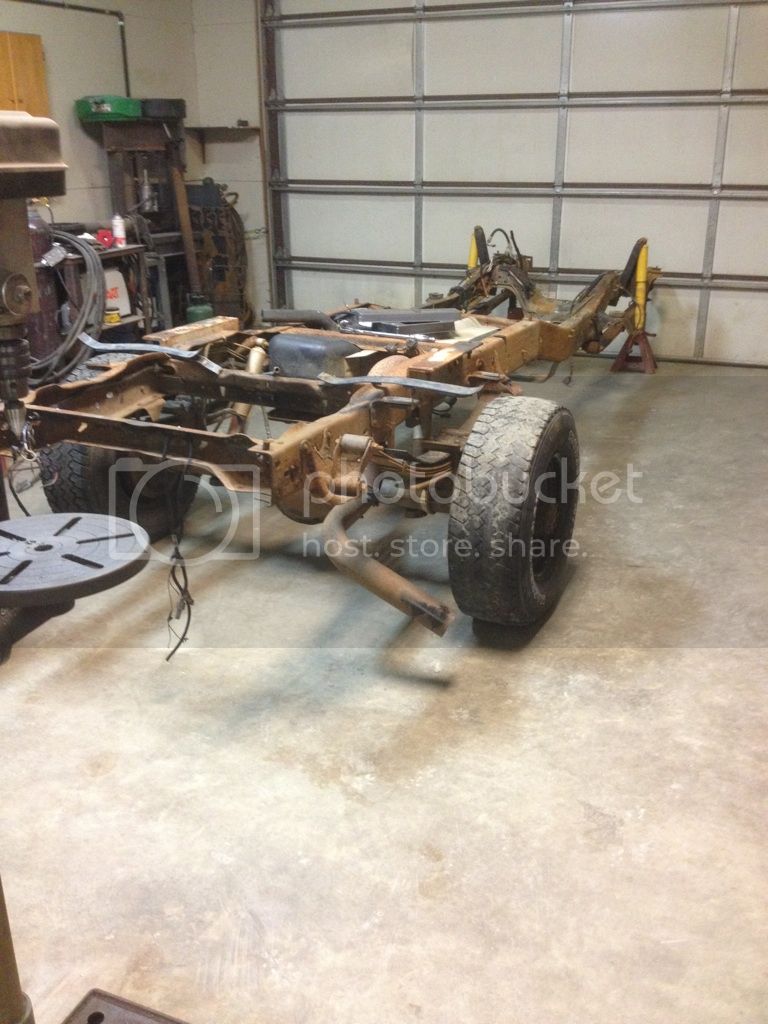

Its been a long time but Im finally back to working on this full on starting yesterday, and if I can keep a good pace it should hopefully be rolling by spring. I got the 250 frame in its new home in my buddies body shop where Ill be building it all winter. The truck will be getting a whole new paint job now, Im pretty set on tuxedo black metallic for the color.
Got the 250 frame in its new spot:
Got the frame all stripped down last night:
Today got the frame cleaned up:

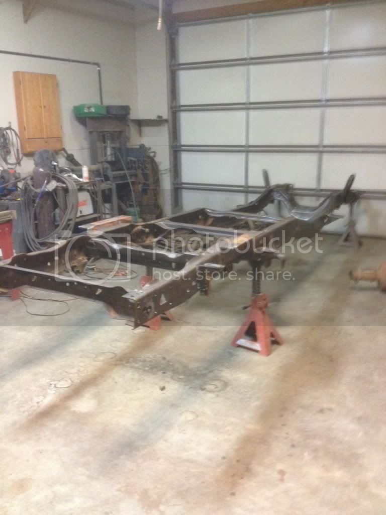

And the rust sealer applied to the whole frame:
Next week the frame will be getting a gloss black epoxy top coat. I should have my 350 frame from Jason (Hotrodtractor) then as well. The frame is bent some but Ill be using the axles out of it, and that along with the rest of the suspension and chassis parts will get the same rust treatment and paint. Also I will be installing a 3" reverse shackle kit up front. New rear shackles and 4" PMF traction blocks that I have.

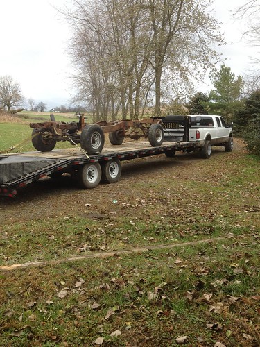

All new leaf spring bushings, trac bar bushings, rear shackles, center pins for leaf packs, stainless braided brake lines, fuel tank straps and front 3" reverse shackle kit w/ trac bar drop bracket are on the way. I have a set of 4" PMF traction blocks and adjustable top plates for the rear axle. Just need to get some new u bolts made and pull leaf packs apart when I get the 350 chassis next weekend and do a lot of cleaning and start assembling the new rolling chassis

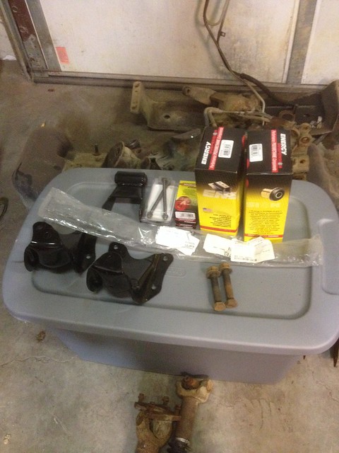

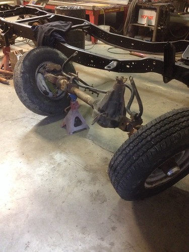

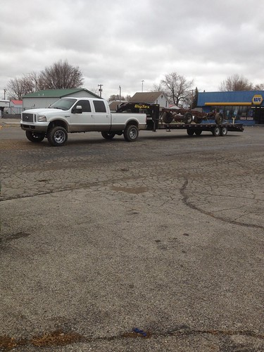

Little more of an update. My new leaf spring and trac bar bushings, rear spring hangers and shackles, center pins and fuel tank straps arrived, reverse shackle kit for the front will be here tuesday. Then I went down to Jason's (Hotrodtractor) place today and picked up the 350 chassis from him. By the time I got back I didnt get a whole lot done, but I got the dana 60 out and almost all the way tore down. It will need a new drag link, ball joints, rotors and drivers side caliper, nothing unexpected. Overall though its in excellent shape.
Hopefully I can get that tore apart and get the axles and springs cleaned up along with all the miscellaneous suspension parts and get it all painted this week and ready for reassembly.
