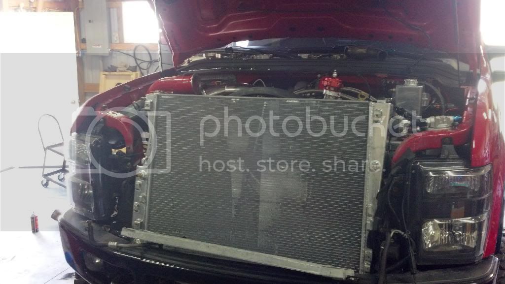

Not to many updates. All hot pipes are wrapped, all engine wiring is complete, hot pipes hopefully have no more leaks. Used a high temp coating on one side and a metal/graphite type gasket on one side. Moved hitch forward in the truck. Got suspension stops. Put new alradco radiator in. New degas tank is in. Moved hood shock over so the hood now closes without having to remove the shock. Also got a new tune from Eric. Didn't drive it hardly anymore as it was work work work.

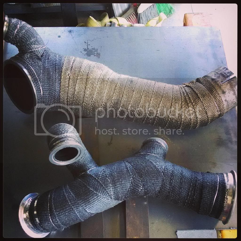

Only pics I took
Downpipes wrapped with black and titanium cause you can see the titanium through the wheel well. Thought it looked cool.
