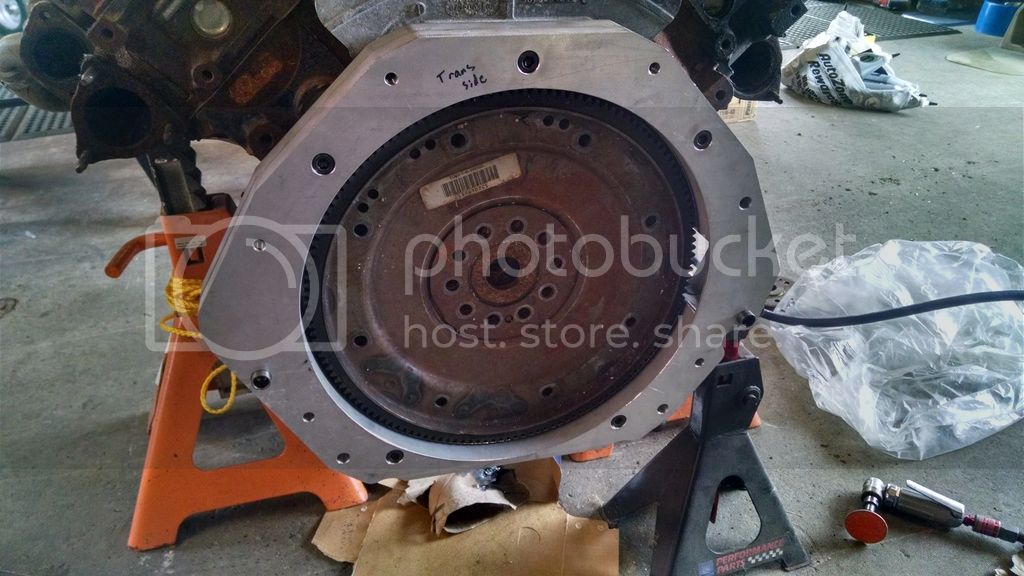

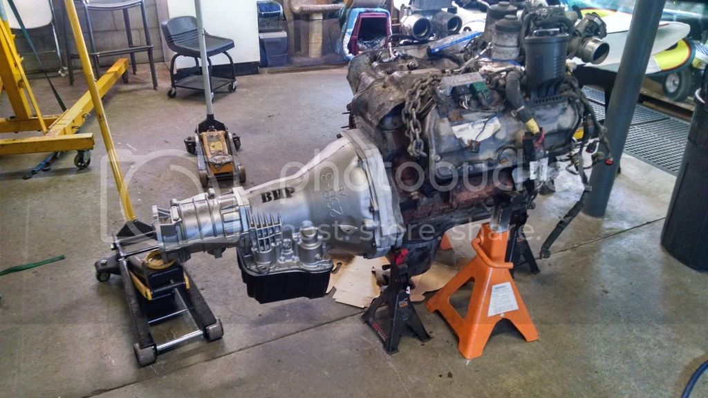

Mock up to modify adaptor plates as well as take measurements for converter to flex plate adaptor or make a whole new backing plate with ford pattern.

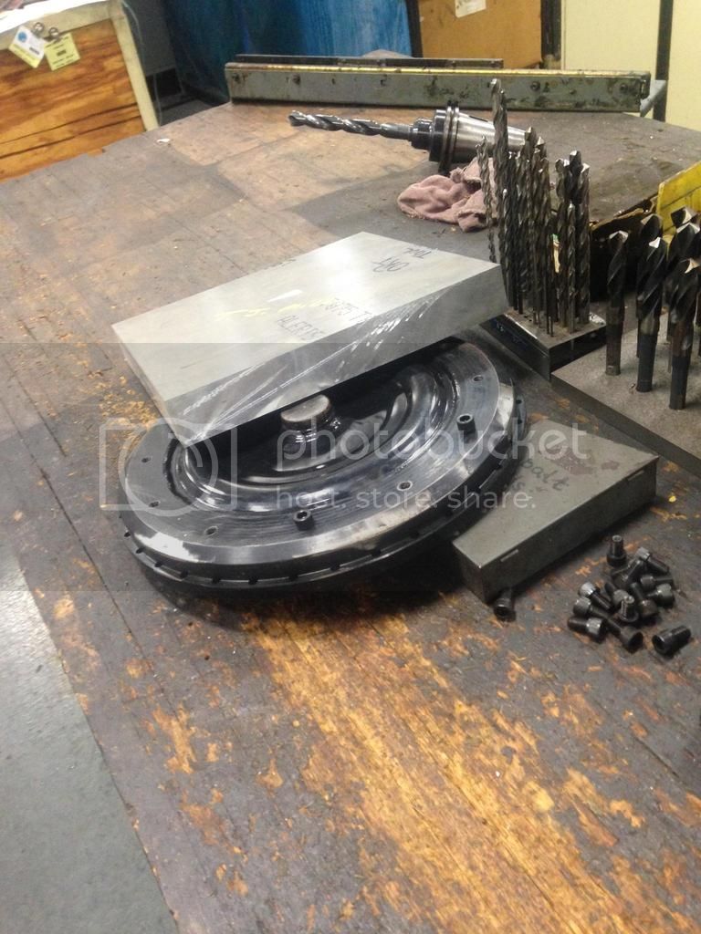

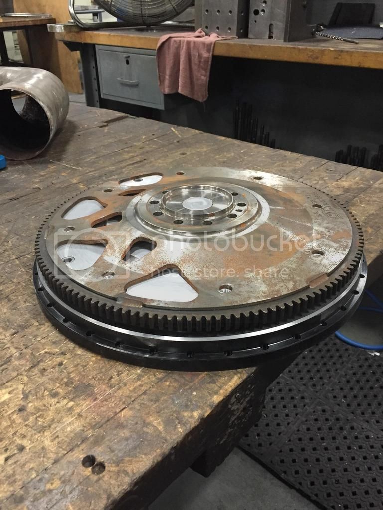

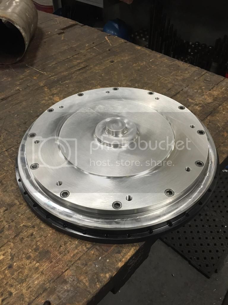

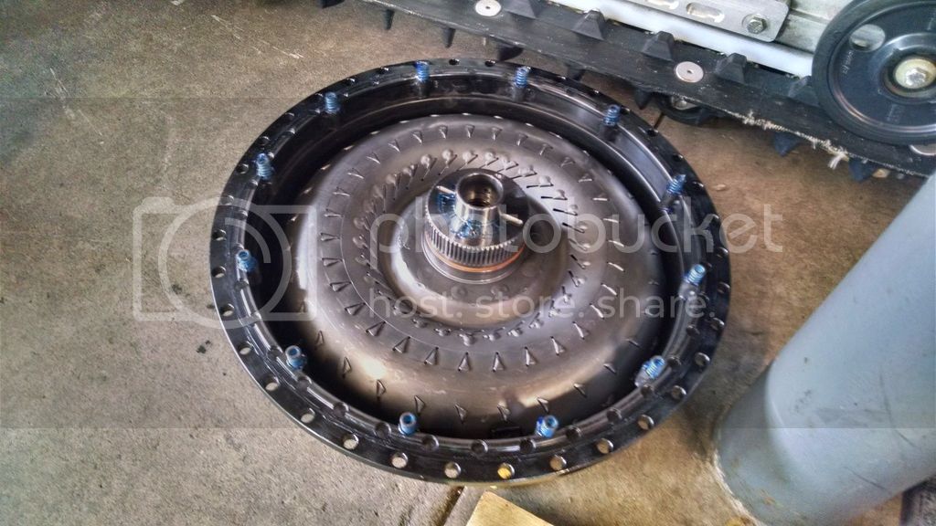

Same here. Have to have him cut me a new backing plate and pop my ford pattern in it. Converter actually hits the flex plate so my new measurements should be all it needs. Fingers crossed!

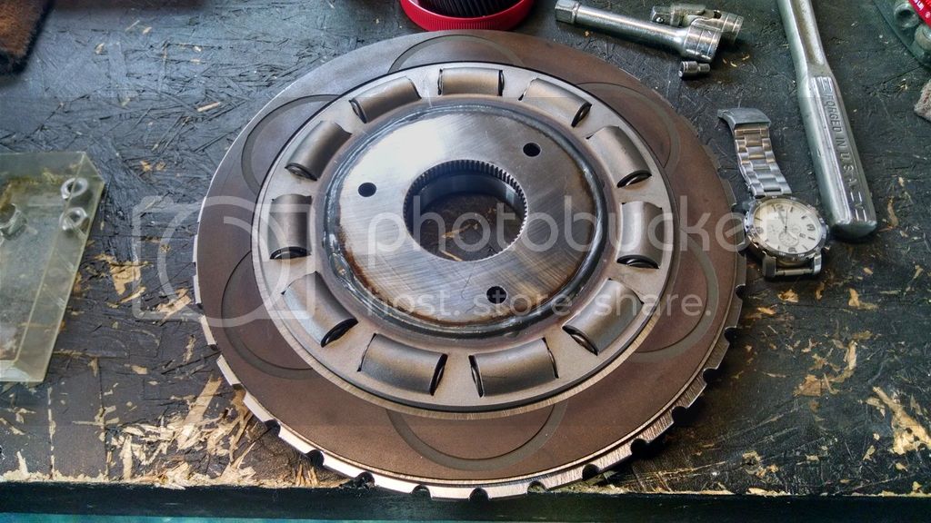

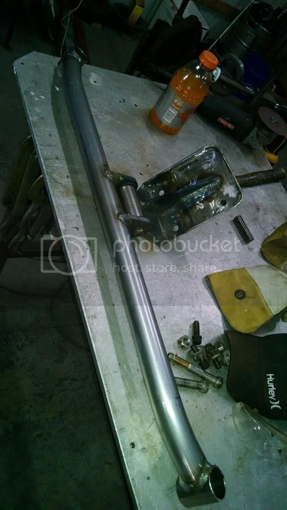

Billet has taken shape. Now all that's left is wiring. Probably gonna need some assistance with that LOL
And some pushrods I had made for a buddy haha
