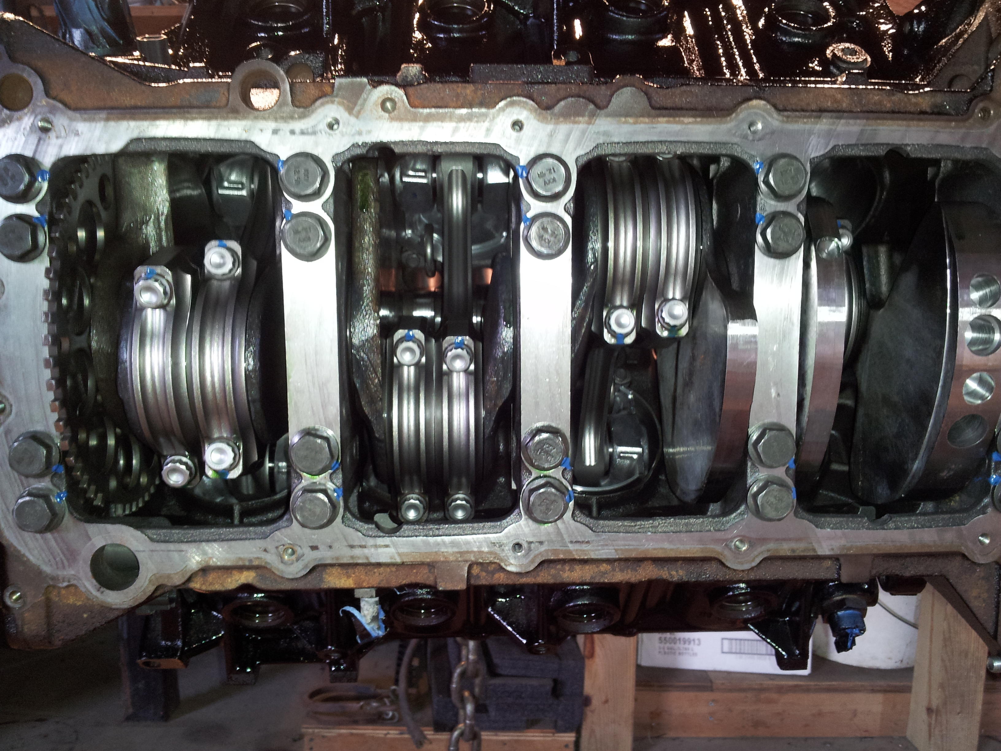

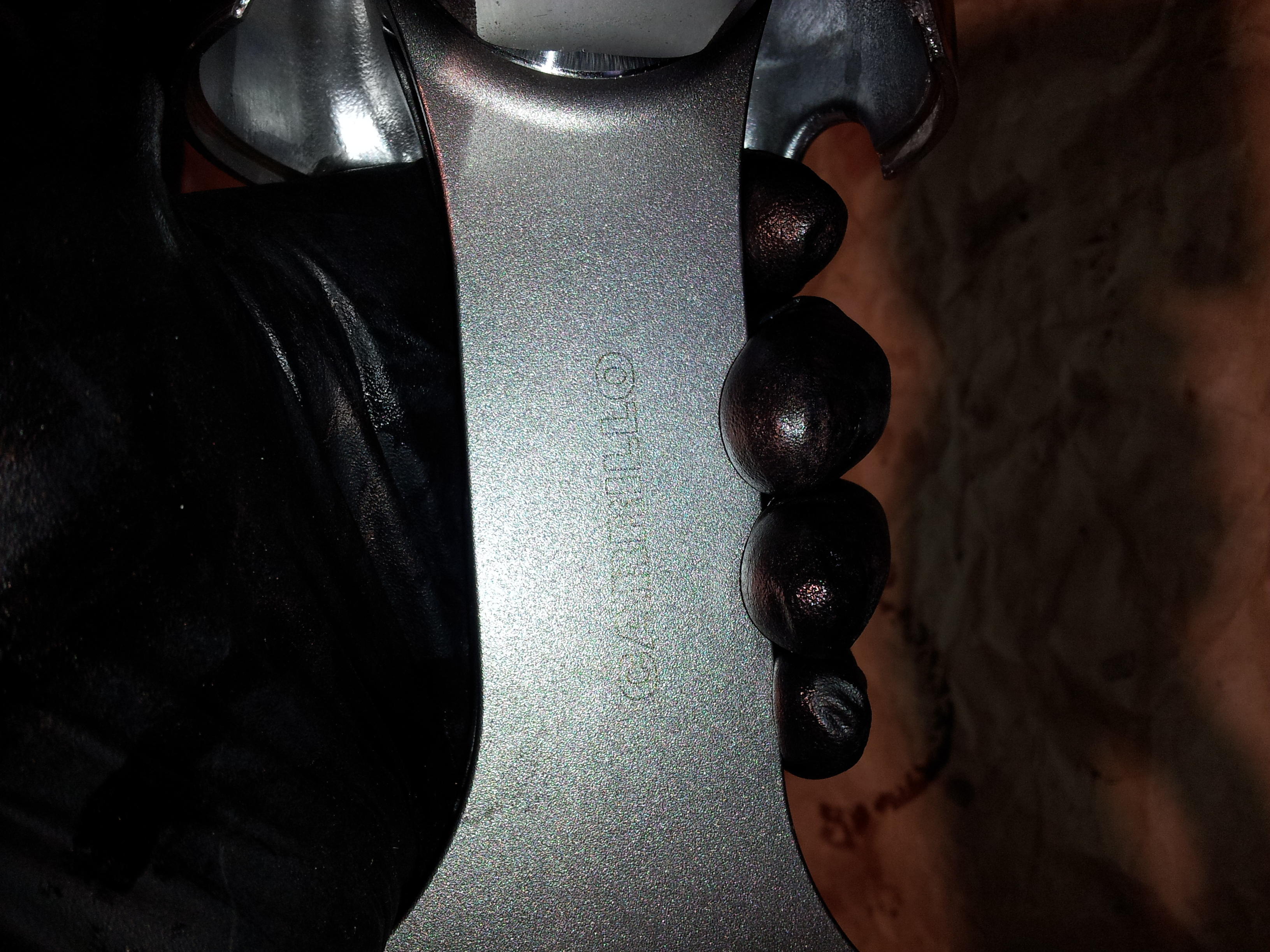

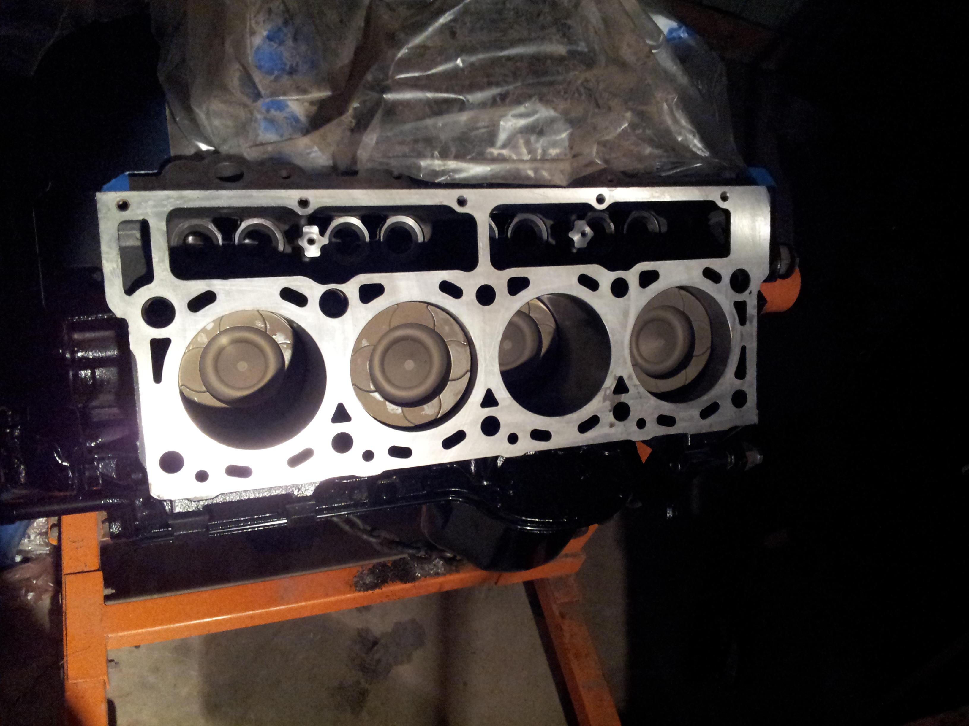

Very nice,, our build sheets are very similar,Well I guess its about time to post a little info about my budget build. Nothing crazy, but it gets me from point A to point B. Oh and for any of you who know me Keep this between you and me! The woman doesn't know about it, so lets keep it that way!!
Now on to the slightly cooler sh!t...
The truck is a white 08, its my daily driver so I needed reliability. Not to mention I haul my kids around in it along with a trailer now and then, so its not just a grocery getter(here's looking at you Troy)
Well I guess the easiest thing to do is just give you guys a small list of whats in this b!tch.
.010 over block
Fully balanced rotating assembly
Carrillo rods
Fly cut, coated, and delipped pistons
Gapless second ring
ATI balancer
Side Action Diesel PUSHER cam
Side Action Diesel lifters
Side Action Diesel push rods
Side Action Diesel valve springs
Midwest high rev retainers
Ported, polished, and O-ringed heads
RCD balanced and flowed 80% injectors
Side Action Diesel fuel bowl ******
Side Action Diesel low pressure fuel system(Fuelab 200)
Side Action Diesel dual fuelers using low mileage oem pumps(K16's)
Side Action Diesel custom compounds (side action 68mm vgt over borg fmw s482)
New ford oil cooler
Bullet proof diesel Billet water pump
No limits 5.5" intake
No limits heater core line
RCD stainless coolant Wye
Dual waste gates(one feeding the 82 one dumping to the atmosphere)
Turbo smart blow off valve with electronic controller
Alradco intercooler
Alradco Radiator
No limits cold side intake piping
Side Action Diesel crank case vent
Ported and polished 6.0 manifolds, also lava heat wrapped and high temp painted
Side Action Diesel 6.0-6.4 up pipes with HD bellows, lava heat wrapped and high temp painted
Midwest stage 2 ported intake manifold
ARP studs
So I think that's it but if I remember more I'll post it up. Now hers a few pictures of assembling this heap.
