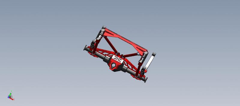

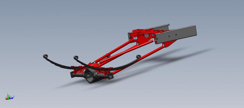

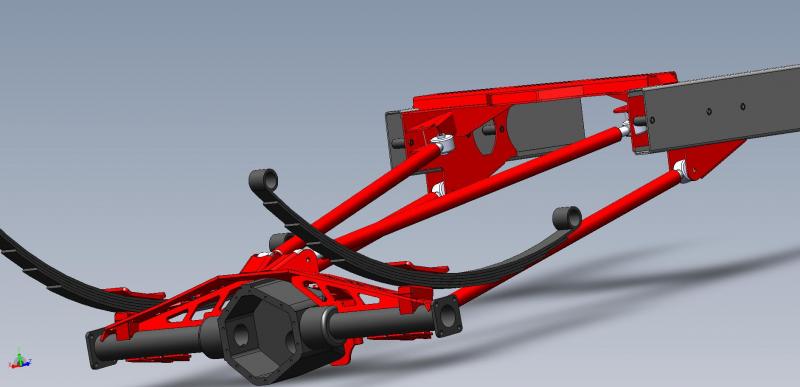

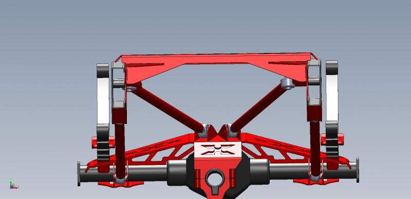

I'm still trying to figure out the torque control aspect of putting the rear axle on air.
My latest thinking is to use the leaf springs to hold the axle side to side and have an upper torque arm attached from the top of the diff to the frame crossmember and have 2 lower torque arms attached under the axle tubes to the bottom of the frame. All torque arms would have bushings in both ends.
The only problem I see with doing that is getting the arc of the torque arms to match the arc the axle wants to travel with the leaf spring. I'm wondering if it would work to put a shackle at both ends of the leaf spring to allow fore aft movement so the axle can easily follow the arc of the torque arms.
You can simply remove the springs alltogether and use a pair of radius arms and a panhard bar for side to side location. Or do the same with 4 links instead of radius arms. If you just want to use the leaf springs with some air helper bags you could just add a set of single axle mount traction bars and let the combination of the spring and the traction bar control your wrap.
Sure you could put a shackle on each end of the leaf spring - but that is a TON of work.
Keep in mind that I am not opposed to the "ton of work" option. :D
