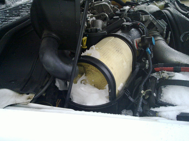

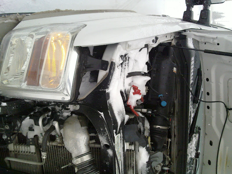

I put 1600 miles on my F350 this past weekend, 800 miles in storms. The *&^*%!! air cleaner plugged twice with snow. Other than that and a few engine hiccups, its an awesome truck. I can't wait for it to have a Cummins.
How do you keep encountering snow problems?
I moved to minneapolis MN and neither in my 7.3 nor my 6.4 do I have this problem, even when it was snowing so hard in 2010 they actually shut down the twin cities:jawdrop:
In both trucks I modified the factory box before hand just to get better air flow. W/ the 6.4, I pulled the fender liner back and took out the "snorkel" thing that goes to the head lamp so it now can also pull from the fender emblem area. I modified the factory box and removed all the scoop and snorkel junk that routes the snow to the box and it works great. I replied to a few of your PSN post concerning air boxes.
Like I said, I've driven from the TC to rockford IL, snow the whole way, no issues or problems. From IL back to the TC in another snow storm no problems. Locally in heavy falls, at one point the "non" snow routes and side streets were almost 4 feet deep in snow and since I have to park in the back I have no choice but to drive through that deep snow, no problems. The grill was packed full but when I lifted the hood and checked the air box, dry as a bone.
ITS FREE TO DO :D and it might solve your snow issue for the time being.
Sometimes I have to drive in storms.
I don't think drawing air from the fender area would have helped in this instance.
The problem is that the air intake system is too small, which accelerates the air, which cools it and causes moisture to drop and freezing. I've had it happen in freezing rain as well. No sign of snow anywhere, but in the airbox. *&^*$%!
I'll address this issue when I do the swap.
I've been there as well, with a S&B intake. I carry a spare filter for this reason.
That is interesting to know. Thanks for sharing that.
I thought the issue was the snorkel hose on the 6.4 setup. I guess not. I guess the solution is not to put the filter in a small box.
On my '99, I have a BHAF sitting in the open behind the headlight. I've seen it with some snow on it, but I've never seen snow packed onto it. It has so much outside area that it would be hard to pack the entire filter, especially if it wasn't in a box.
