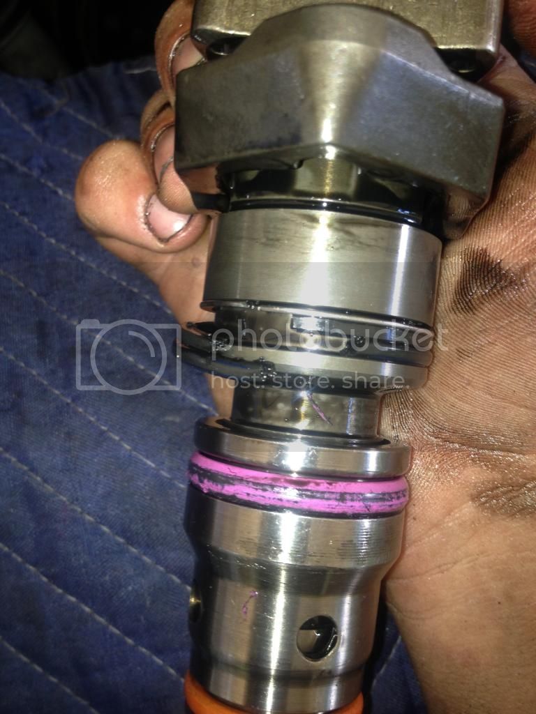

did you lube the o rings with oil before installation? ive NEVER ripped an injector o ring upon install out of the hundreds of 7.3 and 6.0 injectors i have replaced.
Yea I did. Ive installed a bunch of injectors over the years on 7.3's and have never ripped a O ring. It just baffles me as to why all 4 injectors had ripped O rings. Im going to replace them Tuesday and give it a try..

Here's a picture

Thats messed up. A couple of mine were buggered up when I pulled my stock injectors out. I used that stp crap to lube them so im not surprised. I guess the zinc eats orjngs. Or so I was told.

Yea mustube did. He has new 175/100s from PIS. I just put 250/200s in from there too. Hope my orings arent effed up.
I got these o rings from Tim. Replaced them the last time I had the injectors out. Maybe he got a bad batch.

Yeah, I had the same deal and just got done with it yesterday. If you go to my thread you can see that my top 2 o rings failed but there was a piece of wire behind my o rings.

Nope. Unless he wants to reimburse me for my tow bill and my set of o rings (he won't), there's not much he can do. There was a piece of wire that clearly caused the issue.
Do not tell me that. I think I used the same stuff as I figured hey its good and thick and sticky and will stay put while I push them in. Great. Well in this case I really hope you are wrong.

I would tell him no matter what. Its not just the o-ring was trashed it was the wire behind it. If that came from one of his processes then he needs to be on the look out or change it. If it was just some weird "no idea how that happened" then OK but still a heads up on it given the obvious pride he has in the way he goes about things IMO he should be told about it. Kind of thought he might pop into your thread.

I was warned after the fact. The zinc in that stuff eats the orings. No bueno for heui.
And big surprise my orings were fairly chitty looking after I pulled them out at 4500 miles to remove the injectors that were full of srp1.1 guts. The injectors werent puking oil but with poppets full of pump shrapnel it was a time bomb.
