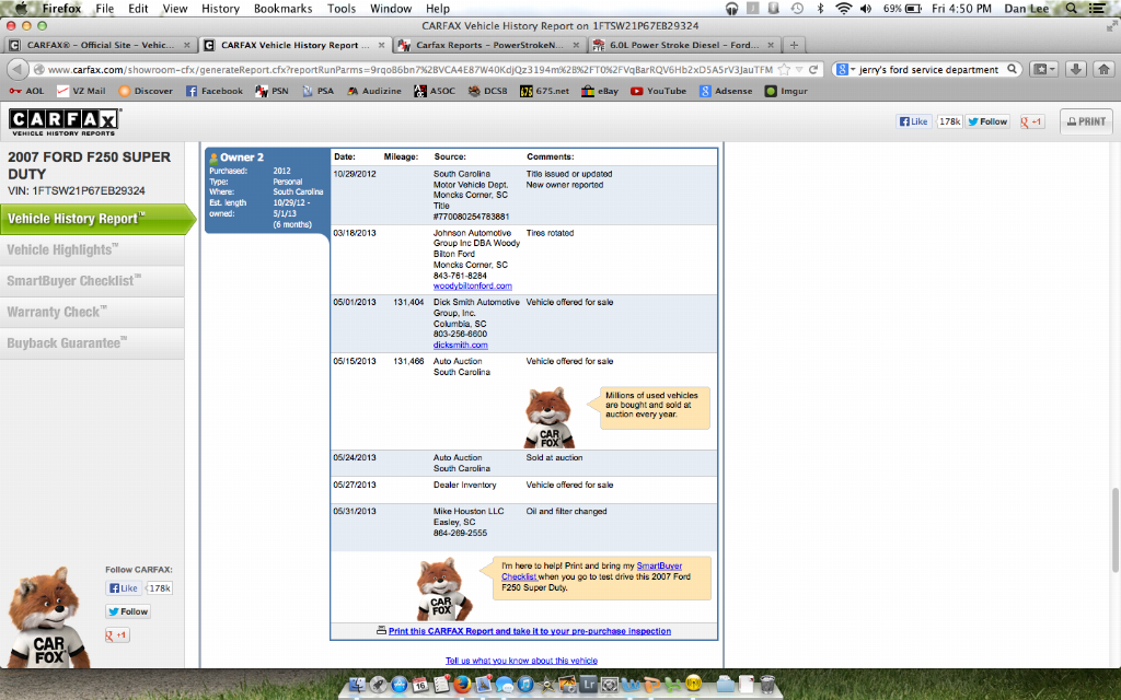

I went ahead and called my local ford dealership to have an OASIS run. Truck had the egr/oil cooler checked and coolant flushed at 91k, head gaskets at 95k, and glow plugs at 98k. Also had various recalls sprinkled it there. No record of injectors being done.
The carfax also shows that the guy who has it now purchased it at auction.
My questions are:
  1. Should I worry that it was sold at auction?
  2. Assuming it will need injectors, what will that cost?
  3. What you think would be a good price to grab it for if it checks out mechanically. I'm taking $100 bills
  4. Anything else you're thinking and/or think I should know
Thanks in advance! Hoping to be able to get back in a truck ASAP

I wouldn't worry about the auction aspect at all. As for the injectors, expect $2k for the new set and labor for install on top of that. Be sure you mechanic checks the coolant vs oil temp, fuel pressure and ficm voltage. If those are off, expect a heathy repair bill. I couldn't pull-up the link but a 6.0 with near 100k rounds should be in the 16-17k area. Best of luck.

as for the injectors, they could last another 100k or they could go down tomorrow. a lot of it depends on oil change intervals, and fuel quality. or if they run out of diesel often its hard on the plungers and pintle. usually its just spool valves getting dirty. I wouldn't worry. if you go to a mechanic that actually knows what they are doing then it shouldn't be an expensive fix. knowledge is your friend.
