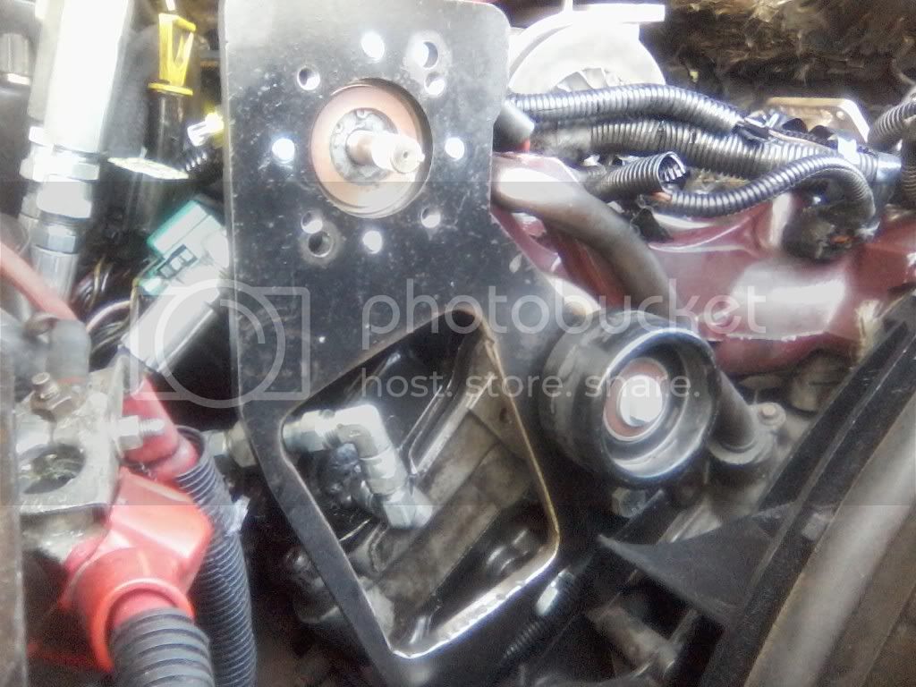

There was this f450 bucket truck at my work with a hydraulic pump on motor with a clutch pretty cool setup took a picture will upload when I get home

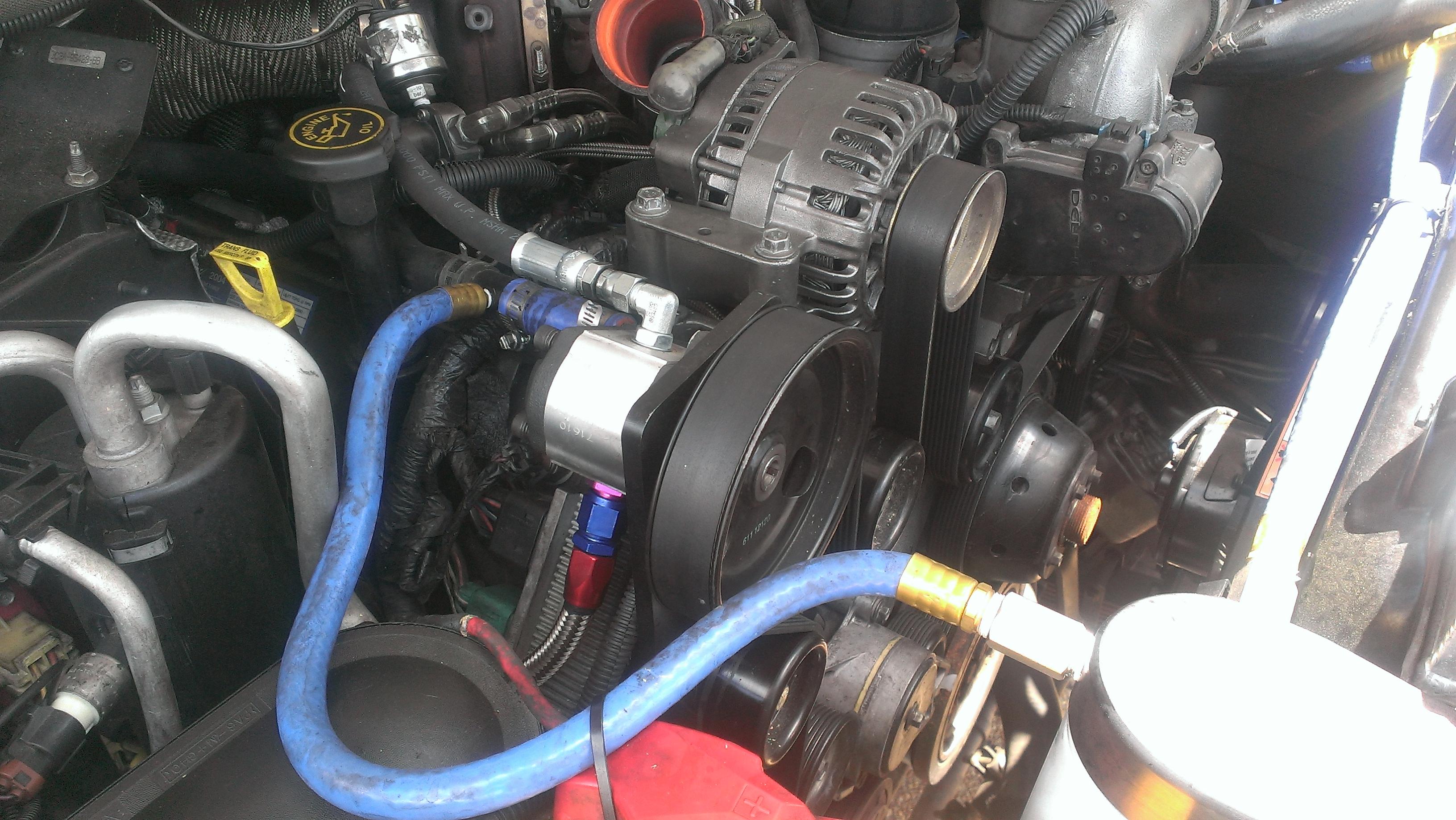

My bad I thought I posted some pictures of Jesse's system on here. I'm running Jesse's dual pump kit and holds abou 4.9-4.8 of ICP voltage. I'm running 225/75, and with stock pump I could hit 4.8v spike then go back to 2.4v when holding down the throttle pedal. Here's some pictures of the system under the hood.

Got any pics of the lines going into the valve covers
Here is the drivers side line:
I put a little goo on it the first time, but that really isn't needed if you have the right size grommets. Of course the crap doesn't come off so it looks like hell, oh well, live and learn.
Here is the passenger side. I may route the line a little different, just not sure how yet.
Full underhood, not the most recent but you get the idea
