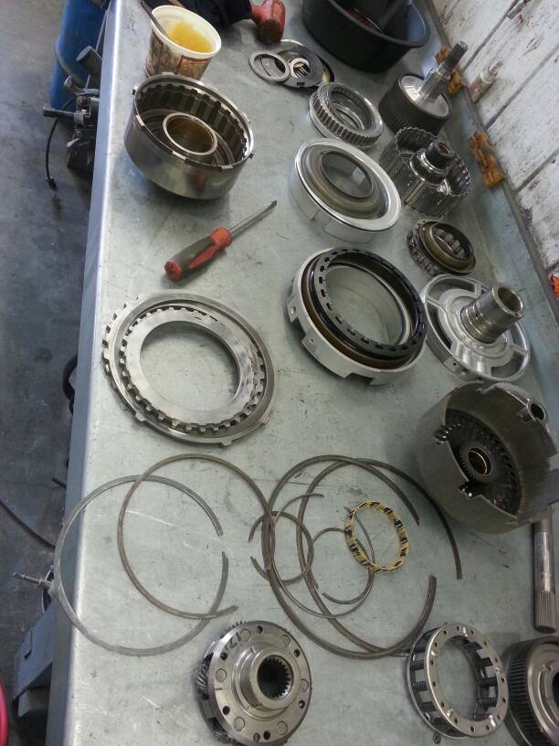

Trans is back together and converted showed today.
I do have a question though. The converter came with a different spring for the pump, but that spring has already been replaced with the transgo unit. Am I safe to just leave the transgo spring, or should I pull the pump and put the other one in there?

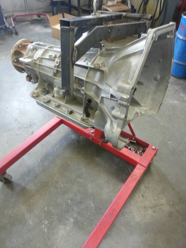

I was able to get the tranny installed this morning. Working alone sometimes presents challenges when trying to maneuver heavy items, here is a trick I have been doing the past few years to get the tranny up onto the jack.
The new converter feels much "tighter" than the previous and really changes how the truck feels on the street. Its very easy to spin the tires from a stop or roll on now. The rest of the trans feels pretty solid, but I will need to tweak shift pressures down a bit under part throttle and hold the TC lockup off a few MPH. Overall, the initial impressions are good!

Nifty trick lifting the trans.
What if you don't have a hoist tho..... Canada doesn't have those yet :)
