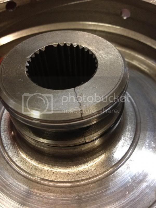

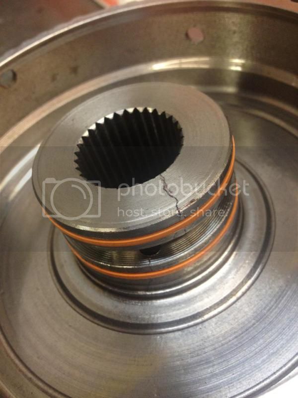

Was able to tear into the tranny today. Looks like there is more problems than just the converter. The OD and direct frictions show some wear but the intermediate clutches were smoked. I also found the forward drum was it pretty rough shape also.

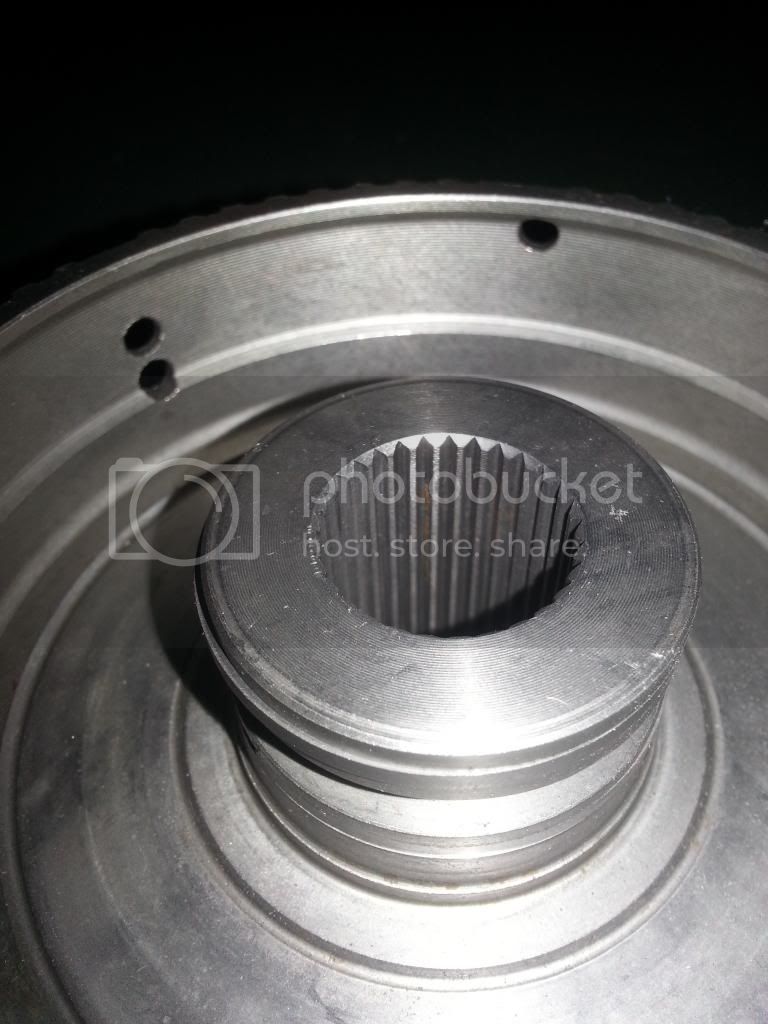

Going to try a PI Stallion, E4OD forward drum and another set of those Alto's. I am not going to drop the coin on anymore billet stuff until I have the satisfaction of breaking the originals first.
I have the new drum, the converter should be here early next week and hoping to have the clutches ordered up soon.

Here's a pic of the E4OD drum. If you reference the picture above you will see its splined all the way though, this should prevent the drum from stripping in the future. However, I was told the reason the 4R100 drums were only partially splined was to prevent it from breaking from the lack of material on the opposing side due to the sealing rings.
Guess I will find out which one is stronger.

I've broken a e4od and 4r100 drum in my truck at 600ish hp. Finally just went to the over sized intermediate and billet drum. it isn't fun the second time just makes me wish i hadn't gone cheap on my own stuff. I would suggest a billet o/d planet.
