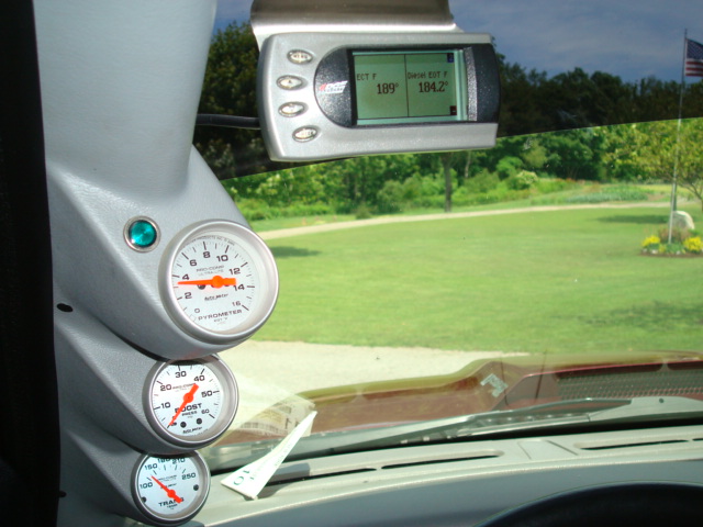

A light comes with the snow kit. It lights up when it starts to inject. I ended up getting a larger LED one and installed it right next to my pyrometer gauge on my A-pillar.

This is my old gauge setup...but this is what it looks like with it next to the pyro.
He was talking about a led dome light lol, but it would be nice to have a little led that came on whenever it starts to inject since my kit is a stage 1 it doesn't have that... Something I need to loom into
So that's what lit up every time it started to inject? That seems like it would be a little bright, no? Wouldn't a smaller one that's just bright enough to see its working be better? I know on my truck with the tinted windshield if something that size came on so close to the windshield at night it would probably make it impossible to see the road lol
