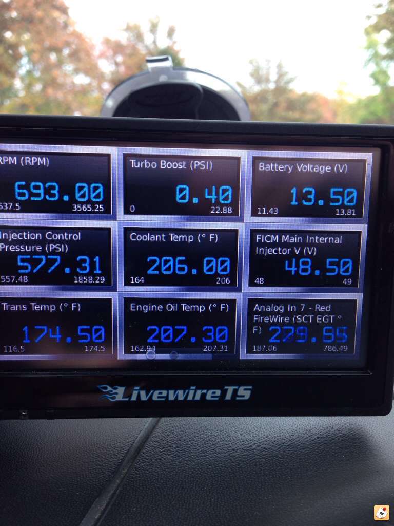

O2ShootTheJ
May 19, 2011
3,567
I don't get it. Stopped at a stop light an temps jump up. Let it idle for 2-3 minutes when I got home and these are my temps. What would cause this. It's like 65 outside.
