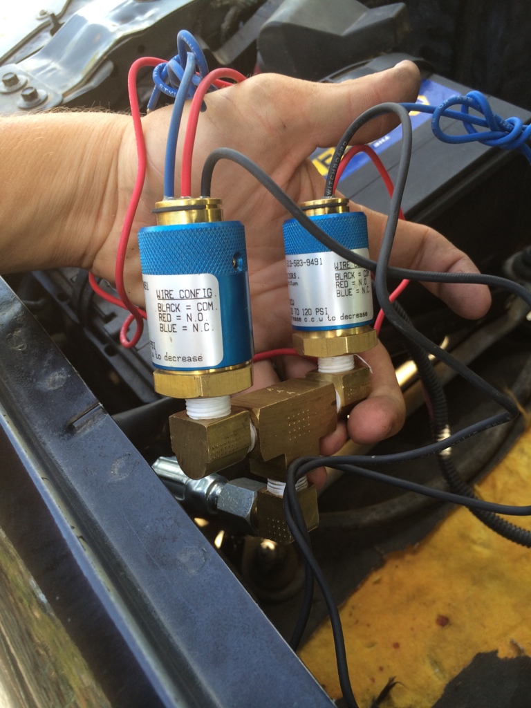

Colton and I have worked on this yesterday and a little today. We got the 4 inch exhaust all done and got the OD and lock up solenoids wired in. We've spent some time driving it and tuning the solenoids to get it set how we want. It's taking a lot of fine tuning so were about to run the solenoids into the cab so we don't have to keep getting out to adjust them. We plan to take it into town to get a new ac line made up tomorrow and charge the system, it's too dang hot to cruise windows down haha. I can already tell this truck is going to be fun to drive and we haven't even left the neighborhood in it yet :D

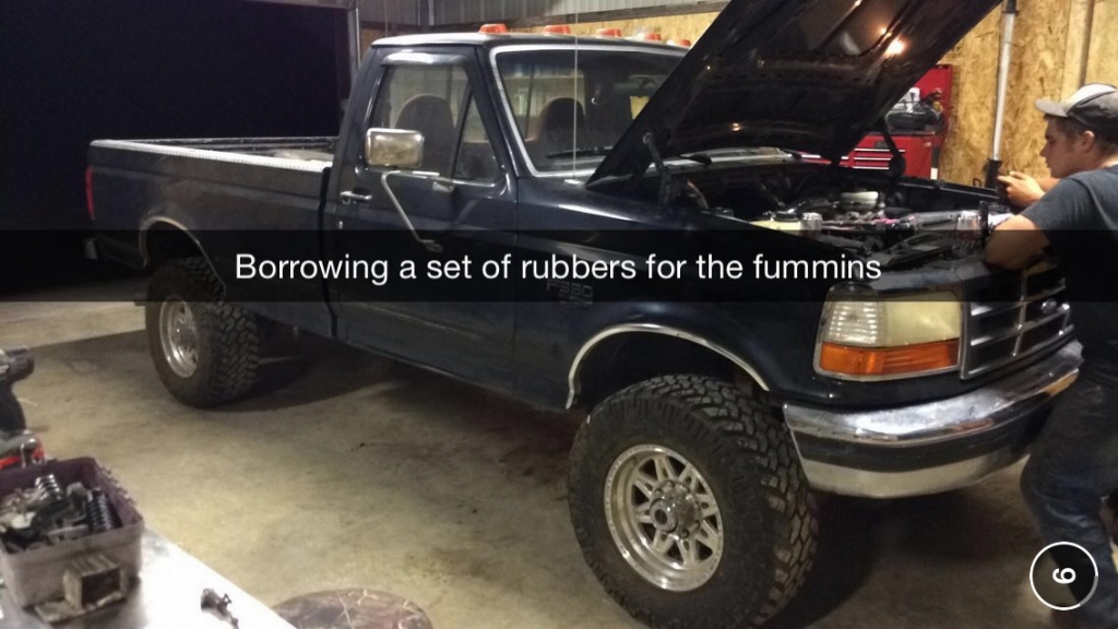

This truck runs and drives great , we're still working on a few very minor things like the trans shift linkage and cleaning up a few hoses. Last night we decided to swap wheels and tires off Colton's obs project just to make this one more road worthy. It looks pretty good! Once it gets a new windshield it'll get tinted and washed, buffed, and waxed. Here's a picture of a screen shot I took of a snap chat, hopefully Colton can get a better picture today.
That looks similar to my setup. I ran into trans problems and I just bypassed the switches but I felt like I needed to run the truck on jackstands to bleed the air out of the hose to properly adjust the switches it just never happened
That's not a bad idea,! I need to look into trying something like that
