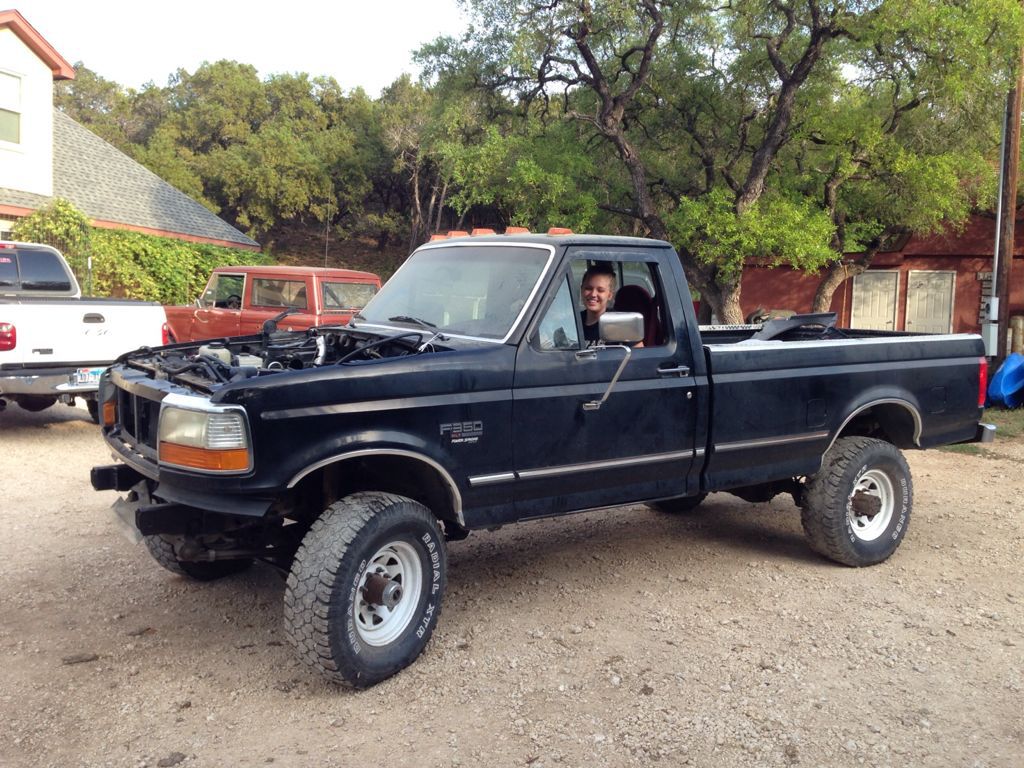

Well we finally let my little sister drive it out of the garage for the first time yesterday, she was pretty excited! We're really trying to get this thing completed before the Centex dyno day on May 3rd, we haven't been able to meet any of our previous deadlines but hopefully we'll make this one! Idiesel (her boyfriend) is gonna do some tig welding on the intake plumbing and the crossover pipe to make it look better, then we're gonna throw a 4 inch dp back exhaust on it that he's got laying around. We're also looking for a way to turn off the CEL but haven't looked too much into it yet.

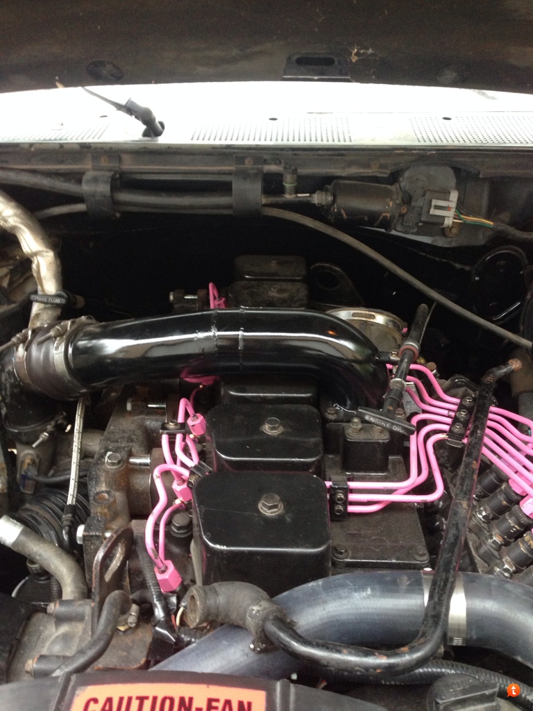

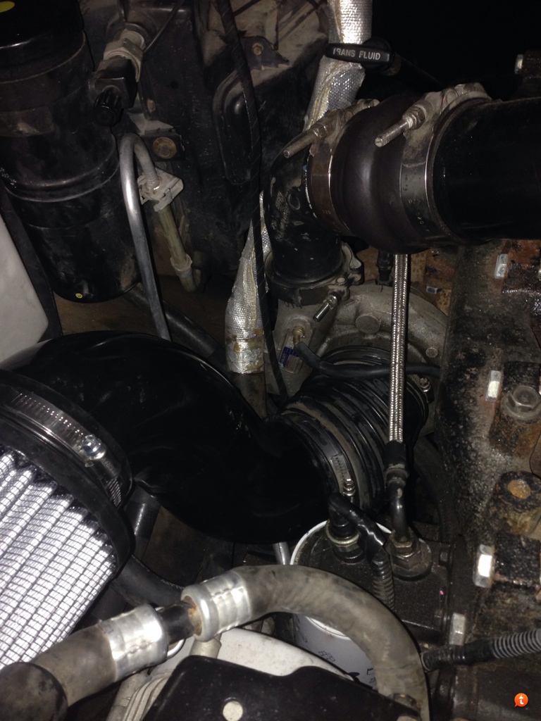

I did get some time to fab the air intake and fixing coopers welds didn't go over very well so I had to end up fabbing a new crossover pipe. Been cleaning up some wiring and fitted the fan shroud on it last week. Soon as I get the exhaust put on I'm going to drive it down to my dads shop so we can rerun some a/c and heater hoses while we have all the parts on hand.
Here's a few different pictures.
Intake sits in there without touching or rubbing anything. I'm not the best tig welder by any means but I'm very pleased with how it has turned out
