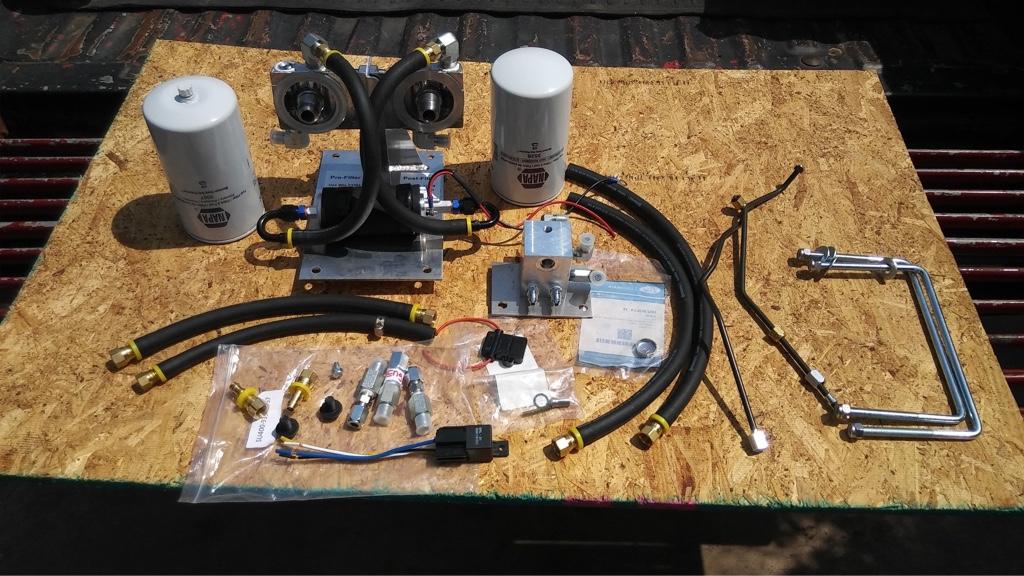

Are you going the Econ route like I did?
My goal was to do it was cheap as possible.

Holy crap!
What fittings are those and is that the factory regulated return??
If so, that's genius!
I reused as much of the factory setup as I could. Along with multiple items I had around the shop- mostly AN fittings, hose and hardware. So yes, it’s is a factory RR. I cut out the regulator from the fuel bowl (tightwad mod) and reused the stock Y lines. Best part is not having to remove the turbski.
The fitting to reuse the factory Y fuel
Lines and banjo bolt is a #12 sae orb to a -6 AN or or 3/8” barb. I had to source mine from a locally from a hydraulic shop and that’s what they had. There’s not much online to source a fitting like that.

I dont remember what pump it is.
Walbro maybe??
Ah. Decent pump for the money then. Just don't let it sit for any length of time or diesel will gum up in it. Technically not diesel rated. But they have been used for a long time for exactly that. I had a couple on whitey.
