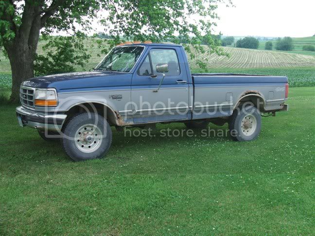

What I started with.

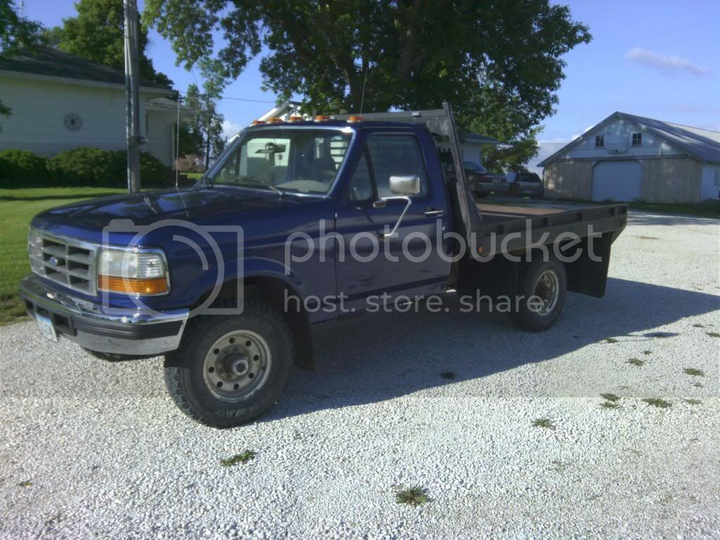

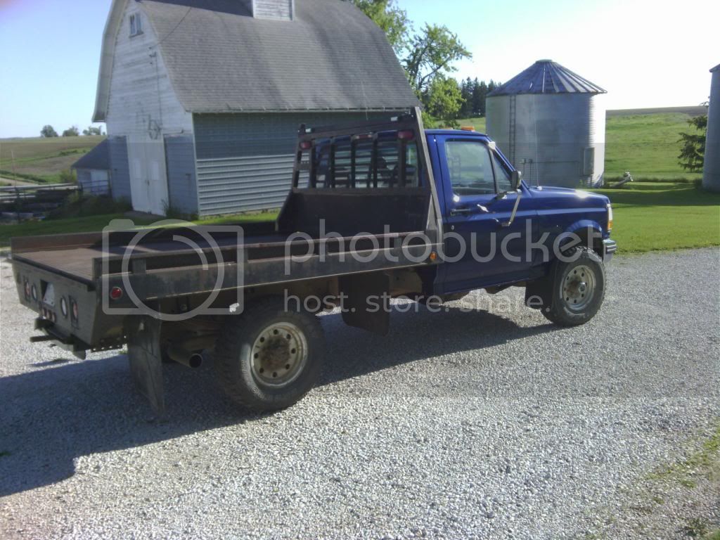

Pretty much finished up. Just got to put the badges on the side yet.

I'm curious, is the big gusset on the front axle a personal preference or was it needed? How is the ride with the coil overs and radius arms up front, and where did you find the coil overs?
The truss was mostly for a square mounting surface to mount the link brackets to. I didn't want to cut a section out of the driver side spring perch like a lot of guys do to mount links so I bought a WFO truss and modified it to work for me. That and I plan to wheel the crap out of it and don't want to worry about bending or spinning a tube on my front end. It rides great! The springs are 450/550 on the coilovers and I got the shocks themselves used from a guy my brother works with.

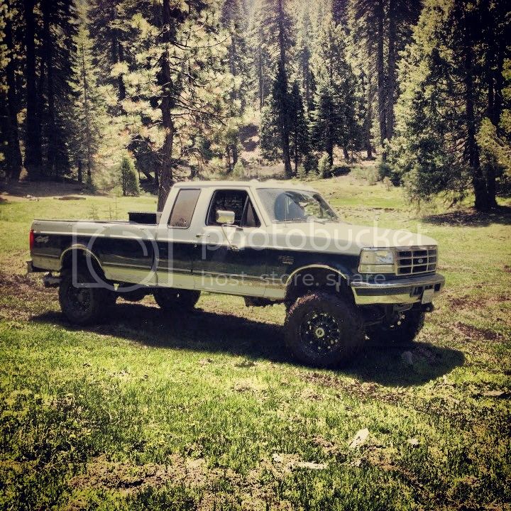

Here's an update on mine. Got my 4.5" PMF RSK w/ V codes on a couple months back. Next up is N Fab steps and possibly a Protech headache rack and trac bars (do I dare go to OUO trac bars? :lookaround:), then moving to motor work.
Stretched her legs in the mountains a bit at our camping spot

Don't do OUO, they're a great quality but you can make a set yourself for about 1/4 the cost of OUO. I made mine myself and spent a total of 200 bucks mounting brackets and all. I was in school though and had the welding program make my mounts but you can make a strong mount yourself if you have access to a welder and scrap metal.
Another friend of mine had a shop make up his bars and mounts for $350 installed. Has had them on for 2 years and hasn't had a problem. (And he doesn't baby his truck too often)
I'm just saying there's a lot of other options out there that are cheaper that do the exact same thing as OUO bars... I just can't justify spending $1000 for something that's pretty simple to do yourself, there's plenty of write ups on here about how to build your own set. Save the extra money and put it in your engine work funds
