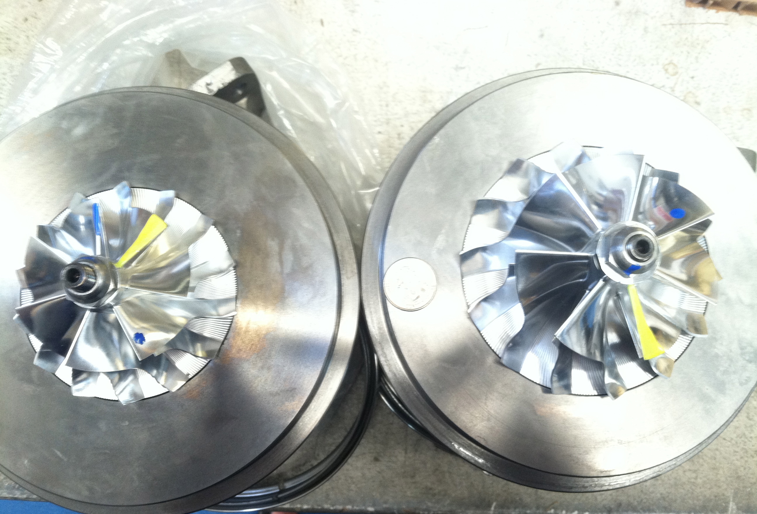

:D Here is the S467 next to the S482 FMW.
