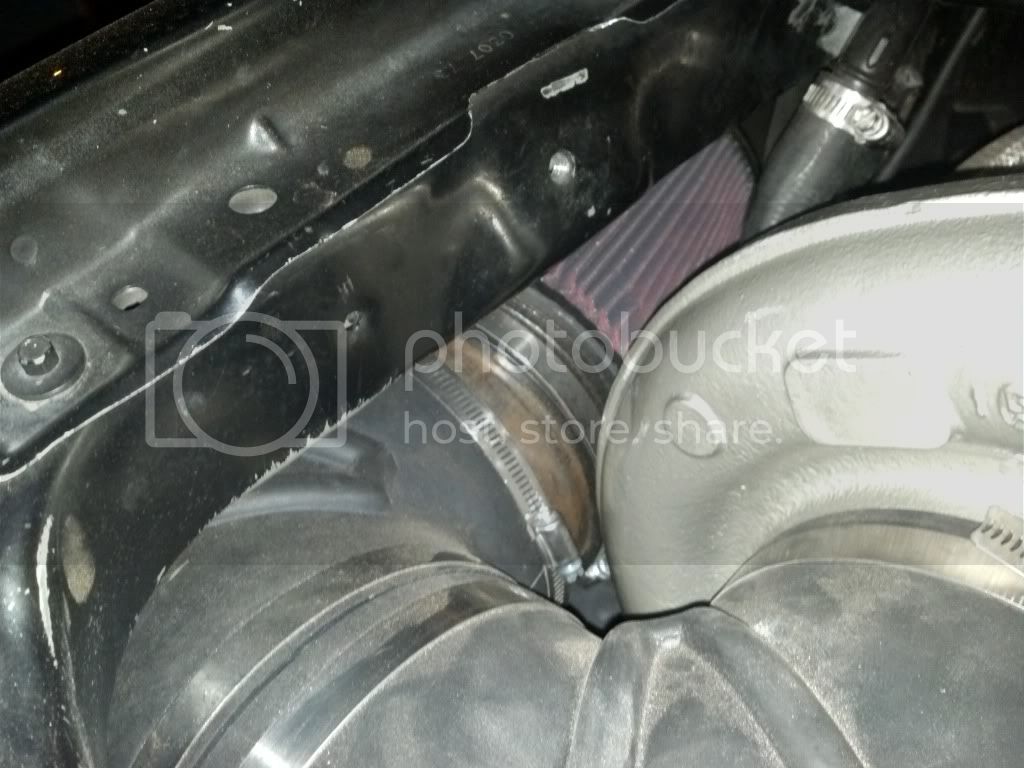

Old air filter set up behind the head light, had a problem with it sucking in water and then making a huge restriction. collapsed the filter on the dyno one time it was so bad
new filter design wraps around farther to the back and should be clear of any water that might get sent thru the grill or headlight

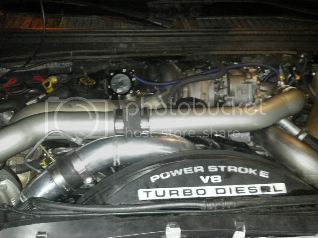

here is the newest set up , filter is much bigger than the last one too. Filter minder seams happy so far.

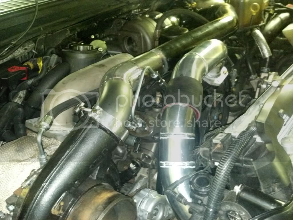

some new pictures, unfortunatly i made the pipe one piece and i made it without the pipe out of the high pressure turbo and it made too much contact so i had to cut the pipe and add a boot to make it fit, i have already blown the pipe off so im going to have to either weld it back up or fab a new one out of aluminum.
I got the new No limit pipe from mike as well, first one for dual fuelers and it fits like a dream, barley had to trim the radiator support and everything lined up great.

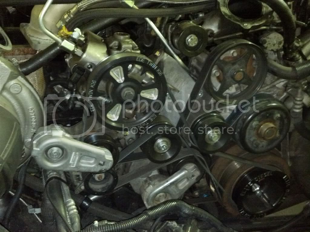

here is a pic of the dual fuelers without the radiator in

It does feel good to have a fuel system that just works right out of the box tho, and the elite/rudy kit is a really nice, well engineered peice, really easy to install, other than the lines are hard to tighten with the intake on. But im super happy so far.
