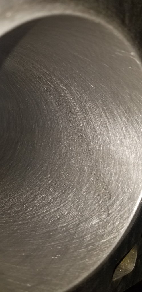

To hone cylinders I use a product called "flex-hone". If you go this route, make sure you use the correct grit for your application.

Yes i was looking at them. I have another block to try in on. I would start light and work up. Maybe 320? If not enough progress go to 240?
I dont see me doing any damage if i use common sense.

Generally I use 240 grit. The cylinder wall is hard, even with 240 it can be a little difficult to get a good crosshatch. A 120 would work fine, just don't over due it.

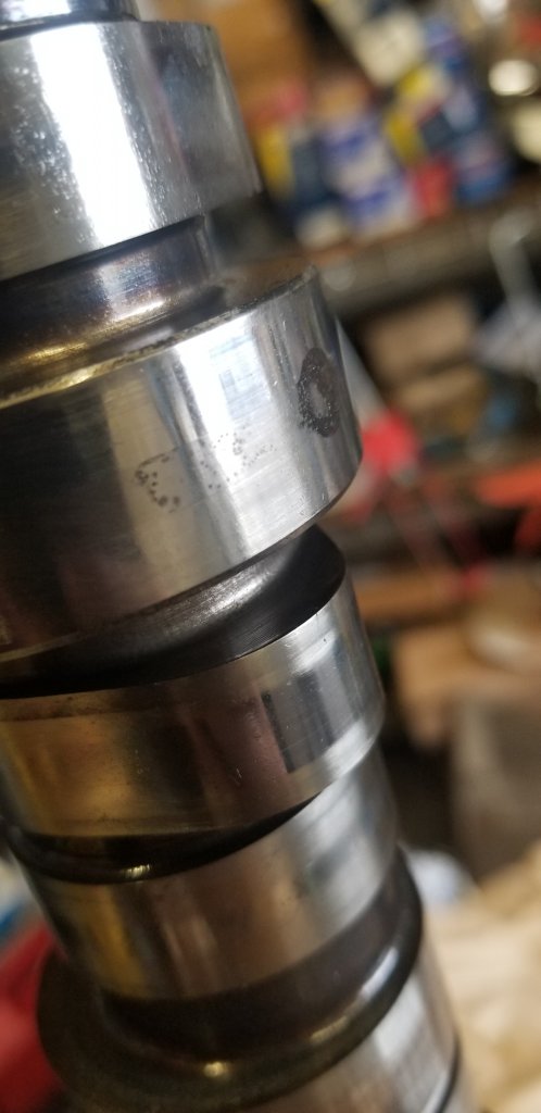

Found 1 spot on the cam

Ditto on the Flex hones. We call them berry bush hones. Much more forgiving than the old 3 stone hones.
Just when you think your up and down motions are fast enough they are not. Also don't run the drill at full speed. Slower the drill spins that means the slower you can move up and down.

As the hone is spinning and you have added generous amounts of lube you move the hone up and down the cylinder at a high rate of speed.
Not a fun job doing all 8, or if you have bad shoulders or elbows.
Random You tube I grabbed. Skip to 2:30 for the actual process.
Process is same for either style hone.

I shoot for a 45 degree cross hatch.
The bigger the bore the slower you want to spin the hone. There's specs on how fast to spin the hone for a given bore size. Of you use flex-hone they have the specs on the rpm for bore size. But that is also dependent on how fast you move the hone up and down the cylinder walls.
I use a cordless drill so its easyer to regulate rpms of the hone.

Any thoughts on that spot on the cam?^^^
I may take a look at the one that is in the truck now....but that causes a few more problems. Idk

It's hard to say from the pictures. It it raised or indented? It could be polished out depending on how it is.
What's wrong with the one in the pickup?
For the price of a cam, you could put in one that works with the seat pressure of shimmed 910s.
With that in mind, I would also put in better push rods with the 910s.

Any discrepancies on cam lobes will only get worse.
All they do is flake off.
Needs to go.

It's not a lobe where the surface rust/corrosion is, unless a bearing journal is called a lobe, but I do agree, depending on what it is. The cam needs to go. This could just be surface stuff from moisture. That round spot looks like where the oil hole in the bearing would be.
If it's a lobe than I agree 100%. Its got to go.

Its not a lobe. You are correct, cowboy. its the journal. Its indented. But technically the bearing has surface to ride on either side of that mark... and force will not be exerted directly on that spot as it would be on a lobe with the pressure from the lifter.
Still not 100% comfortable with that.
It does appear to be where the oil hole would have been on the bearing.

I agree that spot on the cam is not important being a bearing journal. In my younger days I strived for perfection and would never have ran it. In my older days I realize I have thrown a lot of money at things that didn't need it.
that spot on the bearing journal does not need to be replaced.

Sweet. That was my feeling, but i never rebuilt a motor before.

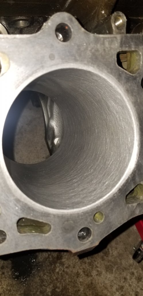

Im digging the hone job. Its not all out but i may just leave well enough alone here. That was a 220 hone. I guess i can go more course but i don't think it will ever be perfect.

I wouldn't go any corser. I have run worse and not had oil burning problems.

Nice! That cleaned up good.
There is a reason I like and use the flex-hone. They are a good tool for any shop and almost anyone can use it with great results.
What did you use for honing oil? I use motor oil.

Yep. lubed up the cylinders and the ball hone, put the drill on low and worked the drill as fast as i could for about 10 to 12 strokes each time.
I had to really stay on it... i agree with Tiha on needing good shoulders and elbows.

If you run the drill slower you dont have to in and out as fast. Looks like it worked good for you. Cleanup is a mess though. Hot water with soap and a pressure washer is how I do it.
