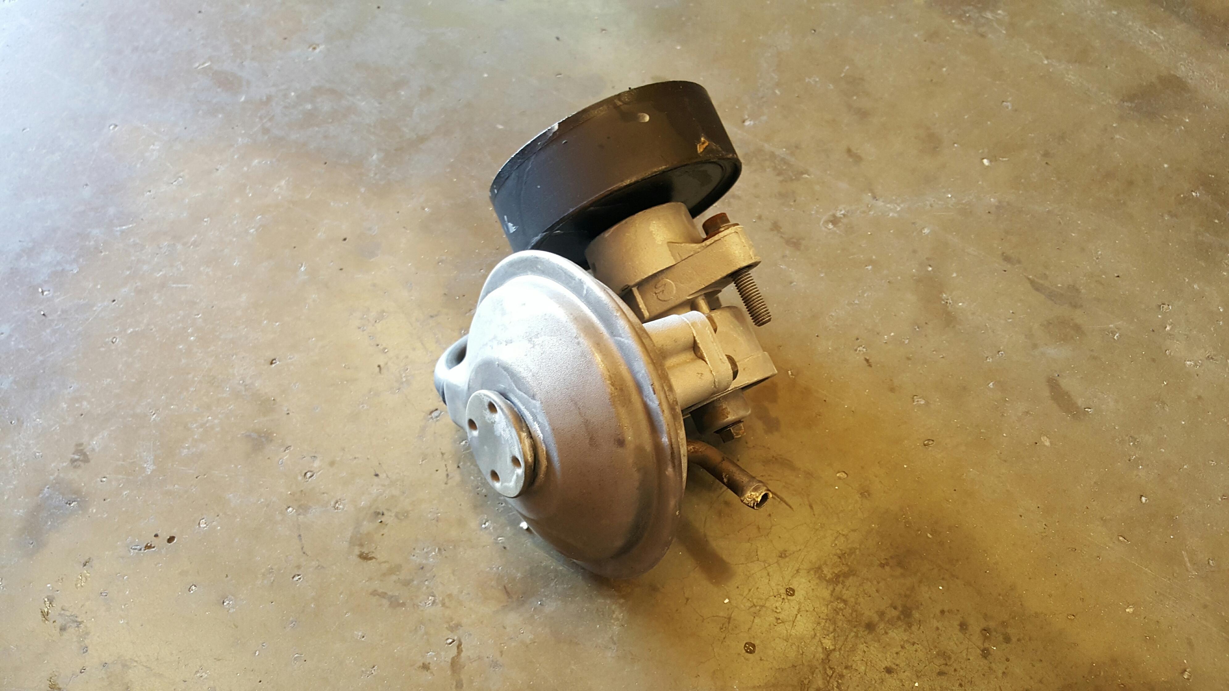

Well, i got the heads off to my buddy who owns his own Diesel shop, hes sending the heads to a machine shop he uses routinely. Theyre going to clean them up, Magnaflux them, and then inspect valves and see if i will need a valve job done. They said without the valve job, im looking at maybe $150. So I dropped the heads off today. My buddy said he is going to try and test the injector cups that are in it, see if he can rig up something to pressurize them and see if they are cracked, (all because my dumbass didnt do any diagnosis, and just pulled the heads...), he is also going to install the new injectors cups i have for free.
More good news today, i went to go pull the radiator out of the truck (as it is cracked), i went to drain it, and the coolant that was in the radiator was still perfectly green, smelled like only coolant, not mixed with anything. So its probably safe to say the cooling system didnt get damaged. If it did, it would have either oil or fuel or something in it correct?

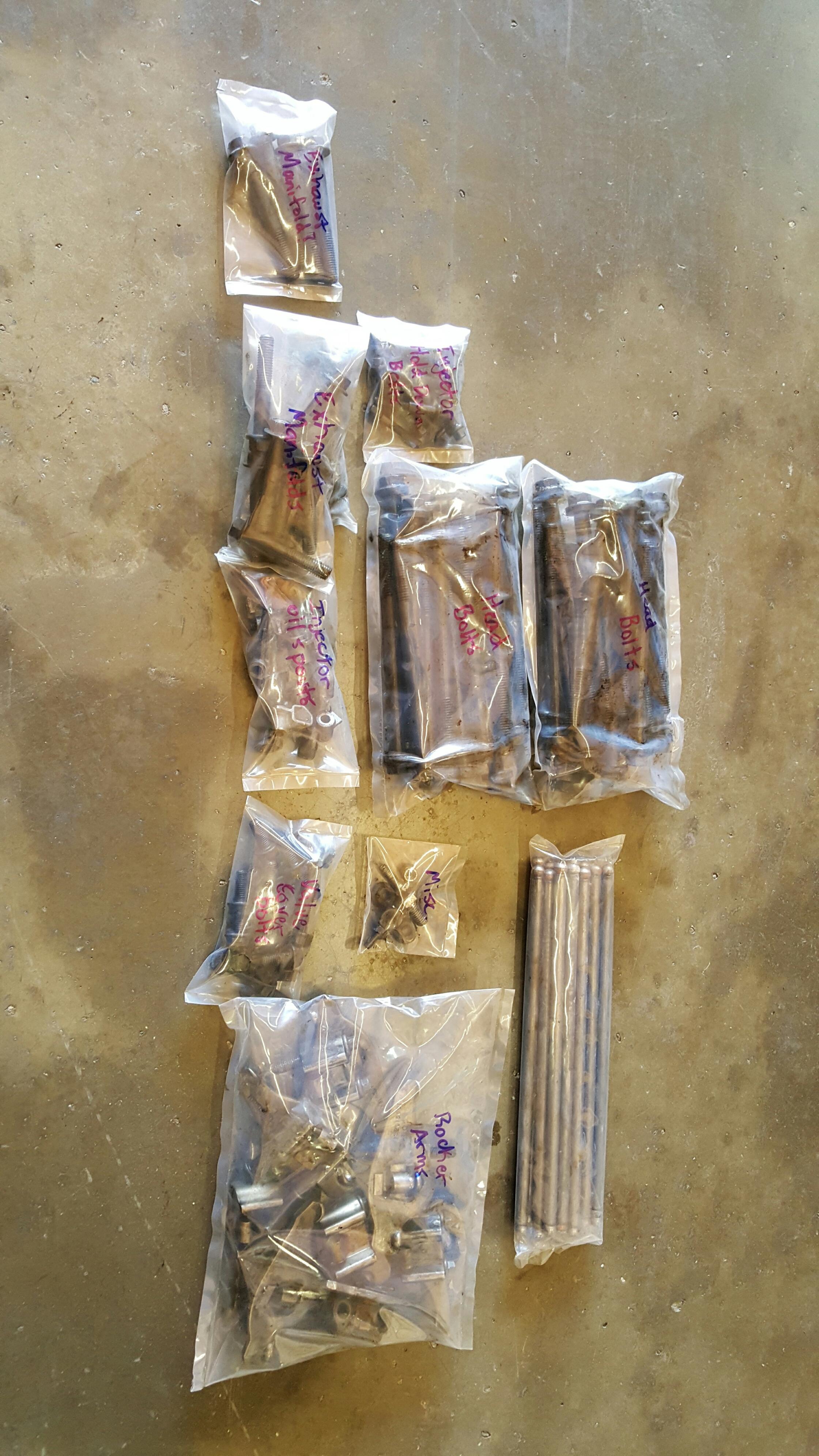

I also started organizing all the bolts and parts i had in boxes. Cool to have a bag sealer at work, so i bagged up each set of parts and labeled them for future reference. And i got some pics of the parts after they came out of the parts washer, before they were solid black, covered in grease/oil/tar and such.
Going to finish pulling the radiator and turbo, along with the rest of the exhaust tomorrow, ill take pics, and wish me luck...

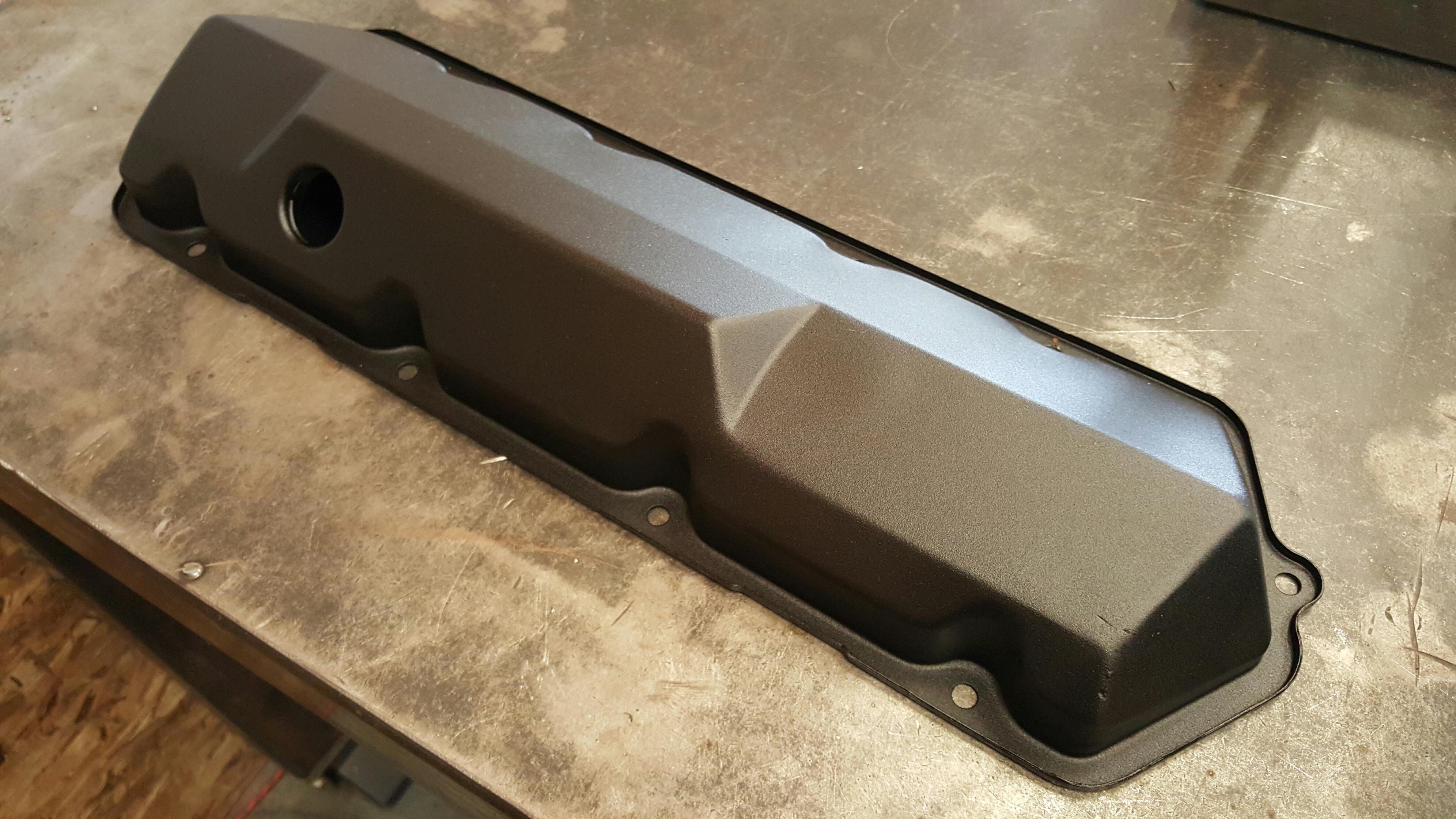

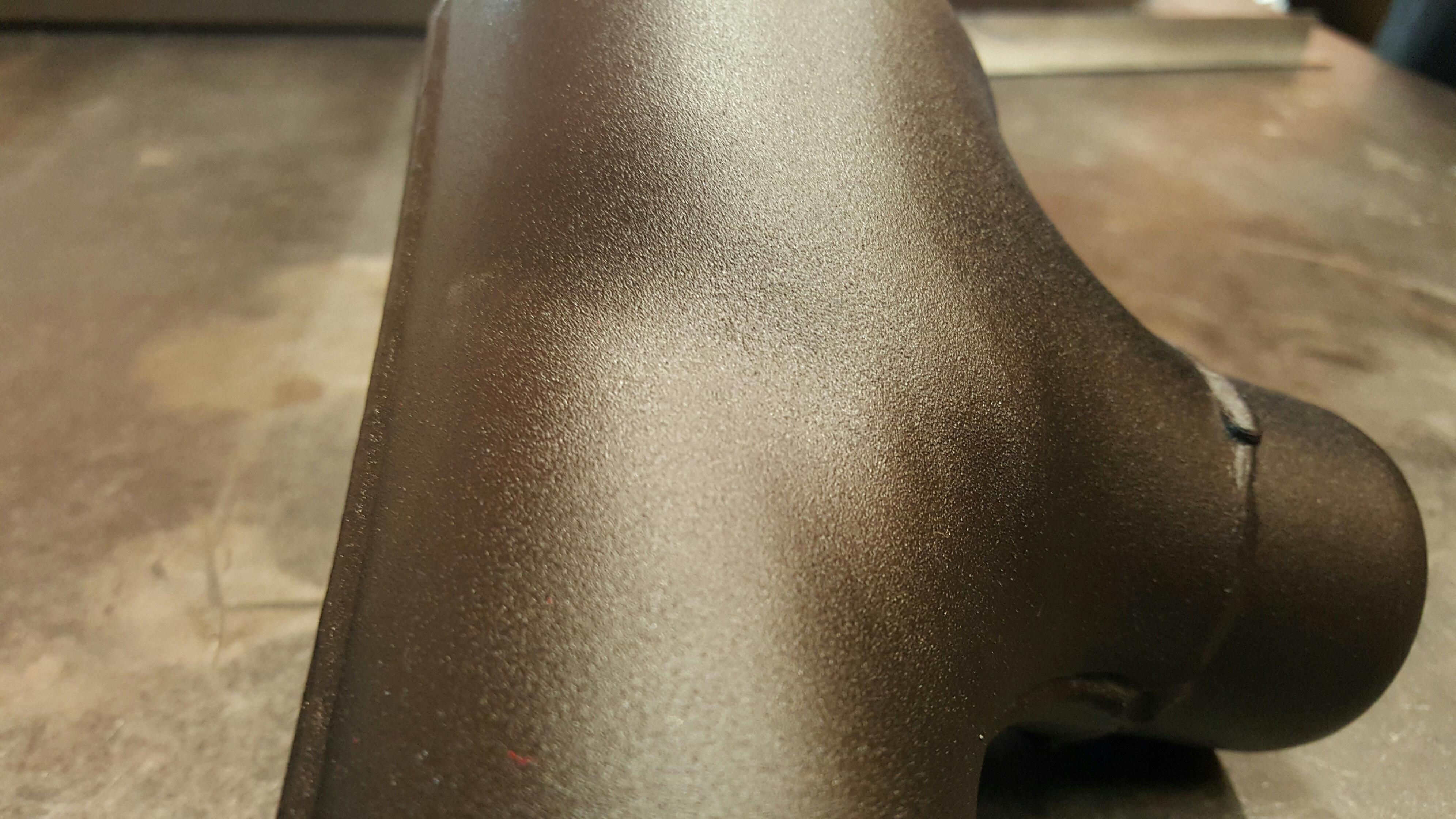

I also dropped off the valve covers and intake spyder at powercoat today, decided to go with a Mini-Texture Black. And the valve covers and intake spyder are steel btw if anybody was wondering. I welded up the hole that my boost gauge was threaded into so i could relocate it in a better spot, and my valve cover had a dent, so after some massaging and a little TIG weld, it looked brand new.

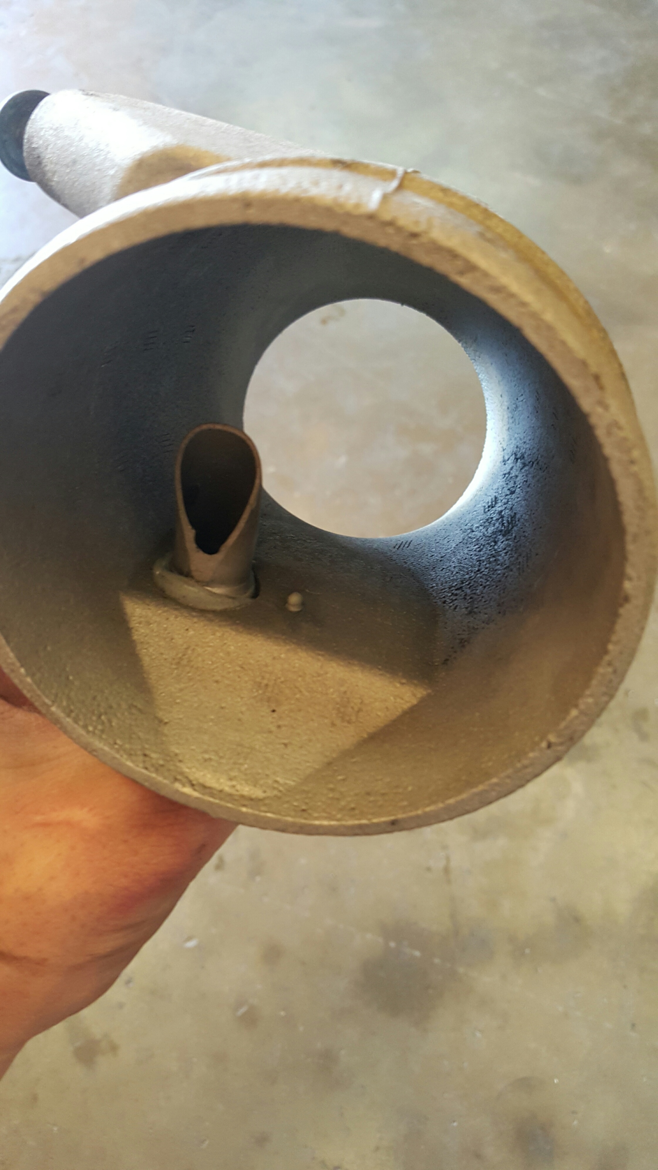

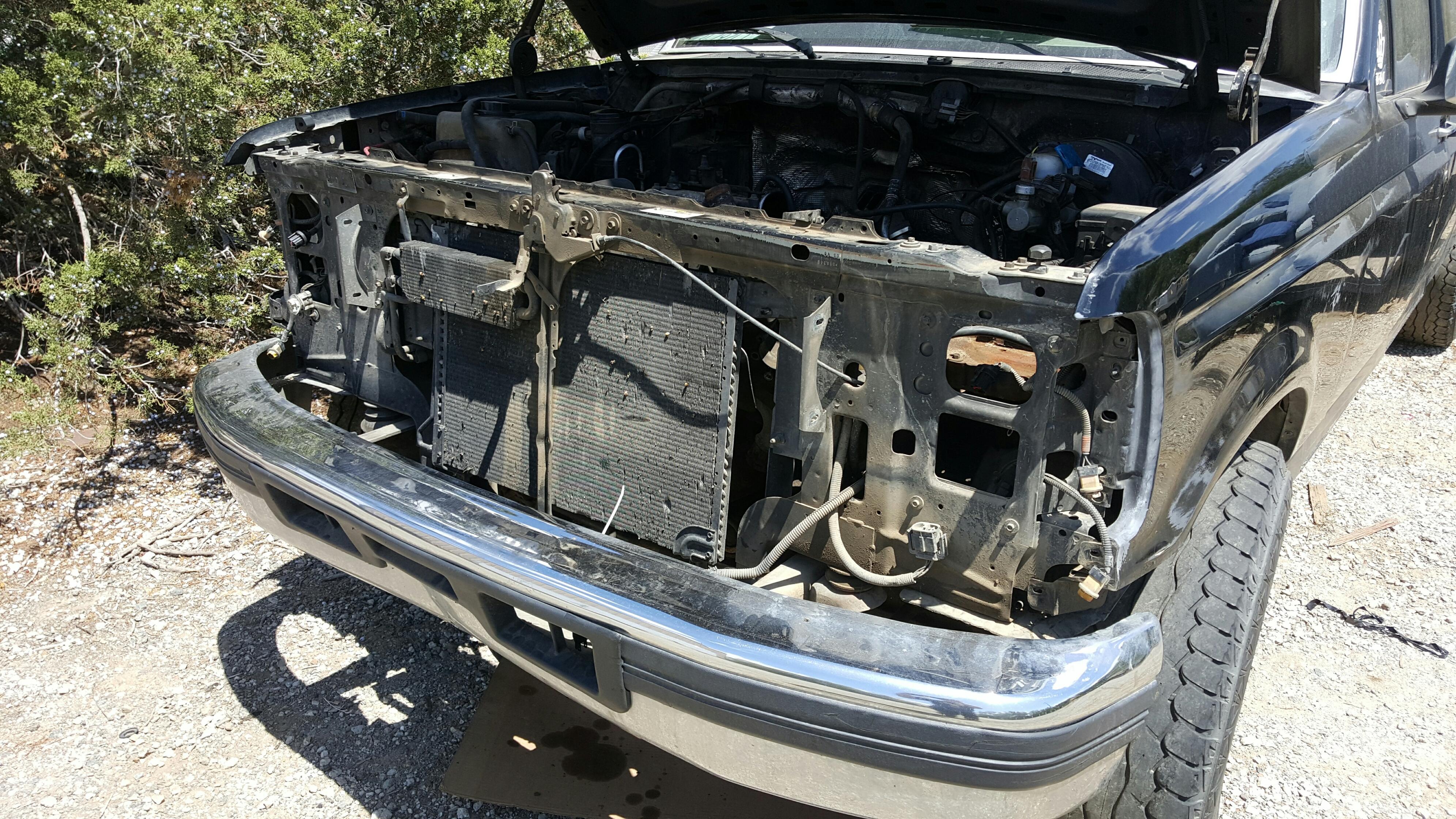

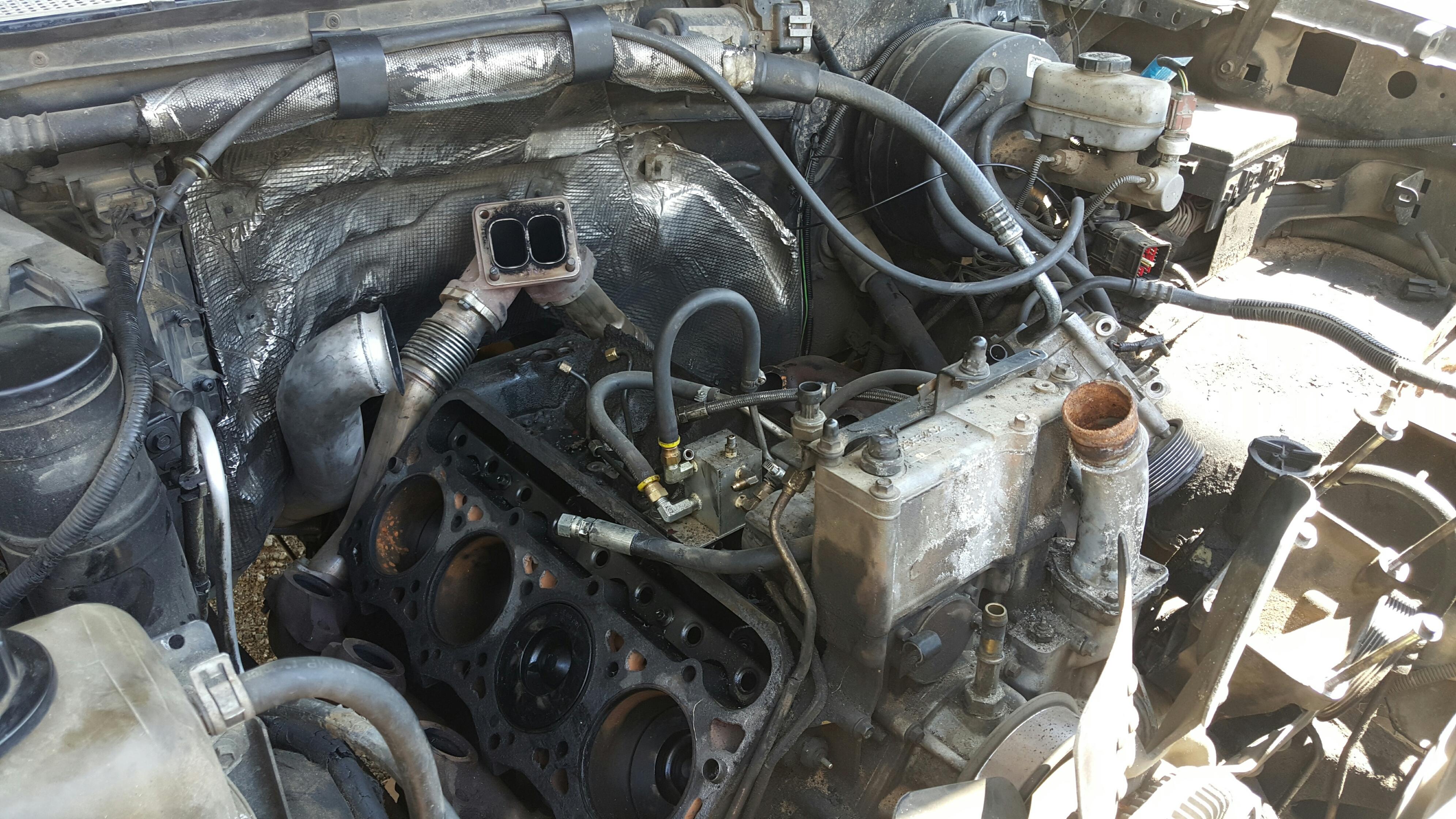

Well, i went to the shop this morning and spent a few hours on her. I removed the entire front grill/headlight/bezel assembly, found a few bolts missing and some plastic broken, so ill most likely be ordering a new grill/headlight/bezel combo. I also got the turbo out, (really easy with no heads on the truck lol.
Next is to just remove the rest of the exhaust, and then i can start pulling the actual motor. After that, a good deep clean is in order!

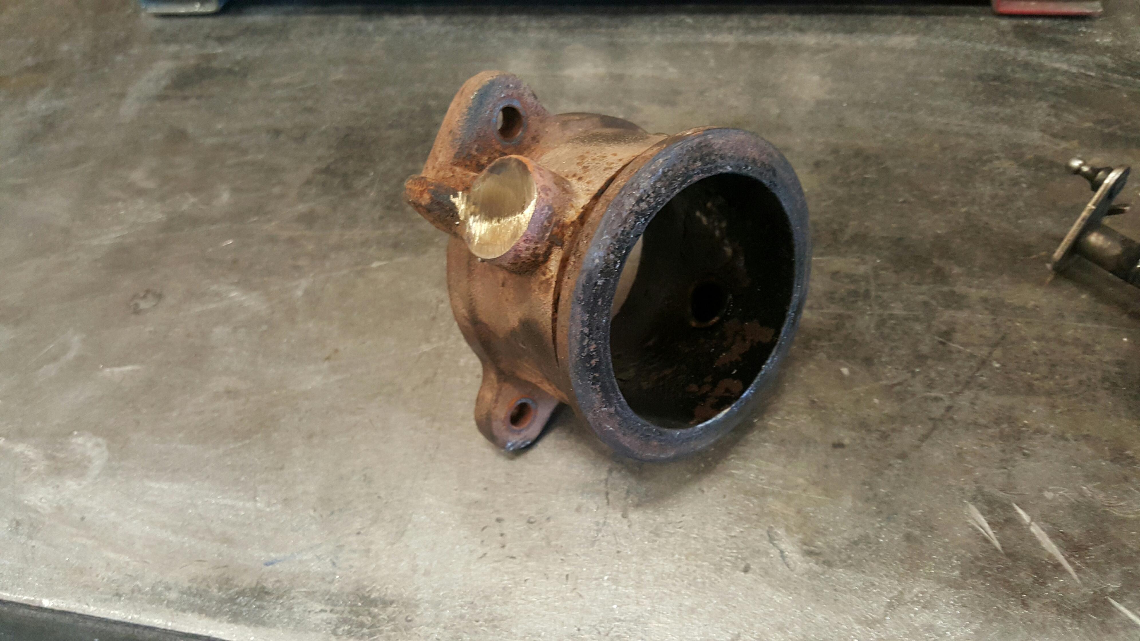

I also figured since i had the turbo apart, i would buy the blank pedestal and high flow exhaust port from Riffraff, then stumbled upon a youtube video of guys cutting the stock pedestal and doing some welding. So i figured after work at the shop i would do mine. It was either buy the parts for $250+, or modify mine for free? So i cut the pedestal, going to weld the holes tomorrow, and then took out the ebpv valve out of the exhaust housing, and welded the hole closed (instead of opting for the 3/4" freeze plug).

I also got my valve covers and intake spyder back from powder today. Cost me $80 to have them completely sand blasted and powdercoated Mini-Tex Black. I love the way it turned out!
