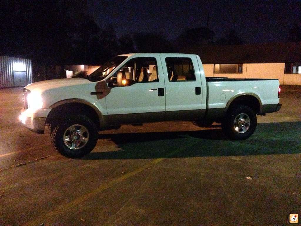

My thoughts, for what its worth... Don't black it out. It already has enough going on with the white and tan. Honestly the truck looks good now. If it were me, I'd do the HD grille with the outside painted white and the inside still chrome, paint the top plastic of the front bumper tan to match the flares (it'll tie into the rest of the tan and flow much better), ptm white your door handles, 08 mirrors with chrome caps, and it'll all flow really well and nothing will look out of place.
Get an end look in your head and work towards it. So many people don't have the vision of the final project and their trucks never flow.
You're doing a bang up job man!
I like blacked out, but I agree w/ you. I'm probably going to do something like that. I don't know about mirrors though, they're quite expensive lol. Probably try to get some 6.0 KR or chrome package mirrors.

I agree with stroker except for the chrome mirror caps and leaving the center of the grill chrome.

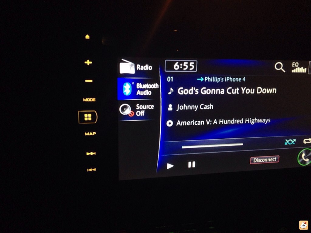

New head unit
Fx4 stickers gone.

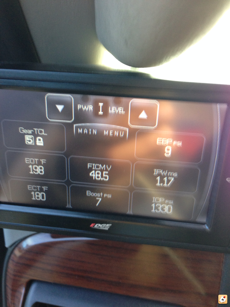

Did a couple 3/4 throttle 5h gear pulls to 100 this morning, and this is what I'm seeing. EOT seems normal, but shouldn't ECT usually be in the 190s? Mine RARELY gets there on the interstate, and usually it's 195 or less in the city. Is that about right?
Ambient temp was a little under 40° and it was at "operating temp" probably 10 mi on the interstate and it 93/109 when I left the hotel.

I haven't, wasn't sure that it may be an issue. But I've been reading that 190s is there ECT should usually be, and mine are hardly there. I've seen 201 as the highest I think, and that was in traffic. Guess I should replace the tstat and see if I NEED an oil cooler.

Other than that, she's running pretty well. It seems like maybe the thermostat is going out intermittently? Both times I've taken it on a longer interstate trip, ECT has been in the lower 180°s and EOT from the mid 190°s to low 200° so I'm thinking that my oil cooler may not be as bad as I think. Usually in the city EOT and ECT are both in the 190°s occasionally the low 200°s
