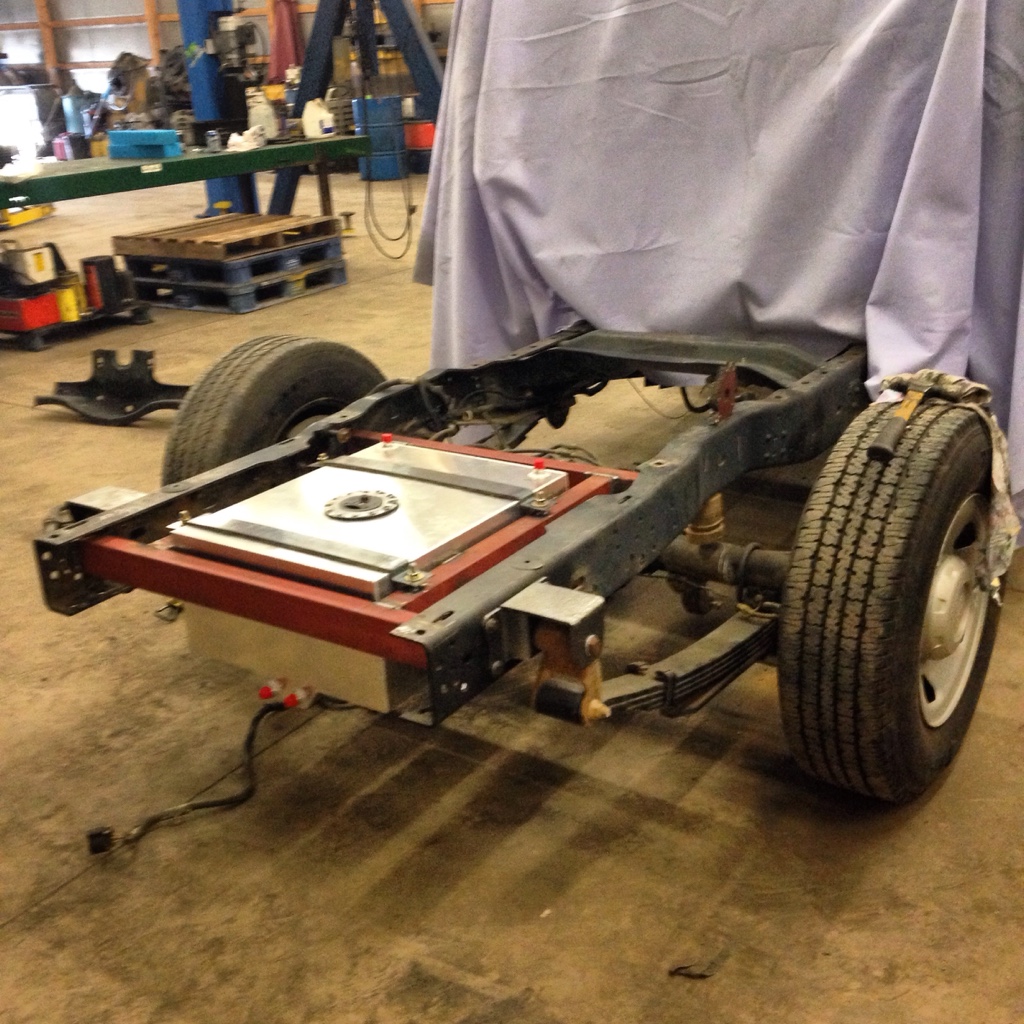

I think a fuel cell in the spare tire location is a very good idea if you are worried about traction issues.
I debated heavily during the shortening process on whether to go with a short bed tank or do a fuel cell. I kind of regret not doing the fuel cell for the traction benefits alone. Are you using the factory fuel gauge? If so, what sender to gauge interface are you using so they talk nice to each other?
Had a custom sender made by Isspro to work with the factory cluster.
Very cool! I know they have interface boxes that will convert a common GM sender to the factory cluster impedance range. But a custom sender sounds even better. Thanks for that information.
