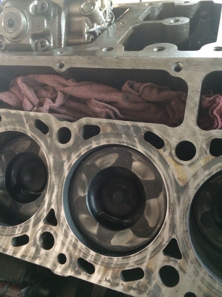

This customer had a SCT 3015 with a Tow,Street and Race file. He had used all 3 trying to get his idle and shifting to his liking. It spent most of it's time on the Street file. When he brought the truck to us for head gaskets, up pipes and a trans build we set him up with some much better tuning. He had no idea who's tunes he was running but I figured it out from his invoice from where he purchased the tuner and the paper work he was sent with it. I've been told by more then one source that he tried to copy another well know tuners files but couldn't unlock everything. Again, this is just hear say but the the pic I posted speaks for itself.
On that picture what would cause that? Timing being way off and injecting fuel outside the bowl?
Yes, the timing is advanced way to much. That's how pistons crack, the outside edges of the piston are not as thick as the bowl is and is not made to withstand the heat of combustion outside of the chamber. Advanced timing is just a easy way to get more power, but not the safest.
