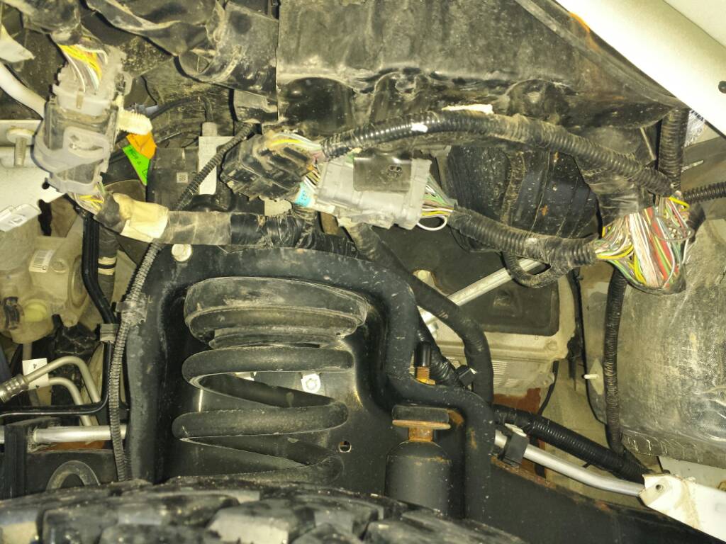

does/has anyone have/had issues with a ABS light and service anti tract popping up on the screen? got to work this morning and stopped at our office trailer and when i went back to the truck and put it in gear thats when the lights on the dash popped up.. only thing i noticed was that i might of have some snow packed in the rims but other than that, nothing!

Check the abs harness behind the driver side fender liner. There has been occurrences where the wire was chaffed in the wire loom.
It could defiantly be the snow. Some guys had issues when it would rain.
Do you have any codes?
ok. thanks man! ill check it out.. i kinda like not having to push the traction control button all the dam time though! if the stupid warning wouldn't come on or abs light then i would just leave it... lol

lots of wires behind fender liner.. holy crap..

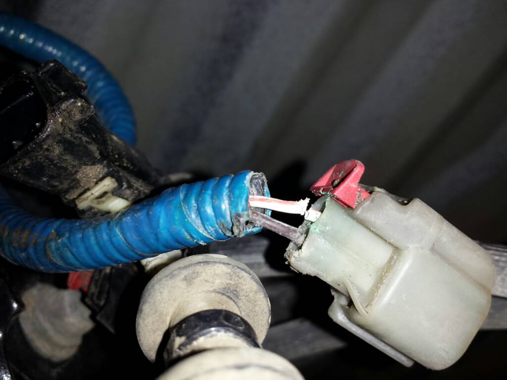

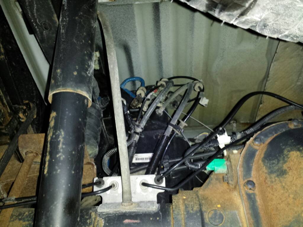

my hands where froze so i didn't dig into the wires and i went back to the rear axle to pull the sensors and clean the connections and found this..
for some reason, my torque app was reading that the left rear sensor was reading 0mph all the time but that is the pigtail for the right rear that broke.
anyway, i rigged a couple small female connectors to fit inside the male sensor side connector that atleast let me figure out that it fixed it so now i need a new pigtail and connector from the main harness to fix it propper...
live life full throttle
Glad you got it figured out!!
