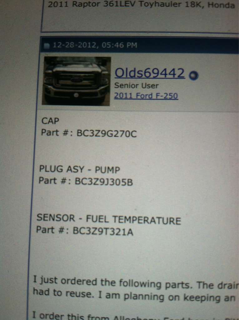

Be very careful when removing the fuel filter bowl on the frame rail. I sheared the nut right off off the bowl when I was loosening it. Here are the pat numbers for the bowl, sensor and plug if ever needed. I bought 2 of then. $23 each. Always like a little insurance.
just by taking it OFF? not while over tightening it?

Yeah I got about 3/4 of the first turn and it then sheared and proceeded to dump fuel on me.
