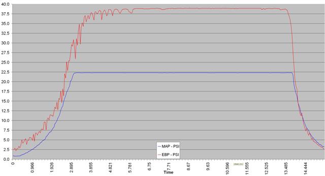

Holy crap... That's what I get for going over the datalogs at midnight. My numbers are off. The Boost was GAUGE pressure (as indicated by the video of the boost gauge), but the EBP numbers I was looking were ABSOLUTE values. Compensating for a BARO offset of 14.3225 PSI, the backpressure numbers were actually around 37-38 PSI stock and 38-39 PSI with the new wheel. This means the corrected ratios were 1.226:1 for the stock wheel and 0.907:1 for the new wheel.
I apologize for my miscalculations. Not to often I make such a blatant oversight. :morons: However, it still does not detract from the fact that the new wheel is extremely efficient.
Here is a graph of the (corrected... :D) drive pressure vs boost. Unfortunately, since this was pulling directly from the MAP sensor for boost, it can only read to around 22-23 PSI which makes it rather useless for reference. I'm trying to fit a 100 PSI pressure sensor to the truck and correct the MAP table so that the datalogs will be more useful. At that time, I'll also be logging MAT sensor output to get a clearer idea of what the inlet temps are.
(Click on image to enlarge)
Once I get the new sensor installed, more data will be forthcoming. :D

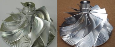

If you're comparing the eBay wheel to the Wicked Wheel for the stock Garrett turbo, no, they're not the same. Also, the eBay site indicates the wheel in question is for a GTP38, in which case it is COMPLETELY different than the GTP38 wheel DieselSite designed. (See attached image) DieselSite's wheel for the GTP38 doesn't use the 5 on 5 fin design like the eBay wheel or the wheel for the stock turbo.
I figured that is what you meant. I just wanted you to clarify.
With backpressure numbers that low, I don't see how this wheel wouldn't let someone safely run more fuel on the stock charger. I would like to test the
38r wheel on my d66 when it's ready.

The ebay wheel looks like a bad copy of a gtx wheel. They missed the backsweep about half way down the fins so it will more than likely reach the choke point sooner.
