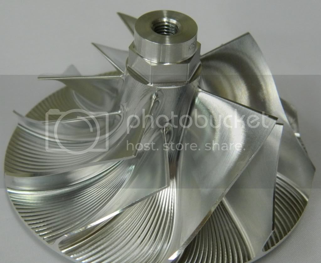

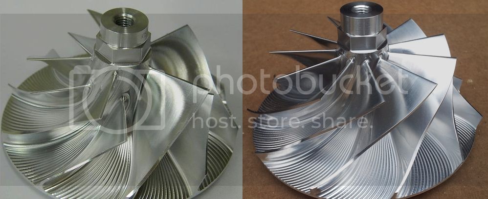

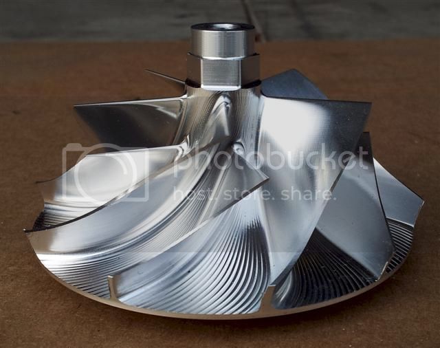

Bill, maybe I'm blind or something, but by what I'm seeing, you posted a completely different wheel when the link to the ebay wheel was posted. I'm not trying to start anything and I'm not even the slightest bit interested in this wheel, I'm just wondering if that was a mistake? Or does Bob have two different wheels? If he doesn't have two different wheels, which wheel is in your truck? Here is what you posted as the WWG2 in the original post..
Then here is the comparison to the ebay wheel that you posted in post #63.
This is the picture I just got from the ebay auction, so the ebay pic is on the left in your comparison. The wheel on the right in your comparison is different than the picture in your original post.
Am I missing something? LOL Like I said, I'm not trying to start anything or even interested in buying either one of these wheels, I'm just a little confused by the pictures that have been posted. Maybe the ebay seller changed the pics of his wheel or maybe you just got the pic mixed up with a 38R wheel when you compared the two. I don't know, just wondering.
