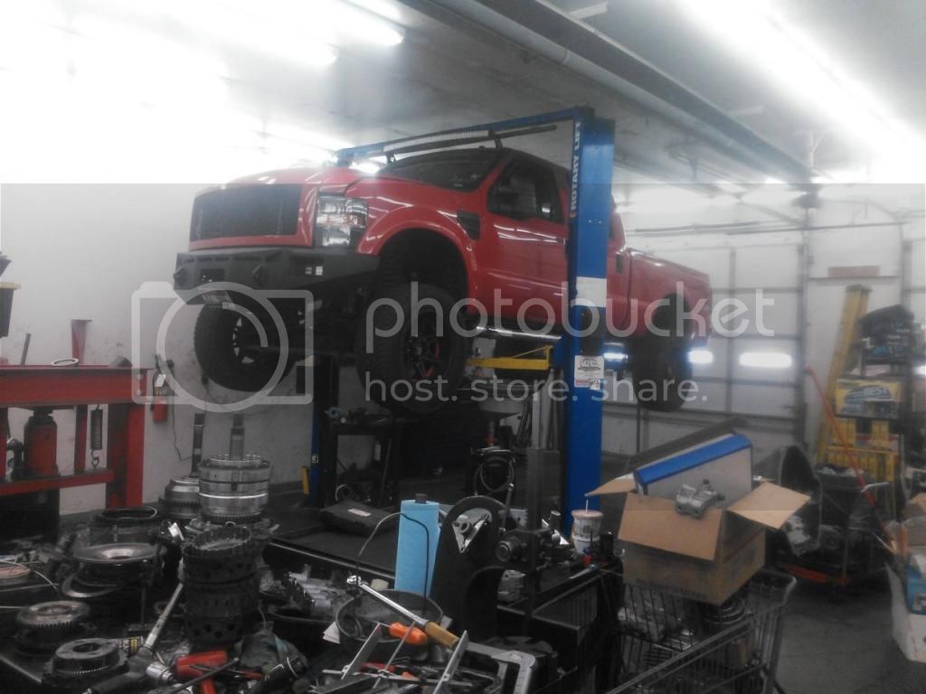

Drop the truck off at 630pm for the trans :redspotdance:

Will do. Rear main was leaking so had to fix that first. I have huge faith in Ultimate Trans, his work is awesome and attention to detail. We use him on our duramax trans builds and 90% of our dodge builds. No stranger to building a trans; local cummins living one by him with 1500+ hp to the ground and many 800+ hp builds under his belt with allisons, dodges, and torque shifts and 4r100's...plus it comes with a warranty....3yr/100k. I know it's in good hands. :thumbsup:

No more flared shifts! Thing holds gear like it's nothing. Now just load up the new tune and see how she does. So far, night and day difference. :rockon:
