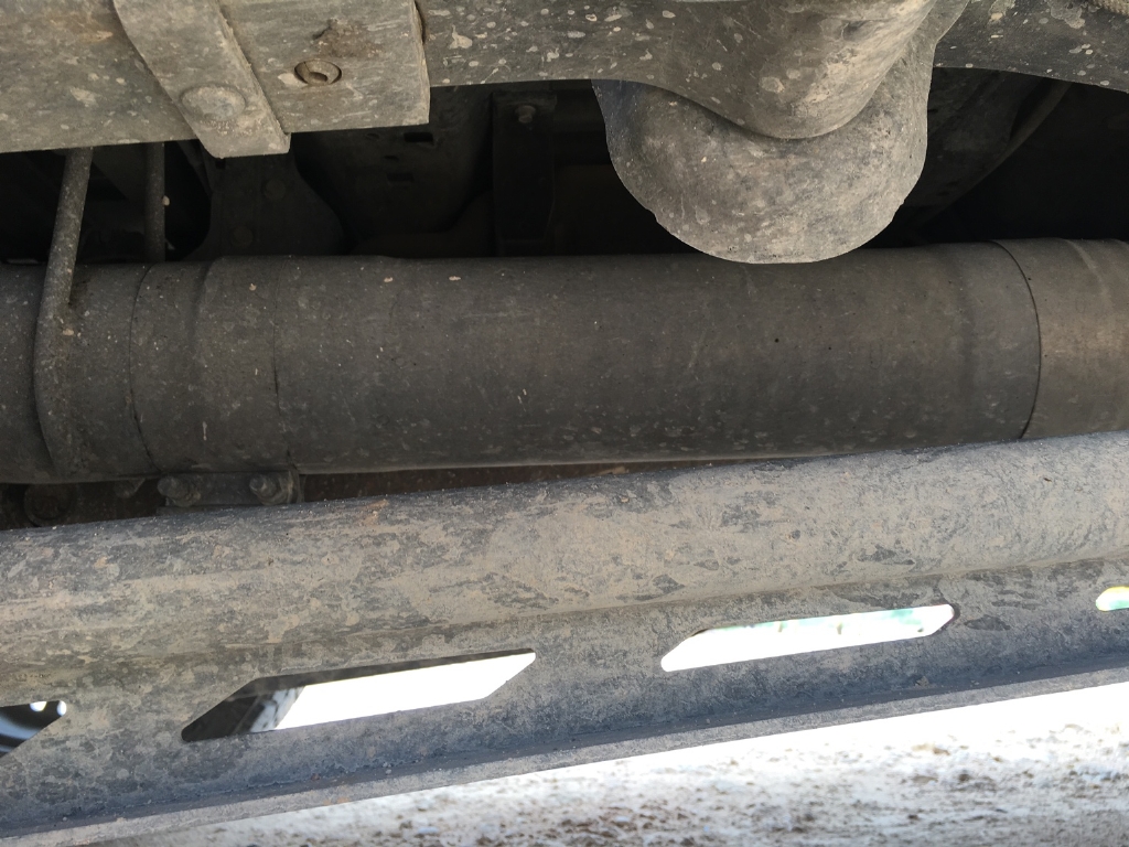

It fits almost perfectly where the flo pro piece is before the axle where the flo pro muffler would go. My exhaust actually fits better with the resonator in since its a couple inches shorter than the flo pro piece. I've got to get my exhaust just right so it's not vibrating on my B&W gooseneck frame.
that's the best picture I can get right now. But that piece comes out, resonator goes in.
I have to take the rear part of the exhaust all he way apart to do it. I think they say the closer you get it to the downpipe the better it works but I wasn't about to cut up my exhaust if I knew I was going to be taking it on and off. Works perfect for me.

The resonator is supposed to be installed as far forward as possible. This is to achieve breaking up the sound wave as much as possible under the cab. And leave you with a rich tone out of the tip.

Yea, but it works where he and i put it to pass a visual inspection in the event that you need to do that. And it still works to eliminate some of the drone.

Go study sound resonation.
Regarding sound waves. It's like a guitar string. Stopping the resonate frequency before it gets to far down the line. Which would be stopping it as far forward as one can.
This is not a rear exit muffler. It's a resonator to kill frequency. The spiral design of it matches the the wave length to knock out the drone. Which is why you put it as far forward as possible for cab noise reduction.

That science stuff is all good and dandy and i do know that a resonator is not a muffler. However I can tell you from living in a state that requires a muffler on vehicle during a visual inspection, that this will pass for one from a visual standpoint. Most don't check anyway. And since i had drone in my cab before I put a resonator in the muffler location, and I don't have drone now, I can say that it is still effective in eliminating some of the drone, even in a further downstream location.

To each his own. Just didn't want anyone thinking the ideal spot to put a resonator was in the mufflers location.
