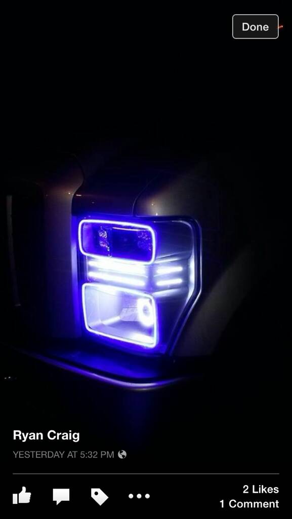

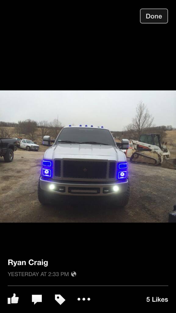

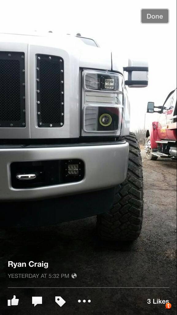

One of my buddies sent me these, this is of one of his buddies trucks. Look pretty slick, I believe the upper portion has rigid duallys
