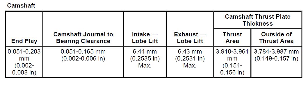

I agree something dosent add up. .015 doesn't sound like to much end play but I don't remember the spec and it may be moving more than that under a load. I have never had a sensor that would hit the cam gear with out the engine running how many shims did you have to put in there to keep them from rubbing? I usually set the gap to .020

That doesn't make sense. The air gap is like .025 iirc.
your telling me!! that is just wacky!!
yeah, this thing keeps getting wierder and weirder... I wrote down my measurements from the block to the gear each time I did it and like mentioned, I prolly didn't get spot on even every time.. but I can see that being under load would make it worse..
the sensor has to have been rubbing this entire time that it was only running 3500rpm.. I put enough shims in to clear the 1.113" measurement at 1.10" from the tip of the black cps to the spot where it hits the block and drove it around. while still trying not to boost the chit out of the fresh headgaskets I put it in my dd tune(first time in 4 years its been outa the hot tune) to keep boost mild and a lil more controlled and put it in second gear to slowly build the rpms.. it creaped past 3500rpm and when it hit 3800 it stumbled and the cel popped on. BAM cps intermittent code.. cleared the code and did it again, just barely hit 4k rpm this time and BAM cel with cps intermittent again.. so either the cam/gear is moving to close again and the .003" of an inch isnt enough or it is walking away from it and creating more of a gap... so tomorrow I am gonna add another shim, which I think I am at .040 now, and see if it gets better or worse.. the shims I have aren't perfact. I think I measured the thicker ones at 11 thousandths of an inch and the thinner ones at 3 thousandths of an inch. but I can't remember right now exactly what they where...

I spaced it to far. I only hit 3k rpm when it popled a cps code.. so I sat down with my numbers and did some fine, very fine measurikg with the calipers and I have tthe shims set, as long as its not moving more then what I measured in and out before, to go from .003 at the closest to .023 at the farthest and drove it some more and I can get 4000 to 4200 rpm now before it pops a cps code and runs like dog chit. hopefully it stays that way till I can tare it down this winter...

good question.. either the cam gear isn't welded like it was said to be or the cam is wlaking in and out.

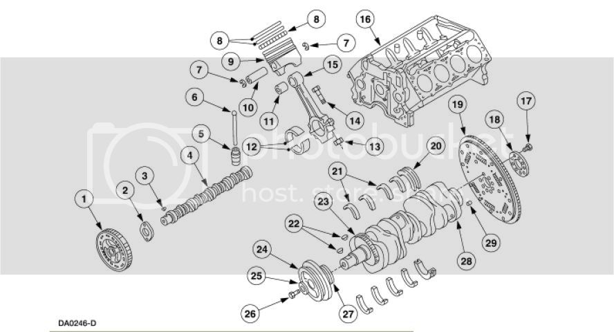

Unless item 2 is failing... It's gear walk.
I'd be careful how much and how hard I drove it until I got that gear reseated and welded. You can cause a whole lot of stress via cylinder pressure if timing is all over the place.
Chvyrkr
2,205
And it's entirely possible that the thrust plate (item 2) is worn, allowing end play. Can't say I've ever heard of anyone finding one worn, though I'm sure it's happened.
im guessing thats got a lot to do with me blowing both headgaskets a week ago...
my luck is that all 3 are happening at once... lol
