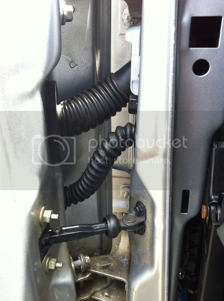

Did the work and this is what it looks like.
jdc753
2,289
Norton, MA
Very clean looking!!

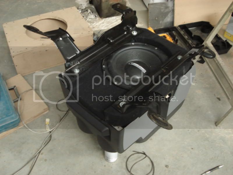

12" SI Mag V4 worked into the 08 console, still with plenty of storage
