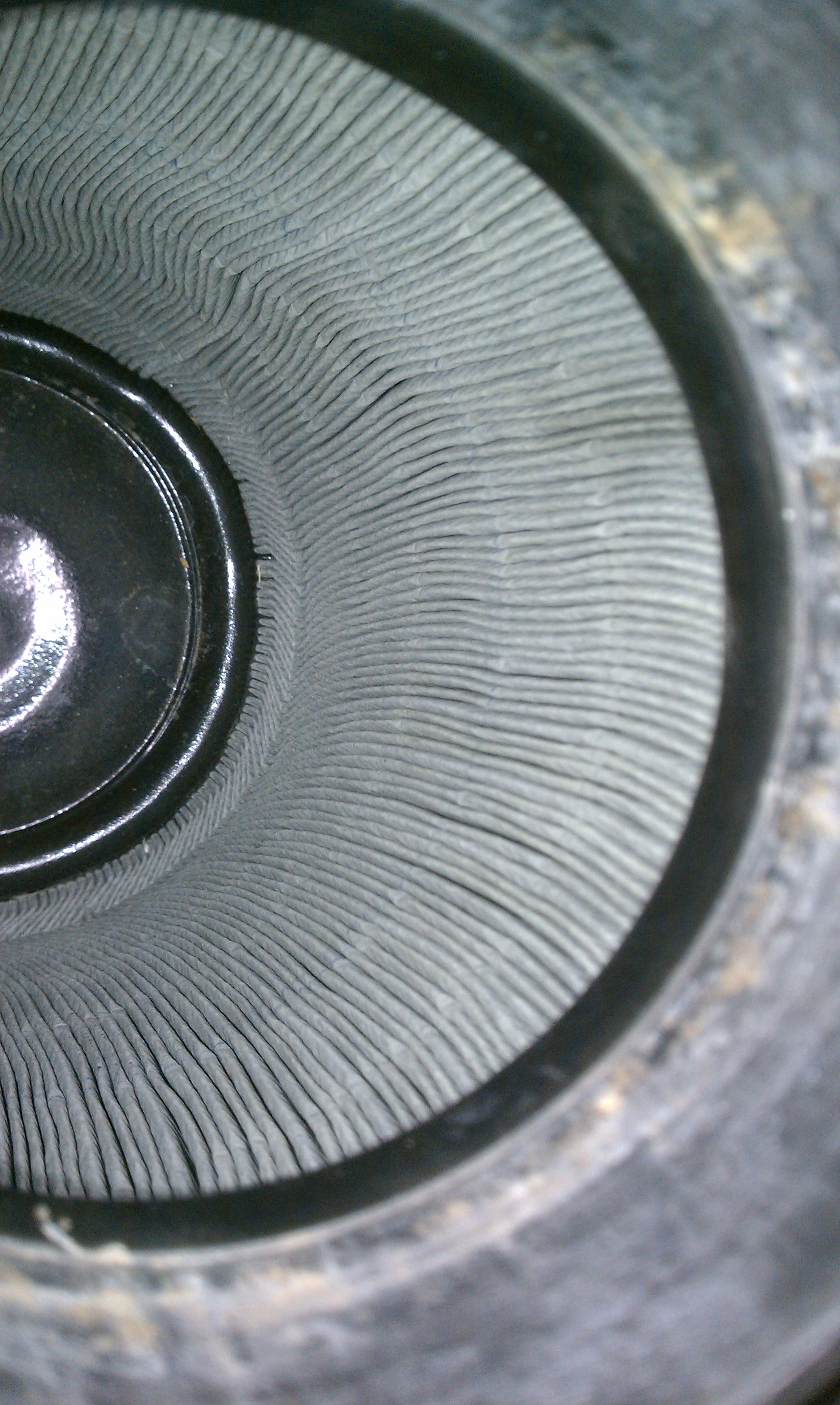

One of many, I have never seen a collapsed filter.
This one in particular saw 60 psi the day it was removed. 30k miles on this filter.
I am not arguing whether or not this filter flowed enough air at this point. I'm simply wondering about this collapsed filter phenomenon that I've never experienced.
