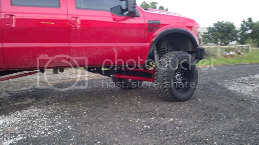

I would recommend our short arm 4-link or any 4-link that uses heims only for customers looking for every ounce of performance out of their frontend and every possible elimination of wheel hop. Some loss of street driven ride quality will be experienced due to the heim joints. They have no ability to isolate or dampen road impacts. The geometry of our kit is designed specifically for lowered to 3.5" lifted heights, nothing higher. The geometry between our kit and RCD's is very different, so dont compare our specs to theirs. A couple points to our system and I dont know how that compares to RCD's, as I have never seen their specs or kit.
Heims: 1.25" QA1 (76,200 lb static load capacity)
Tubing: 2" OD .250 DOM
