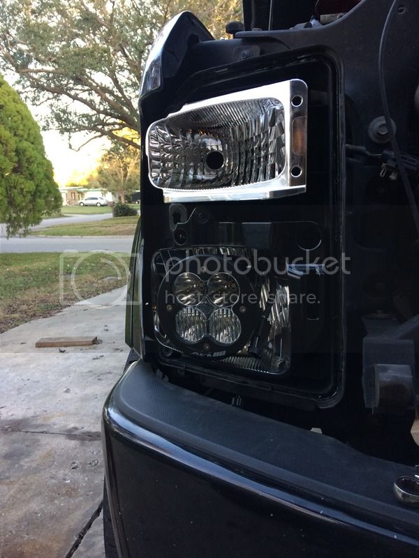

Details on the headlights?
I had a spair set of factory housings so I'm going to retrofit a set of Baja Designs XL80 driving lights in. The hard part is going to be controlling the hi/lo feature since it is backwards on the Baja Design lights as in when you first turn the lights on they are at 100% and then you can switch them to 50%. We'll see...

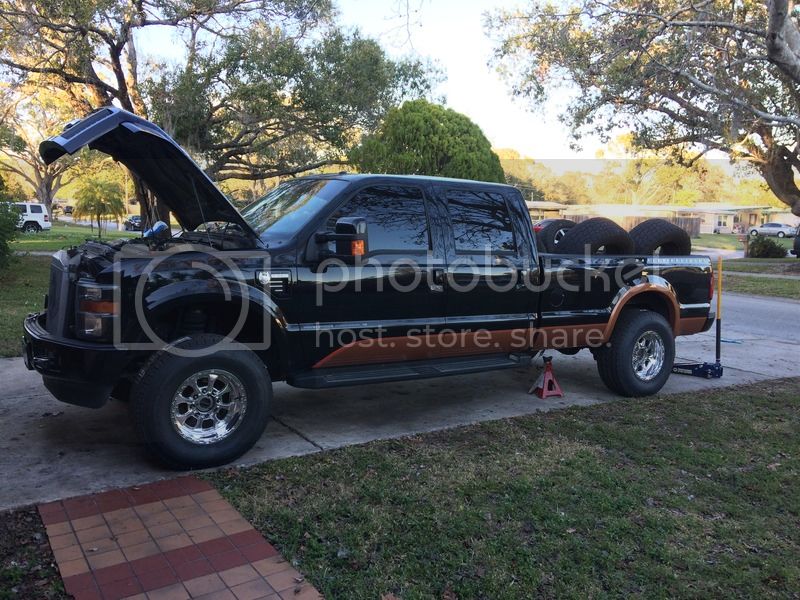

Dear cab pullers. Please be considerate in your fastener placement (I.e, positioning an allen screw with the head facing up into the firewall in a way that there is no possible way to get to it without pulling the cab). Thank you......
