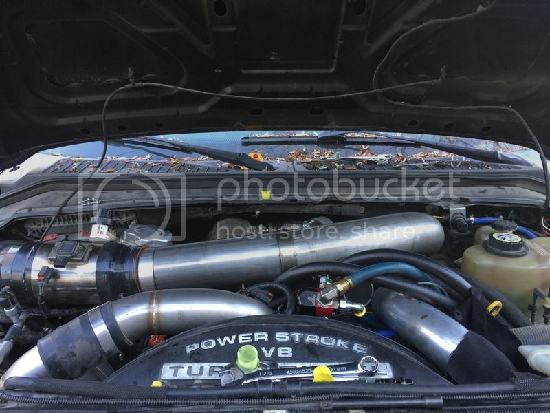

Getting close.
Jonnydime
Jun 26, 2012
2,322
8
Had it running today but still have some small things to finish up. It is definitely going to need a muffler.
Jonnydime
Jun 26, 2012
2,322
8
It's big and silver and round. And I bet it gets hot.
Hopefully it doesn't get that hot. I'm going to try to reuse it as an intermediate pipe for the compounds when I build them.

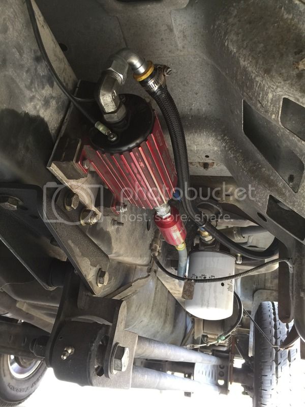

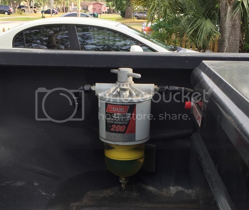

Had to get creative with the low pressure system. I didn’t want the water separator as close to the ground as it was on the red truck so I relocated it to the bed.
Lipka101
Feb 2, 2014
586
Maryland
Interesting, there was no way to move it up like the other filter or is the Seperator that much bigger?
Sent from my iPhone using Tapatalk Pro
Jonnydime
Jun 26, 2012
2,322
8

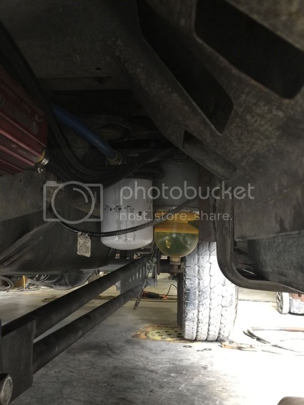

After some consultation I am moving the water separator back to the suction side of the pump on the frame rail. Turns out Dahl doesn’t recommend pumping thru their unit.

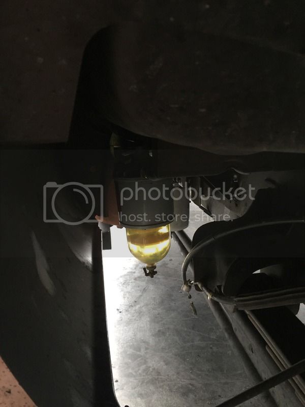

Setup number 3. Hangs about 2” below the bottom of the bedside which is about 4” higher than it was on the red truck.
