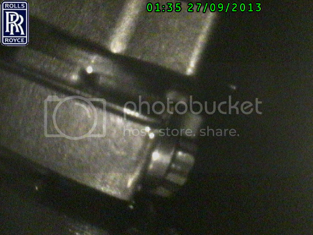

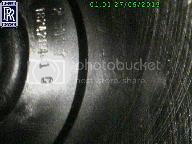

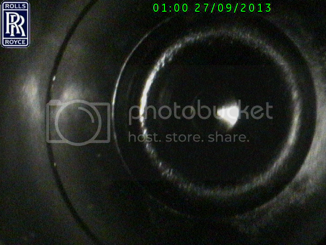

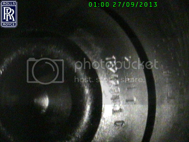

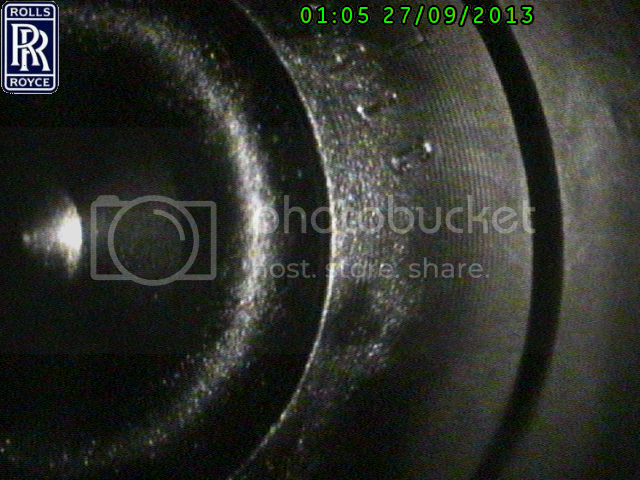

So I snagged the borescope we have at work. Pulled the glow plug out and shoved it in there! Piston looked fine in my opinion. Looks like my spray pattern at some point in the past got a little out of control! Cylinder walls looked good as well. So WTF?!! I pulled the push rods and rolled them on a flat surface. No wobble wobble action. Again....WTF!! Anyone have any ideas or an arrow to point me somewhere?!*
For the heck of it, I thought maybe, just maybe that there is a .01% chance that I might have forged rods! So I pulled the plug and took a peek! No dice!
