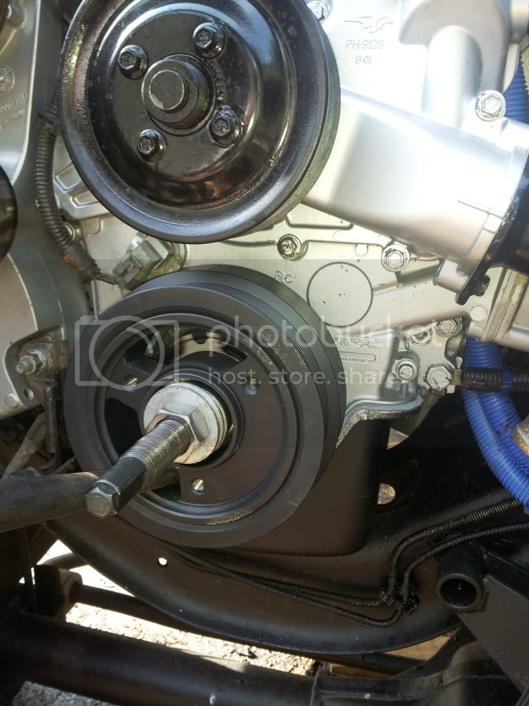

But....I did some work for a buddy of mine and my new valves should be here in the next few days for my heads at the machine shop. Then my forged rod motor can go in. Took me a few hours to get the front end disassembled. Wasn't to bad at all. An 8mm, 10mm, 13mm, and phillips! I'm really curious to find out what caused my drop in compression. So far one snag, my pulley puller sucks! Can't get my fluidampr off. Can anyone recommend a good one? So here is where Im at so far. Definitely upsetting looking at it like this!

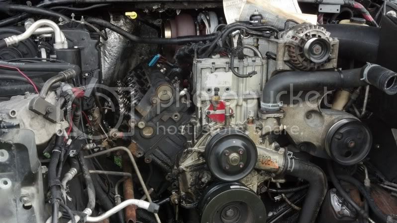

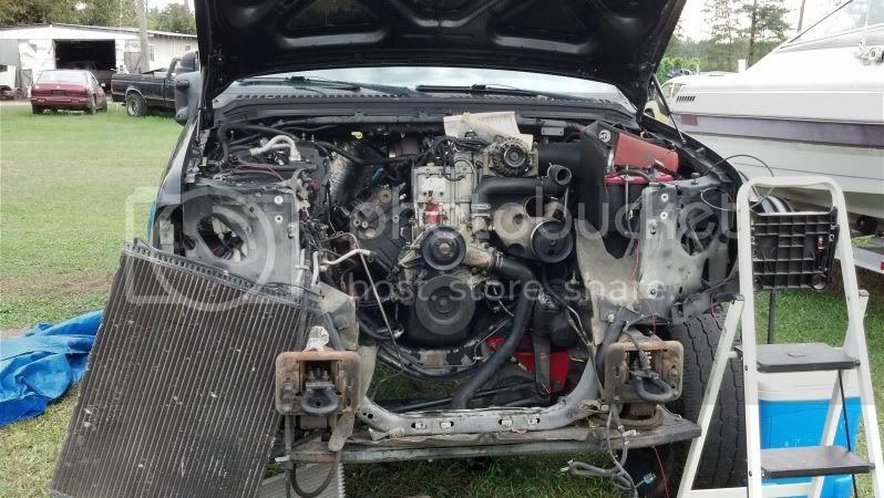

LIES!!! Truck looks terrible!! It hurts me to see it like this!! Hopefully it will be out this weekend. Just have turbo, transmission bolts, torque convertor, and drivers side components. Really getting anxious to see the bottom side of the head.

My pulller has a foot that is a Y shape. Run the bolts into the damper bolt pulling holes, tighten the jackbolt, and the damper walks right off. If you are trying to use a claw or grabber style puller, dont. Be sure you put the pointed end on the jack bolt or you'll ***k the threads up in the snout of the crankshaft. Then you'll be chasing down a tap to clean your threads up. No fun! In fact if you google the tap size for the crank snout you'll come across people who have stripped theirs out on a forum looking for help.
Also buy some washers that will fit on the installer,inside the dampers bore. This will alllow you to have adjustability in pushing your damper on. It tends to keep that bearing most installers have from getting crushed or side loaded and pushing your damper on crooked.
Take your time.

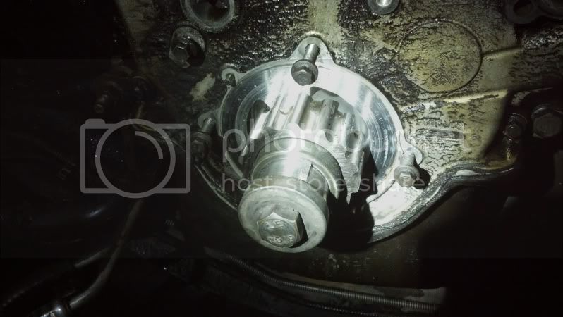

Thanks Ty! Got it off yesterday! Had to use a buddies puller. The one I had was a POS from AutoZone. Took a few taps with a rubber mallet but it came off. Woodruff key is stuck and my LPOP wont come off. Just the inner gear.
Got the trouble head off and sure enough, the head looks fine. I'm beginning to think it was a lifter issue. So whoever mentioned that, come pick up your prize! Took one apart and don't really know what I'm looking at or how to see if it is bad. Motor should hopefully be out tomorrow though. I'm actually having a good time taking the truck apart!

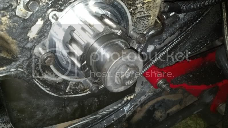

I never remove the woodruff key. Int'l puts grey death on them. If its still holding well, leave it. As for the body of the lube oil pump. Get a scraper and a deadblow mallet and once you pull the bolts give each corner a sharp rap with the mallet. Then work the scraper in. If you can tap the bent end it'll get behind the body.
Like this:

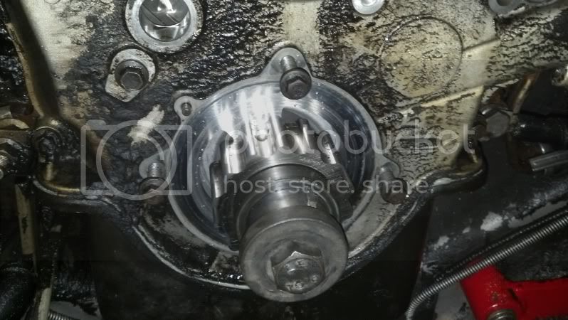

This is where I'm at.....no the bolt and washer were not installed when I tried taking the inner gear out! I put that there so I don't lose it!

Why the hell wont it come off? It should come off by pulling with your hand. There is no puller for that. Did you buy one of those scraper/prybar deals? The.bent end would probably help.
It should NOT be that hard to remove or install!

Beats me man! I put something similar behind it and tried to pry it out. No dice! I messed with it for about 20 minutes and then prepped the rest of the motor for removal. It's hard not to mess up the front cover. Yeah, that thing is on there. It slides on and off a little more than a quarter inch. Sounds like its hitting something.

Hitting what, I wonder? Theres a flat in the crank that aligns the inner gear. Look for a burr out near where it seems to stop.

Like something solid. Tried a big flat head and pryed on it, no joy. I have a new Melling going in the other motor so I could care less about this but I don't like things like this getting the best of me! It's almost like that sleeve on the crank is affecting it.
