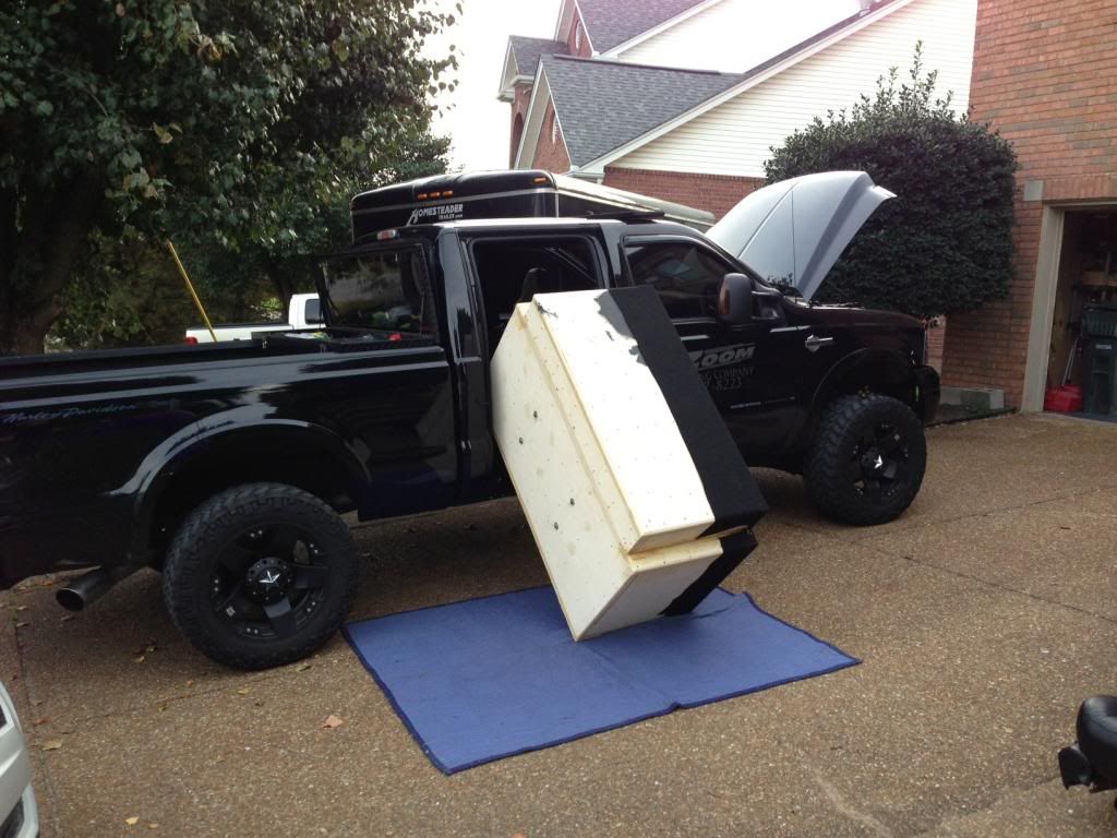

Figured I would wake this thread up, I build and do all my own installs. Here is my 07

Dayumn!! I would have never expected to see a wall build on this site. That looks awesome!!
18" BTL's I am guessing? how much power?

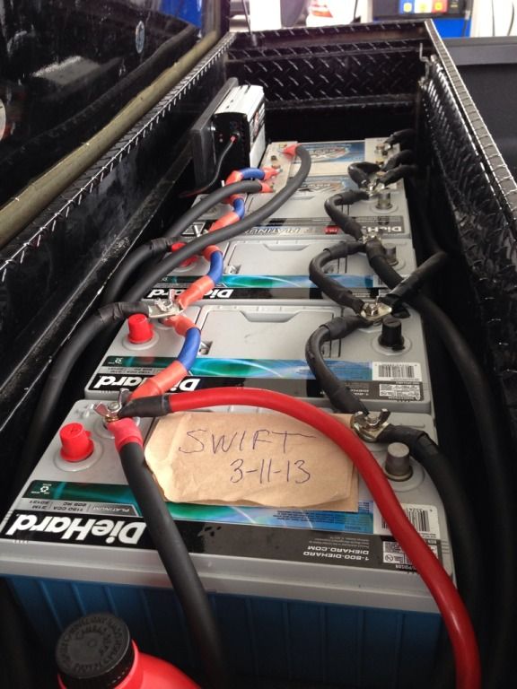

18in SP4's on two Crescendo BC5500's strapped at 1.5 ohms. Subs sere seeing around 12k. Powered by a Mechman 370amp alt and 8 batteries. Truck was brutal doing 158db's on music.

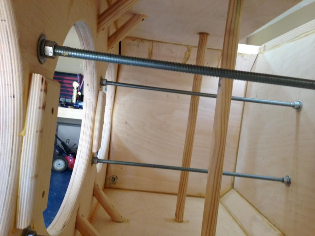

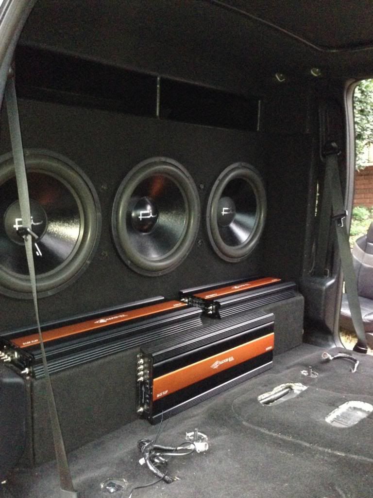

Here is a couple more pics.

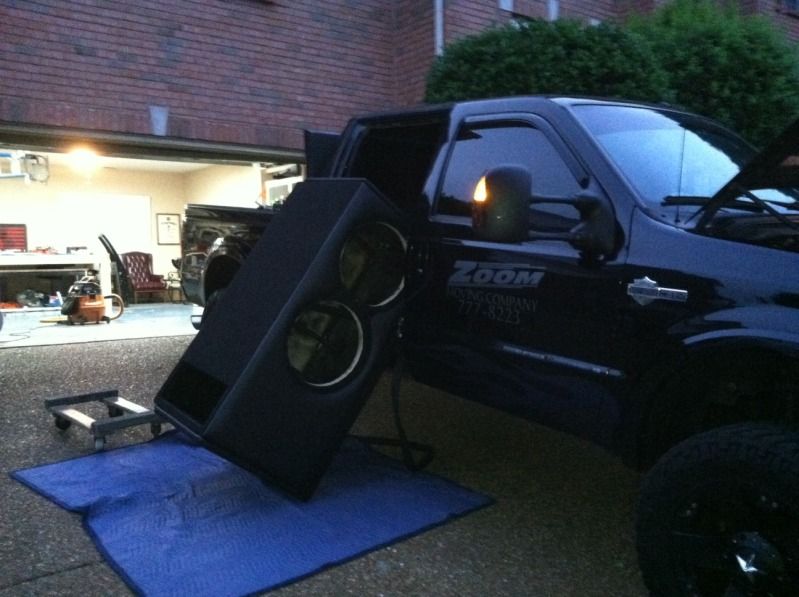

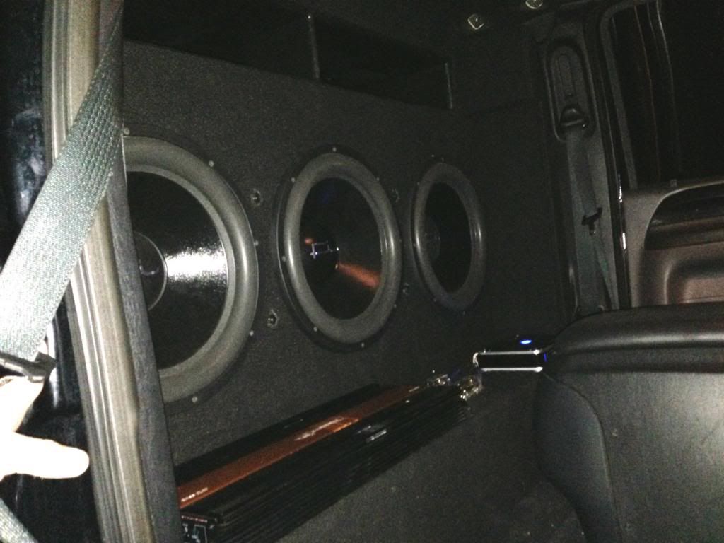

Here is my old setup when it wasn't walled with 2 18's. This was nasty also

I love it!! Great bracing on that box, and sure moves some air. Most people think 130+ on music is too loud, but 158 is very impressive.

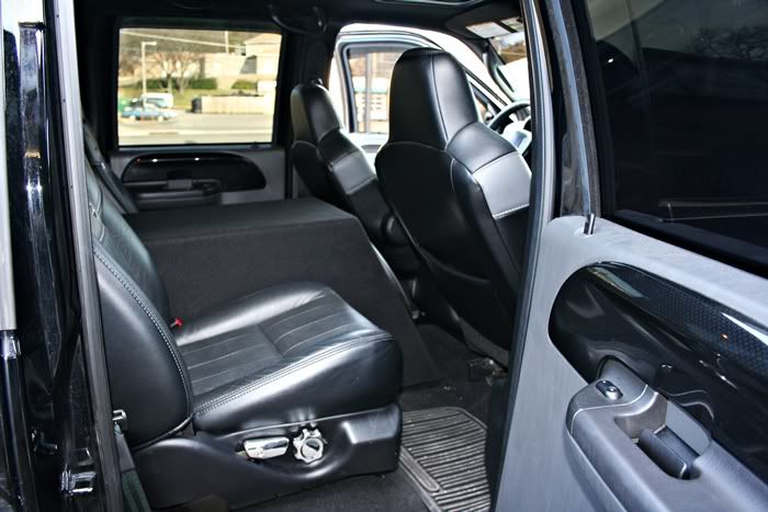

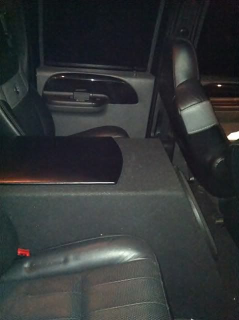

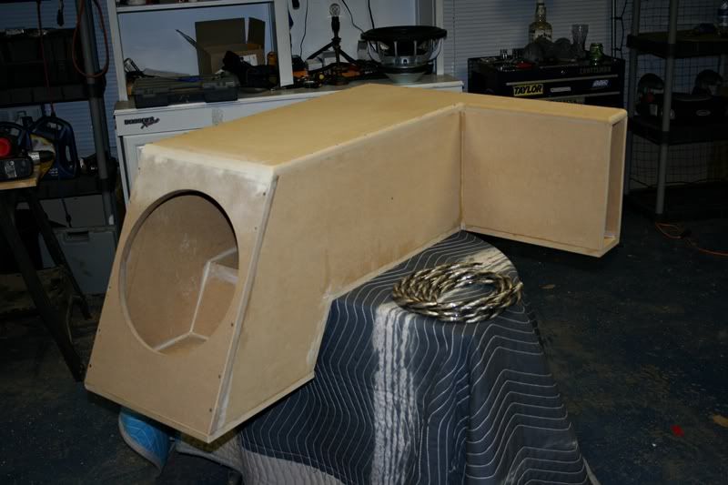

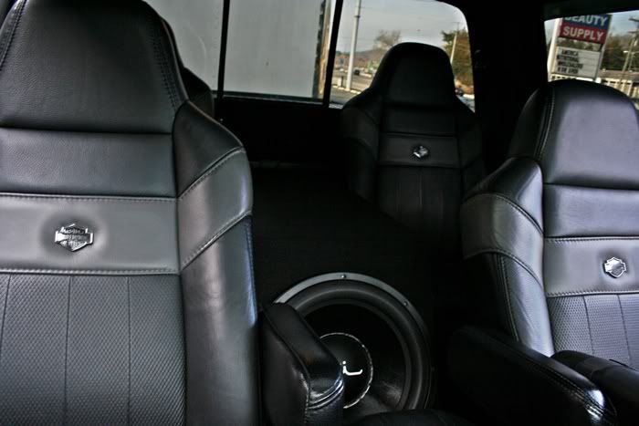

Here is the center console I ran before going big. This was between the captain chairs in the back.
Port runs behind the seat on drivers side.
3.6cu net tuned at 29hz

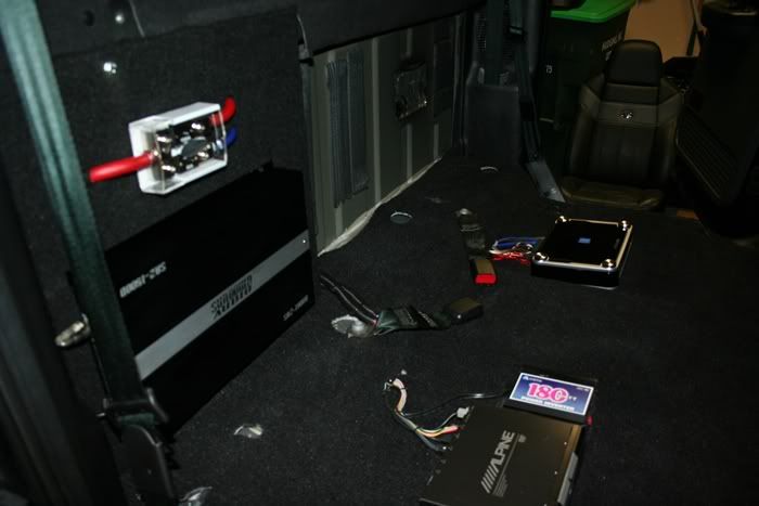

Amp rack behind the seat

SWIFT that is bad ass. How did you concert to captains seats? Are they out of an ex?
