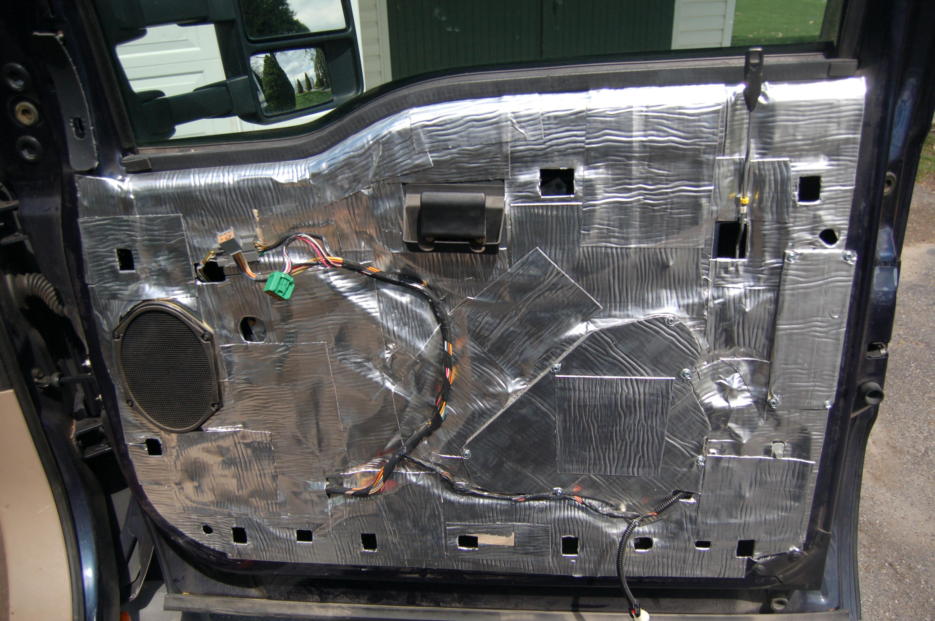

The only picture I have at the moment is of my doors...

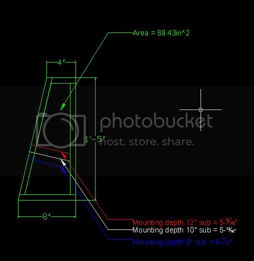

You could easily fit a 10" or 12" sub in there...looks good though.
Yes and no, there is plenty of height but depth is limited and fades fast as you get bigger on the sub. You'll rule out 75% of the 10's available on the market and limit yourself to pretty much only shallow mount 12's
This picture is actually a bit deeper than an 04+ truck will fit as the top really can only be about 3" and not 4" and top depth plays a big role on how much depth you can get away with, plus leaving room for the sub to play freely and some for the pole vent if it has one.
Very nice!!! :rockon:
Now that you went through all that work its time to pop out the crappy stockers and install some nice speakers in there so you can get some life in your music
Thanks man. I wanted to be able to still have 100% use of my back seat area(I have two labs). I will snap some pics of it installed.
I forget the depth of that speaker, but I want to say it was not greater than 6". I'm pretty sure I could fit a newer, larger shallow mount speaker in there, but I am going to stay with an 8". Like I said, Classy LOL

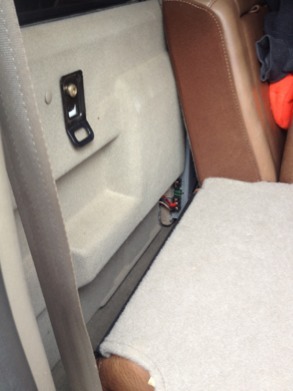

No amp on the floor and still have space behind the smaller seat.
Definitely a good use of the space, always nice to get the stereo in there and not even know its there.

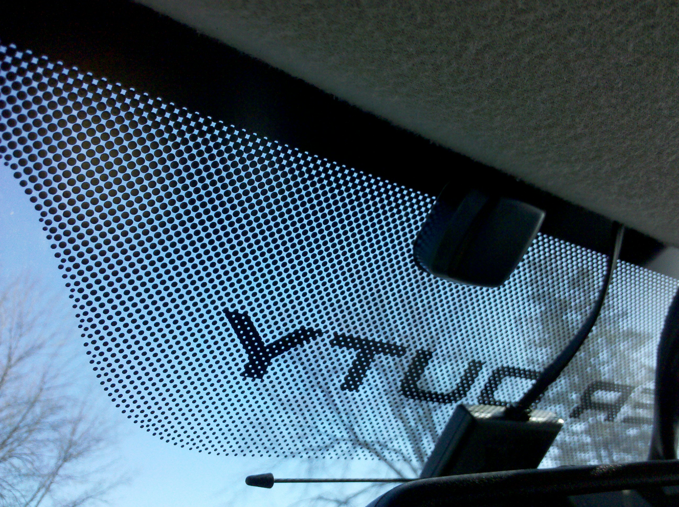

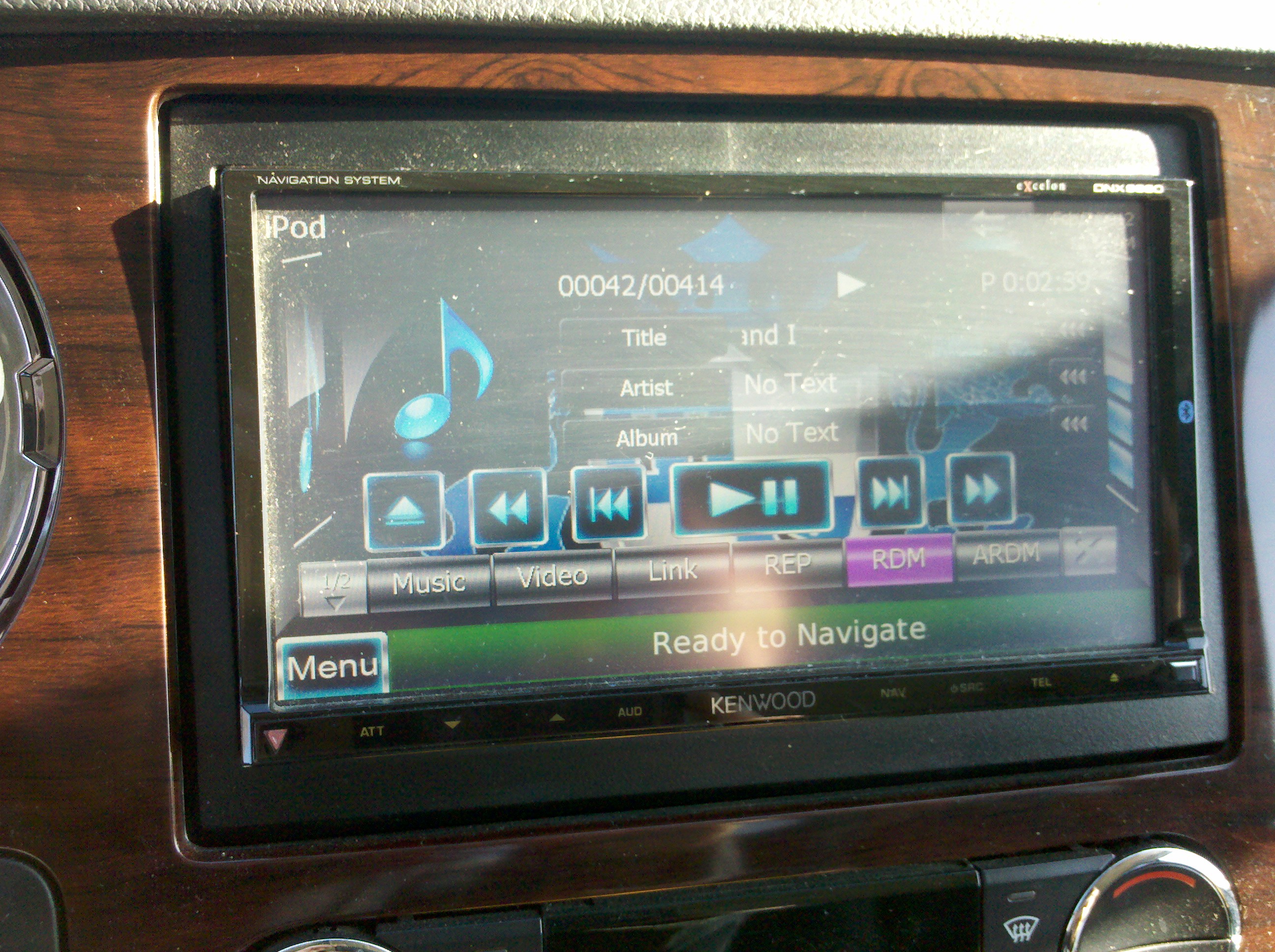

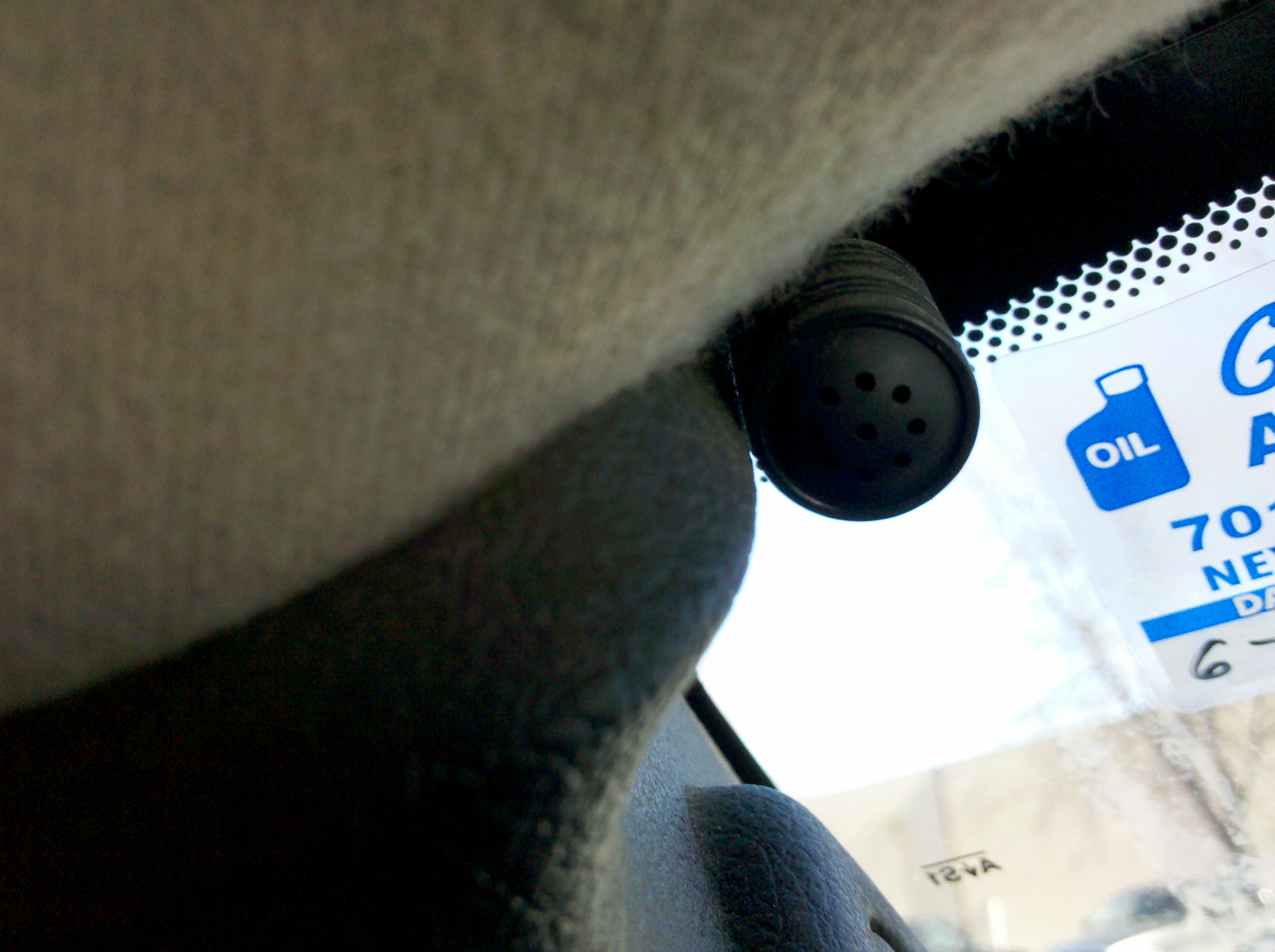

took a few of my Kenwood radio. I also show where I stuck my microphone, GPS antenna, and the button to do voice commands. haha I knew that little pocket would be good for something :D
