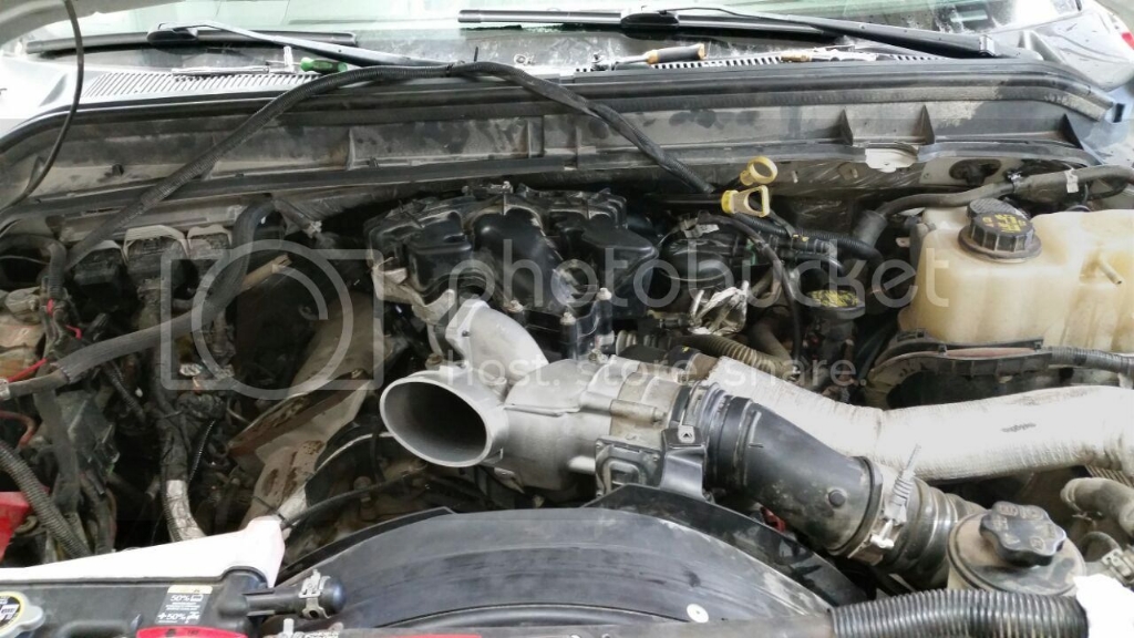

Does anyone know why this kit has an exhaust manifold looking thing? Do I need to swap a manifold? Also I'm 2.5 hours in and just pulled the turbo out.
bpan
Oct 11, 2014
243
I figured that out. Quite obvious once you see the egt sensor block off plate lol. Just about done. Anyone know what to do with the line that went to the waste gate
bpan
Oct 11, 2014
243

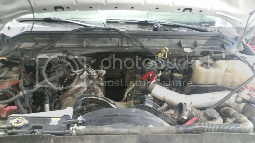

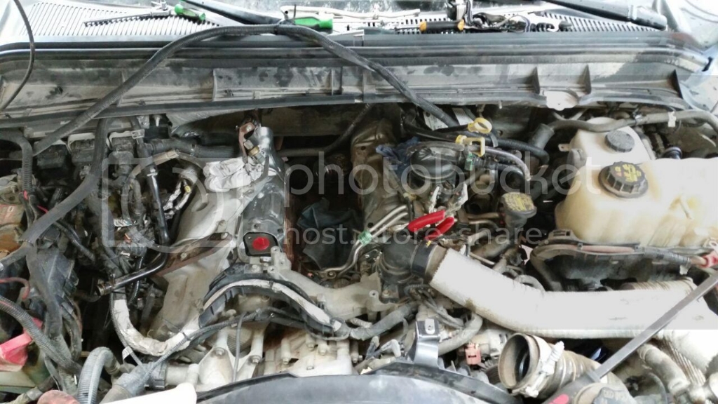

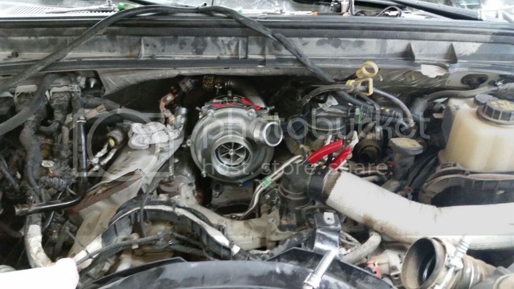

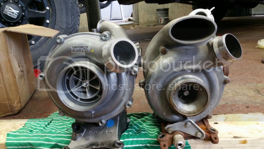

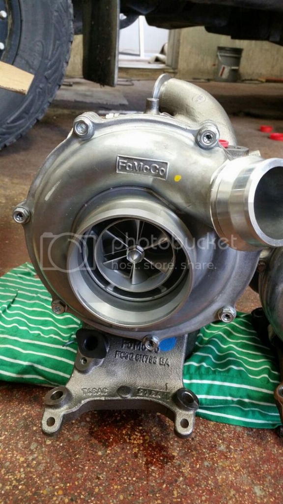

Recap of Today!
So a little recap, everything is put together. Took alost exactly 6 hours from start to finish. Slightly more intense than i had thought but not too bad. Taking the v band clamps off was easy. Putting them back on was harder IMO. Pics to follow.
bpan
Oct 11, 2014
243
Pictures From Start To Finish
Fun truck to drive, seems to take longer to light than I thought but once it lights WOW I love it and Im sure the more I drive it the more comfortable it will feel.
