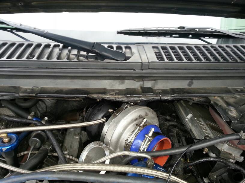

Little update:
Torque converter let go. Put a good amount of metal through the trans.
Trans is completely rebuilt. Waiting on a PI converter with 2400 stall.
Parts for dual hpop should be here this week.
Swapped the turbo out for s475

Little update:
Brand new DPC converter went? Sounds like your pump went, and then took out the converter
strokethis_06
May 2, 2012
519
Everything in trans was intact including the pump. Just had metal in it. Stator shaft was chewed up.
strokethis_06
May 2, 2012
519
I went with the dpc because of all the good things I have heard. But I dont like dropping a trans. And my trans builder just ate the cost of my trans. No hard feelings.
