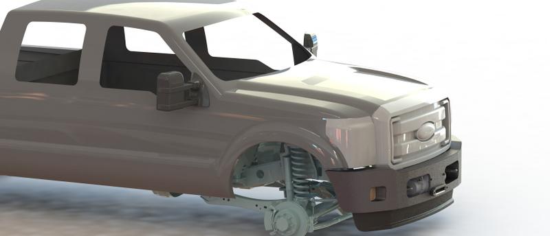

I've got to do some more learnin' with my rendering program, haven't used this feature in a few years and it's changed.
But this gives you the idea anyway of what some of the different options would be even if the rendering is kind of crappy.
A simple rendering of the winch bumper
No wings
No wings or hoop
Non-winch, no wings or hoop

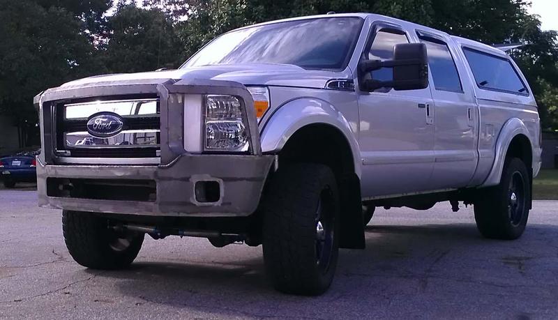

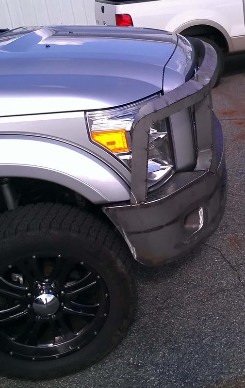

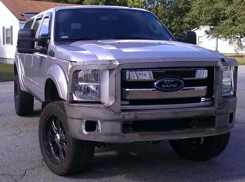

Made some progress on the project today. Hoop and wings are tacked up and we Mounted it!
I've decided to paint to match the truck. I think that'll look best.
Also, lower valance is not on, you'll have to use your imagination. Long as you are doing that, you might want to imagine the 2wd valance.
Thought you'd like to see the pics.
They'll finish welding tomorrow and get it off for paint.
I expect to have it finished and installed sometime next week.

Very sharp. I just thought of something though. To change head light bulbs you have to take the grille off the truck and to do that you have to tilt it forward to get the tabs loose pop the grille loose. It would be a major pain to take the bumper off the change head light bulbs.
Over all though it looks great, for some reason I don't care for the wings they don't look bad, but I don't think they look as good as the hoop does so maybe thats why I dont care for them. I like it better than anything else on the market though
WHY NOT
Jun 21, 2011
3,912
Carlyle IL
I guess that could be another way, but I am pretty sure the manual says to remove the grille. As long as there is someway to get to it. It would be really cool if you could make it tilt forward and use it like a step to work on/in the engine bay.
