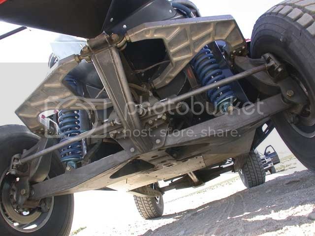

That's a beam set up. But its easier to get 20"+ travel out of vs a J arm set up.
Cantilever set ups are typically in the rear and look like this.
This is a j arm set up for reference.

What coilovers are you going with front and rear? Sticking with fox?
These are 2.5" fox front and Rear. Rears have 3.0 resivours. (No coils yet)
Bypasses are 3.5" 5 tubes front and rear. Rears have 4.0 resivours.
That's a pretty bad ass set up so there isn't any reason to change it. This is over 10k retail

Cantilever setups are badass. Pretty sure 1 of those Foxes is more than my entire suspension. I was always intrigued as a kid modding and setting up my old Traxxis Revo (I know its just a toy) but you could almost double the travel with the cantilever setup compared to the trucks with tradition shock mounts.
For the rear? Wouldn't the leafs still limit travel?
I know CARLI has the cantilever system for the dodges.

Most cantilever set ups on off road trucks are used with leafs to be able to get anot of travel with out cutting holes in the bed and building a bed cage. But I have seen some buggies and TTs with coil overs on a cantilever but it's not common.
Cutting-Edge Diesel
Feb 10, 2012
5,738
Newkirk, OK
well ford calls it twin I beam. its what 2wd superduties run as well as 2wd f150s up to 96. this no longer has the cast iron factory beams it has fabricated beams.
and with the correct cross over steering it will not be effected.
